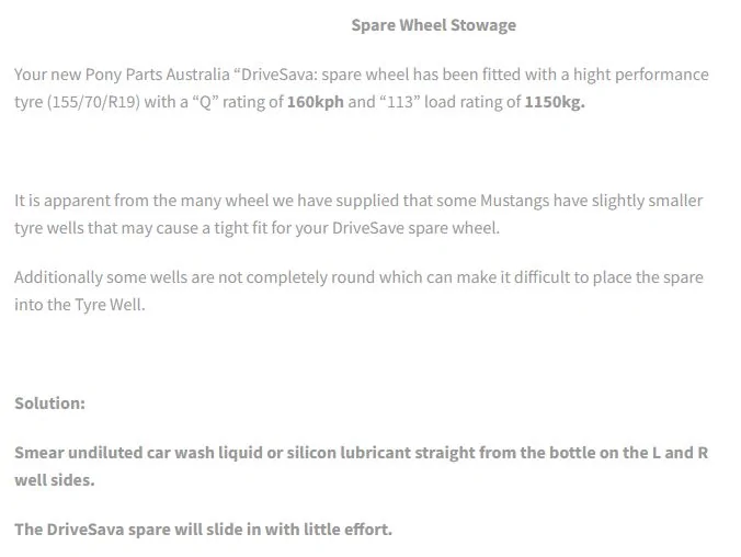

Being an extra 6mm in diameter, I'd be concerned the Pony Parts 155/60R20 spare fits in the wheel well.
Considering they warn the 19" spare may need some help.
That's fine, but what about getting the bastard out... after the liquid/lube has evaporated/dried out?
This is a valid concern. Something I've wondered about as well. And if it doesnt fit, will they take it back and refund?

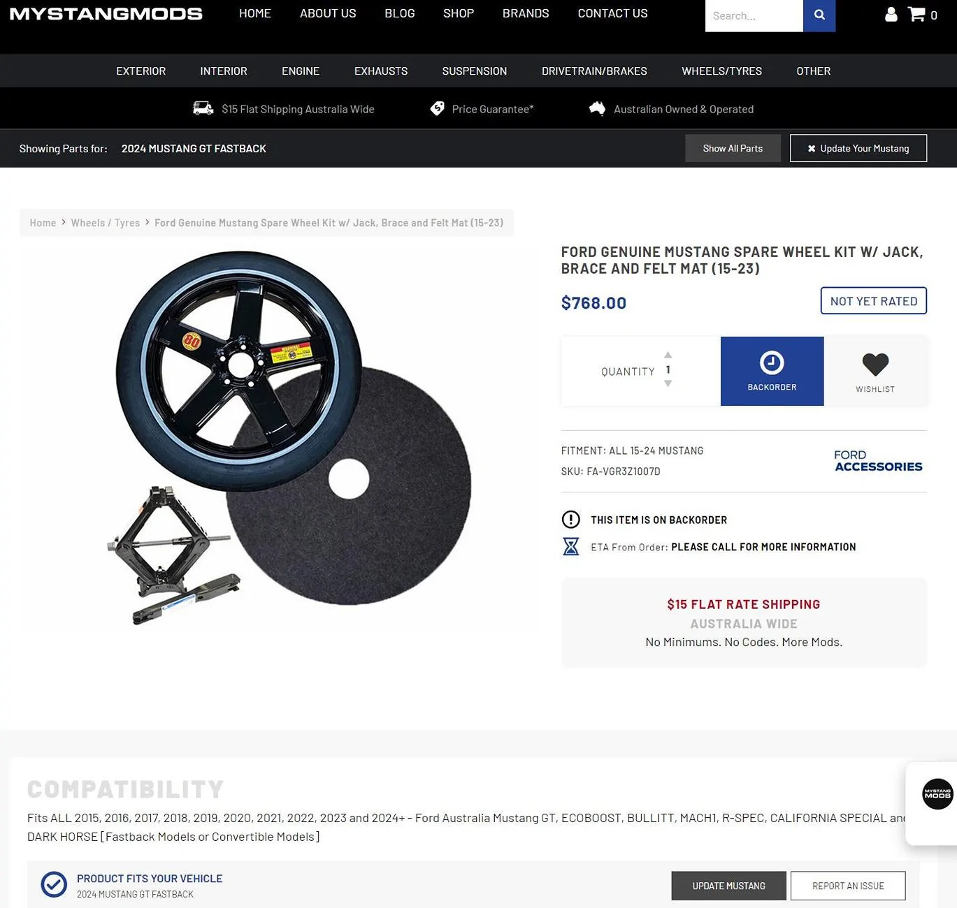

The 135/70R19 is what the majority of others appear to be selling.
MyStangMods, Mustang Motorsport & Herrod.
I am not sure if this this will clear the larger brakes on a S650..?
Even if it does, I prefer the DriveSava option as its a closer match to the rolling diameter of the factory wheels.
I did notice the DriveSava states it may be a tight fit, however I figured their 20" is actually 6mm smaller in diameter than their 19" option, so I'm hopeful that will make a (very) slight difference to fitting it in the wheel well.
Also, I figured no need to pump the spare to max psi, so could let a slight amount of air out if it needs a couple more mm to fit in & out.
Being that the 20" is the only one I have confirmation on clearing the calipers & that its is the closest rolling diameter to the factory wheels, I feel this is the best solution.
I did ask Alan at Pony Parts if I can return it if it doesn't fit and he said that's not a problem, but he doesn't see there being an issue.
