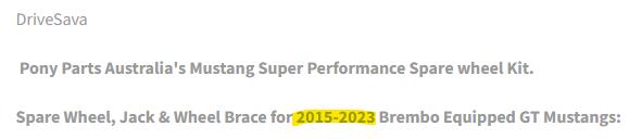

I went with the 20" - although the PonyParts flyer for the 19" DriveSava states it is compatible with all Brembo fitted Mustangs, the website seems to contradict that:
S650 Mustang Spare Tyre solutions 1731970767377-1s
not sure if it just an old script, but I went with the 20" just to be sure.

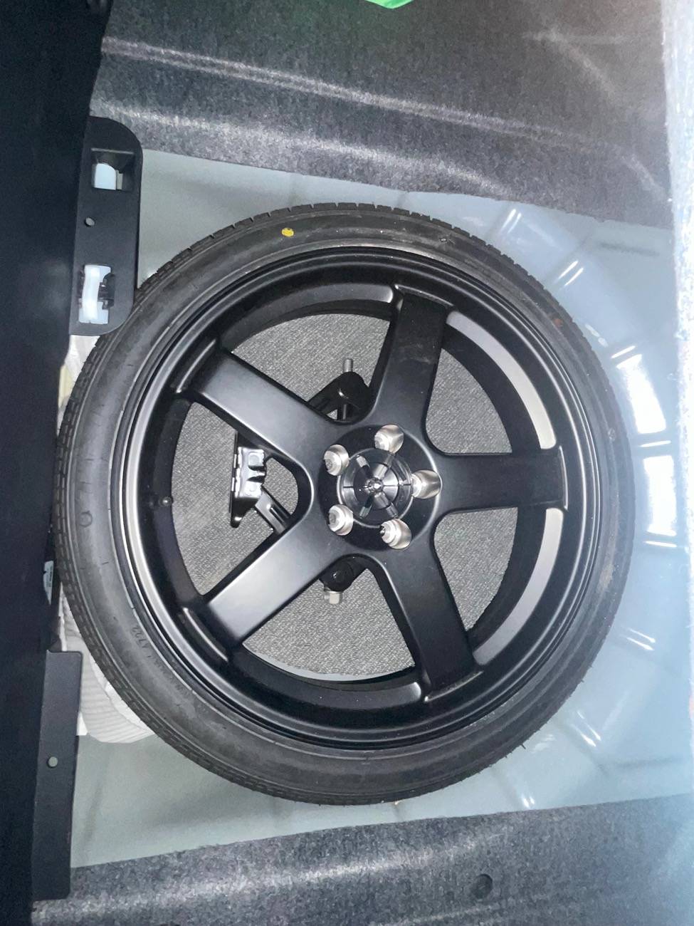

@5.0ALM can you advise if you've fitted your 20" spare tyre into your boot and tell us whether it works.
One of these is on my to do list but don't want to pull the trigger until I def know it'll fit.
+1 on that one. I really want to get one but need one that will fit without any hack work. I'm not lubing up a tyre to make it fit. It should look and fit like OEM.
Its not as flash as 50ALM’s videos, but here is my 20” spare sitting in the boot well - no lube required. :like:
This.
I started shooting for a video on this weeks ago, but got distracted onto another project.
Despite being ~$100 more expensive, I think the 20" is a no-brainer.
It's a closer match to the rolling diameter of the OEM wheels, and as VB's photo shows, having a slightly smaller diameter means it fits into the wheel well with no trouble.
I haven't had the chance to jack up the car and do a test fit.
Was waiting on some rubber pads for my jacks.
Don't want to be marking the SVE jack pads (if I use the trolley jack at home) or the pinch welds (if I'm by the side of the road and using the supplied scissor jack). :facepalm:
