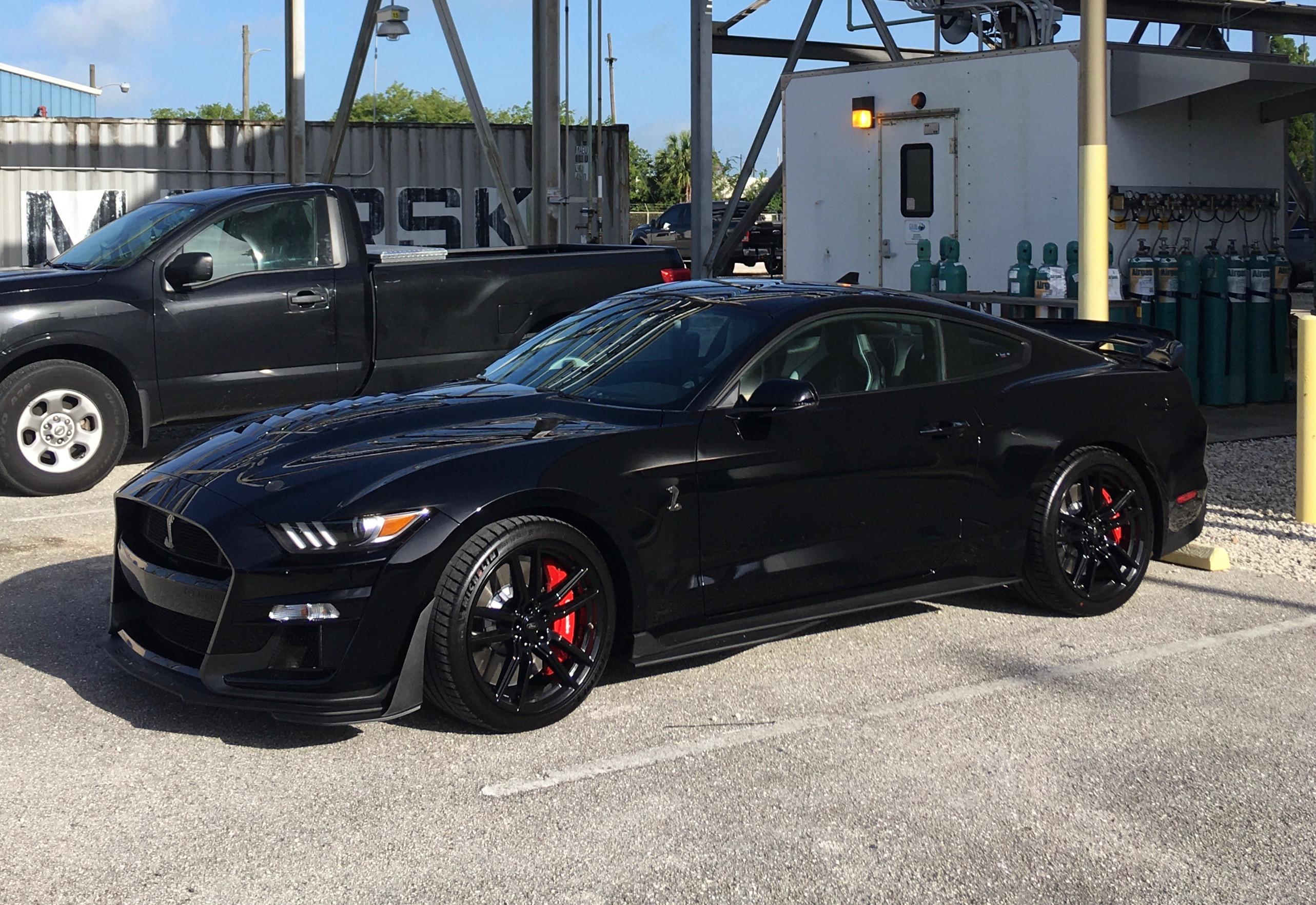

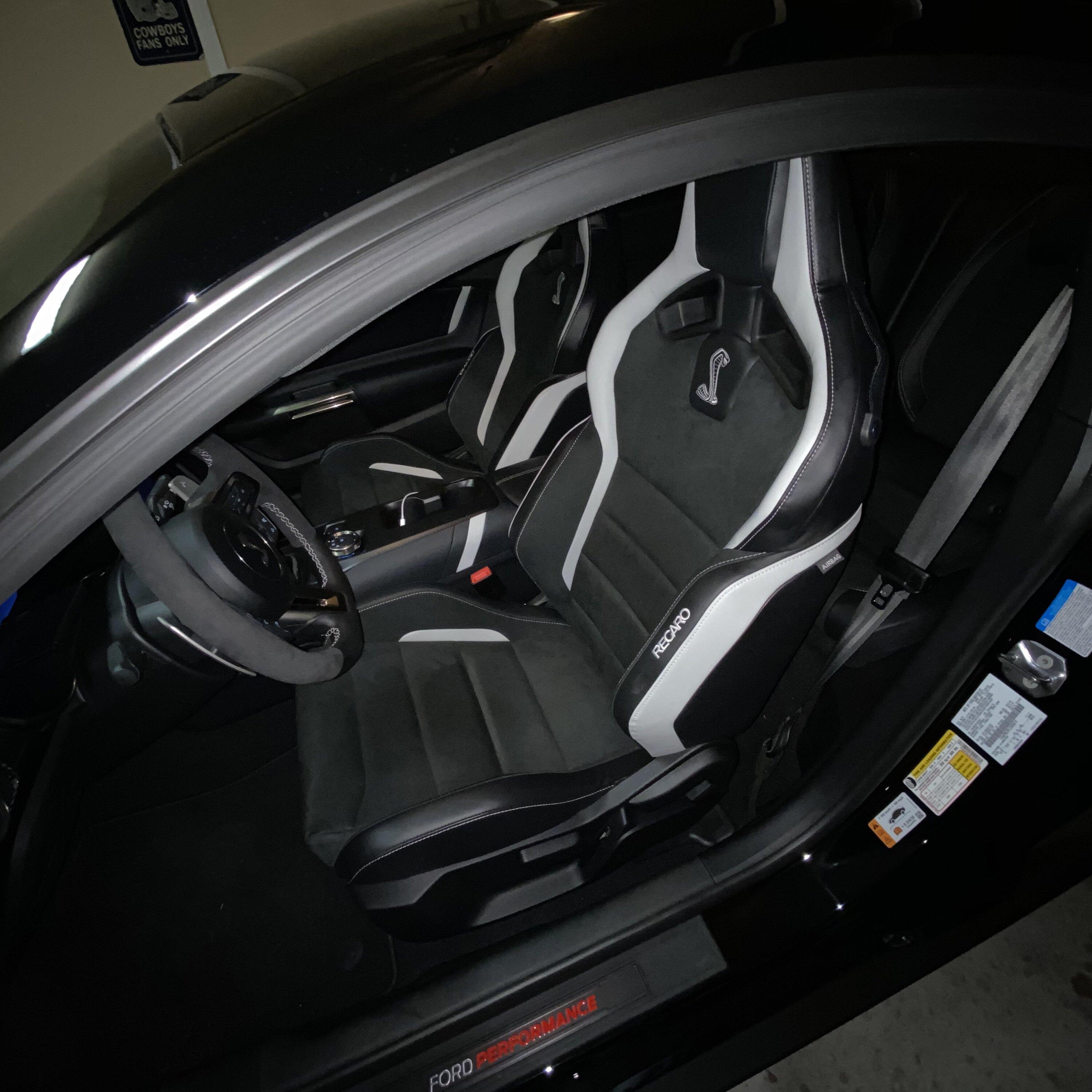

When I ordered my 2020 Shelby Ford originally stated you could order heated / cooled Recaro's. Pictures sure looked like heated and cooled Recaro's in all the pre-production pics. That was the only reason I wanted the Recaro's over the standard seats was if they were heated and cooled......guess what, not heated or cooled. I bought the car anyways. The OVERALL car was so good it didn't matter

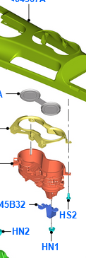

I'm hoping the wiring harness is there for the cup holders and it is just a matter of dropping in a cup holder that can plug in.
sadly, there are no MyColor wires that run to the center console. however, the wiring for MyColor is pretty simple; 4 wires, ground, red, green, and blue; wires colored black/brown, black/orange, black/green, and black/blue respectively. you're also able to order what is basically the MyColor LED with wiring and connector. it's part number FR3Z-14A411-Z and costs about $26. you also can't put the 2015-2023 cupholders in, as the construction and mounting is different
2015-2023:
S650 Mustang Ambient light is better on the S550 1693451646732
2024+:
S650 Mustang Ambient light is better on the S550 1693451676689

So it means it's not that easy to retrofit this in the S650 :(

RIP my hopes and dreams. Thanks for looking into it! Maybe the aftermarket will come up with something one day.
