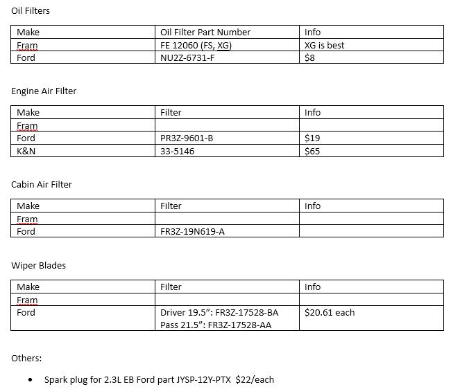

I'm looking for anyone who has an aftermarket parts list for filters for the cabin, engine, and oil.
I'm not a fan of K&N (oiled gauze) based upon two motorcycle installations (meticulous cleaning/oiling with poor results...more later).
Here's what I've started:
S650 Mustang Aftermarket Filter Part Numbers for S650 Ecoboost 2.3L 1735934165331-py

Oil...
Motorcraft - FL2127
AC-Delco - PF64, PF64P6, UPF64R
Mobil1 - M1-114A
Really? PF64 was the OEM oil filter for my 2021 Camaro LT1 (V8). I returned an extra I had after I sold that car. And returned extra 5W-30, which it turns out is the oil for the 2024 Ecoboost as well. Shoulda just kept everything lol

You can use the 500s motorcraft filter from the coyote filter on the new ecoboost engine. A little bigger filter body size, but threads line right up. USed 2 of them so far no problems.
