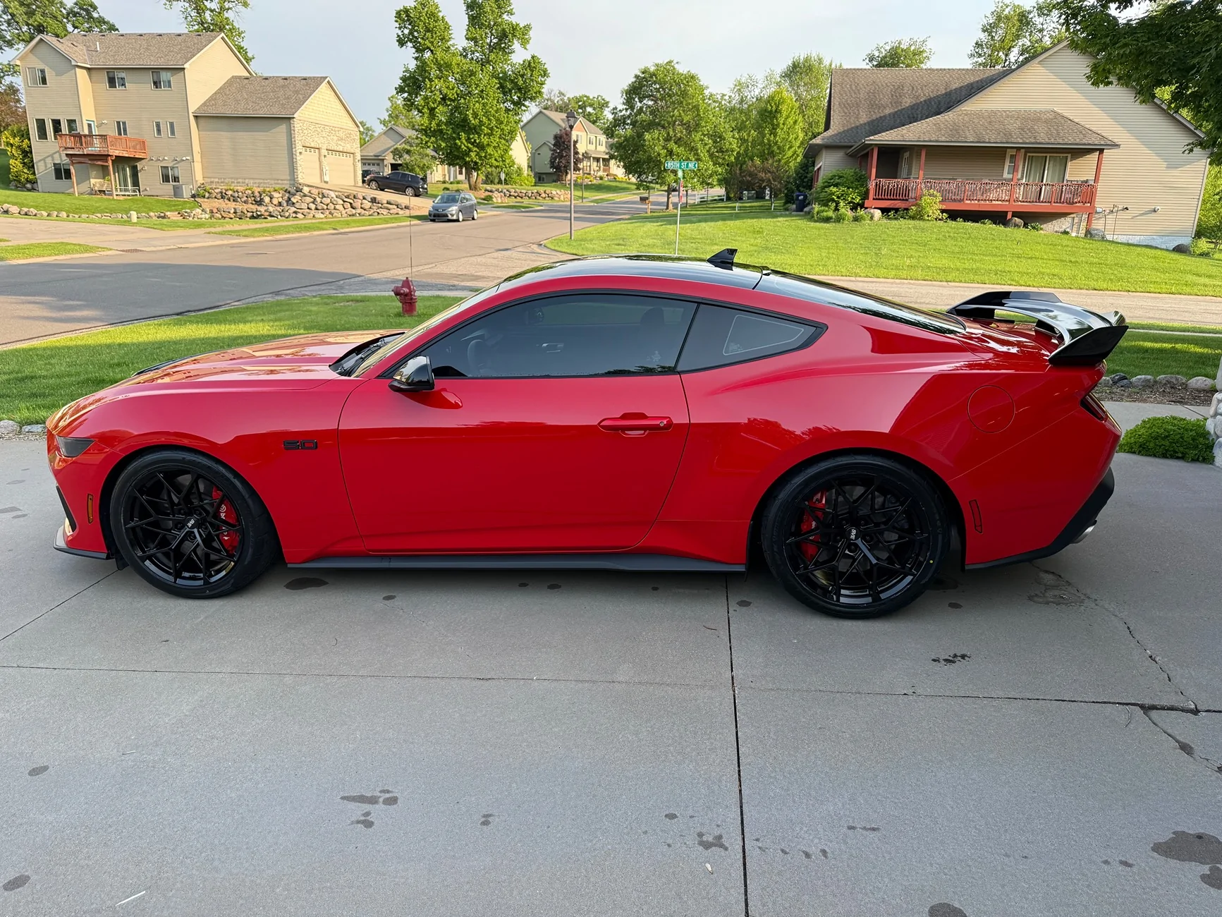

S650 Mustang GT, Audi Q5, 1993 Mustang
I did Eibach lowering spring set on my non-PP GT Premium and really loved the result! The lowered stance is perfect (see photo of mine) and the ride quality was not affected at all. I don't do any real performance driving that pushes the handling, so can't comment on impacts on that front, but can't believe it isn't improved by the lower stance. Very worthwhile add-on for about $800 total. Anyway, just my two cents!

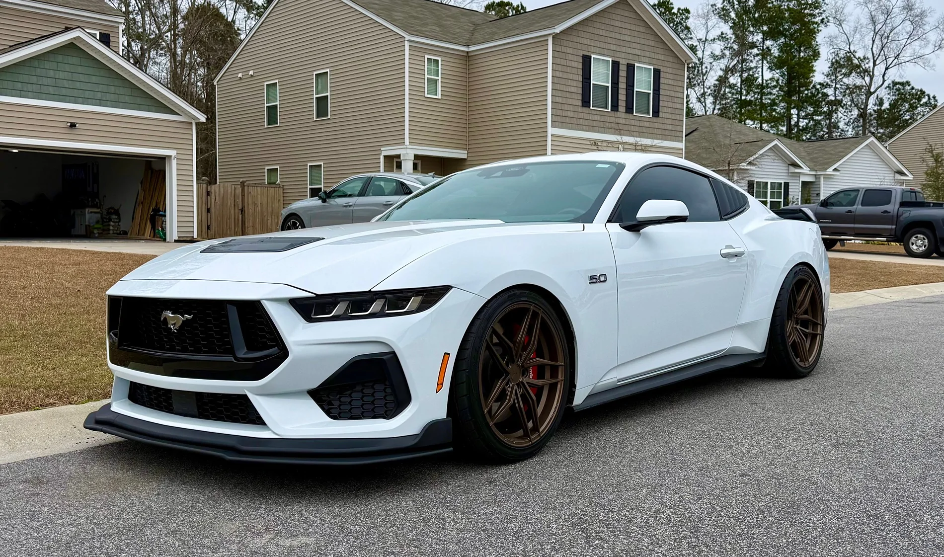

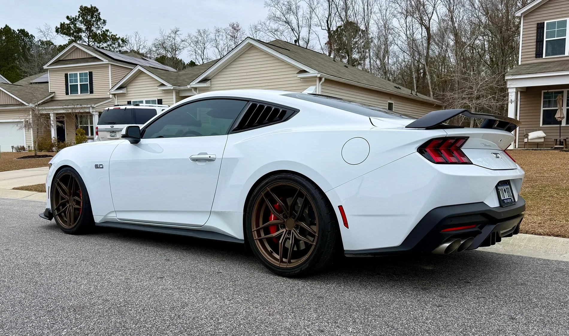

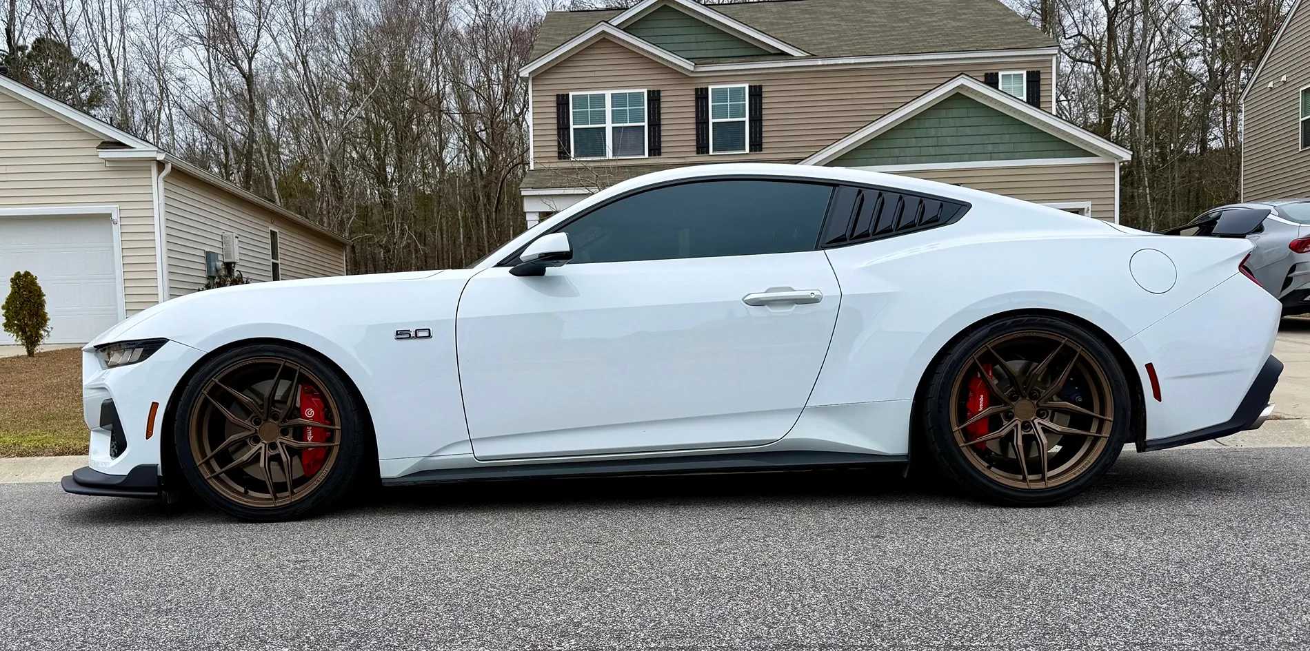

2025 Mustang GT Premium
Literally just had my car lowered yesterday on Eibach sportiness, the car is a 2025 GT Premium, put the 20” Ferrada wheels on 3 days ago aswel, was very conscious of the offset and front tyre size…
But no rubbing, clears the brakes and it was 100% needed..!
