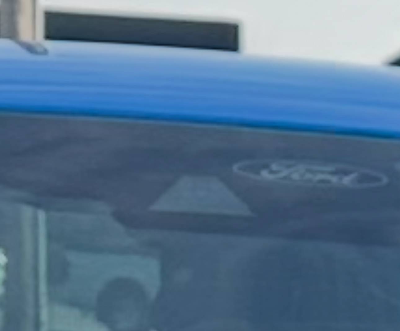

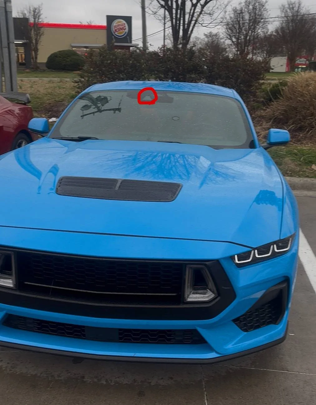

Mustangs that have Adaptive Cruise Control ACC have this camera, I don't know about base trims, probably not. But it should be behind your rear view mirror.
We might have the front camera. At least I know I have something behind my mirror on my 301A I’ll include a photo. It might be a sensor so please correct me if I’m wrong.

That would be good news if it has it. From far it looks like the window at least has a specific shape around where the camera should be behind. This is to help the camera recognize the signs better in difficult weather conditions. You have to look closer behind the windshield to see if it is there.

From another photo I have I’m almost 100% positive there’s a camera there. I’m pretty sure I’ve even seen it in person. I just don’t have my car currently to check so I’m stuck with photos for a day or so. But for now I’m saying yes there’s a camera there.

If so, we can try and make it work step by step.
Just make sure to have all your as-built data saved before doing any changes.

Assuming all of us with the 301 group non premium have the camera and hardware needed and I can confirm I can see the same on my windshield than sky5oh sees, what are the ForScan codes we must changed? Because I already tried adding everything I saw related to Traffic Signs and even when I could see it on the menu, I couldn't even enter to it and obviously didn't work.

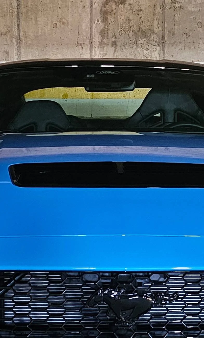

Here you can see my camera
I just took this picture and I don't know, this may be a camera, I'm trying to compare it with this picture of yours but they look different, just don't know if it's just the photo's perspective and focus.
Anyways, I will try to check again all the code I changed a couple of weeks ago via ForScan to see what it does now, but I'm pretty sure I turned on everything I saw related to Traffic sign I don't think there's something about speed limits.
