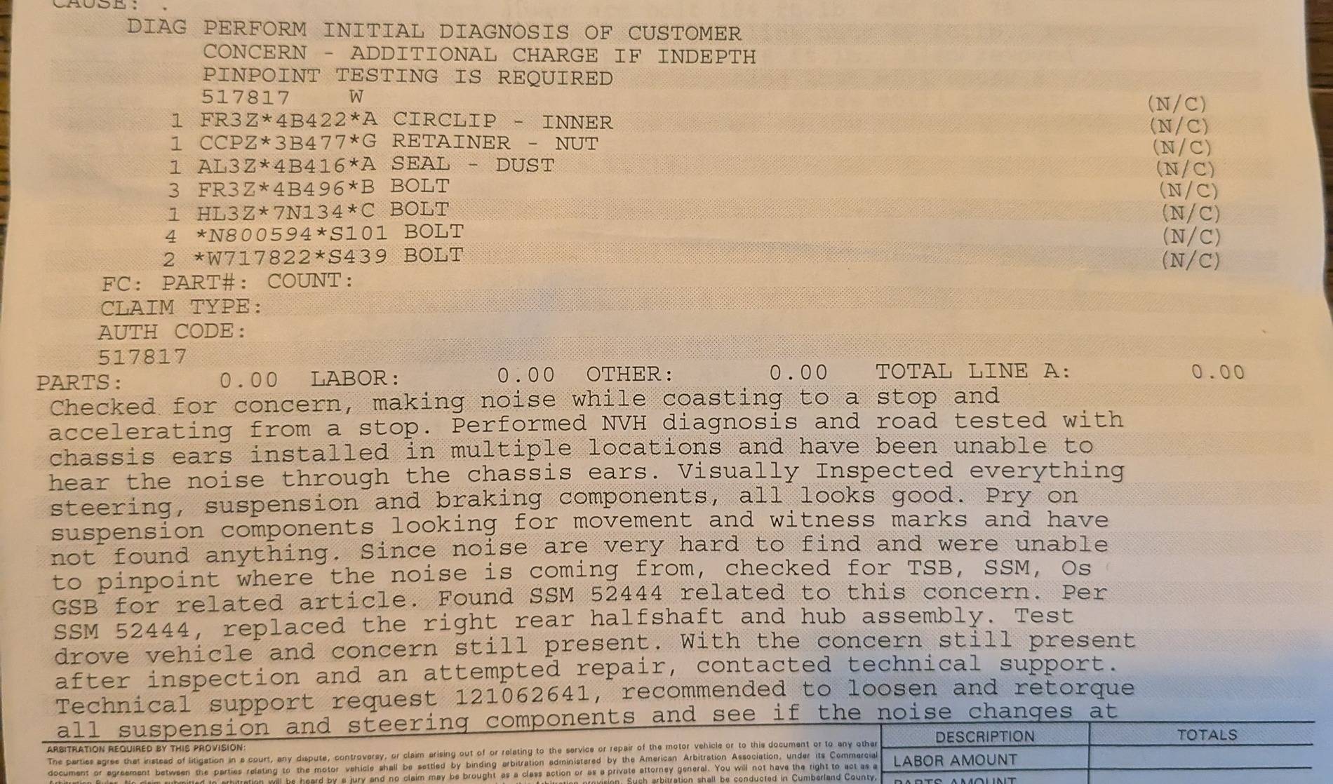

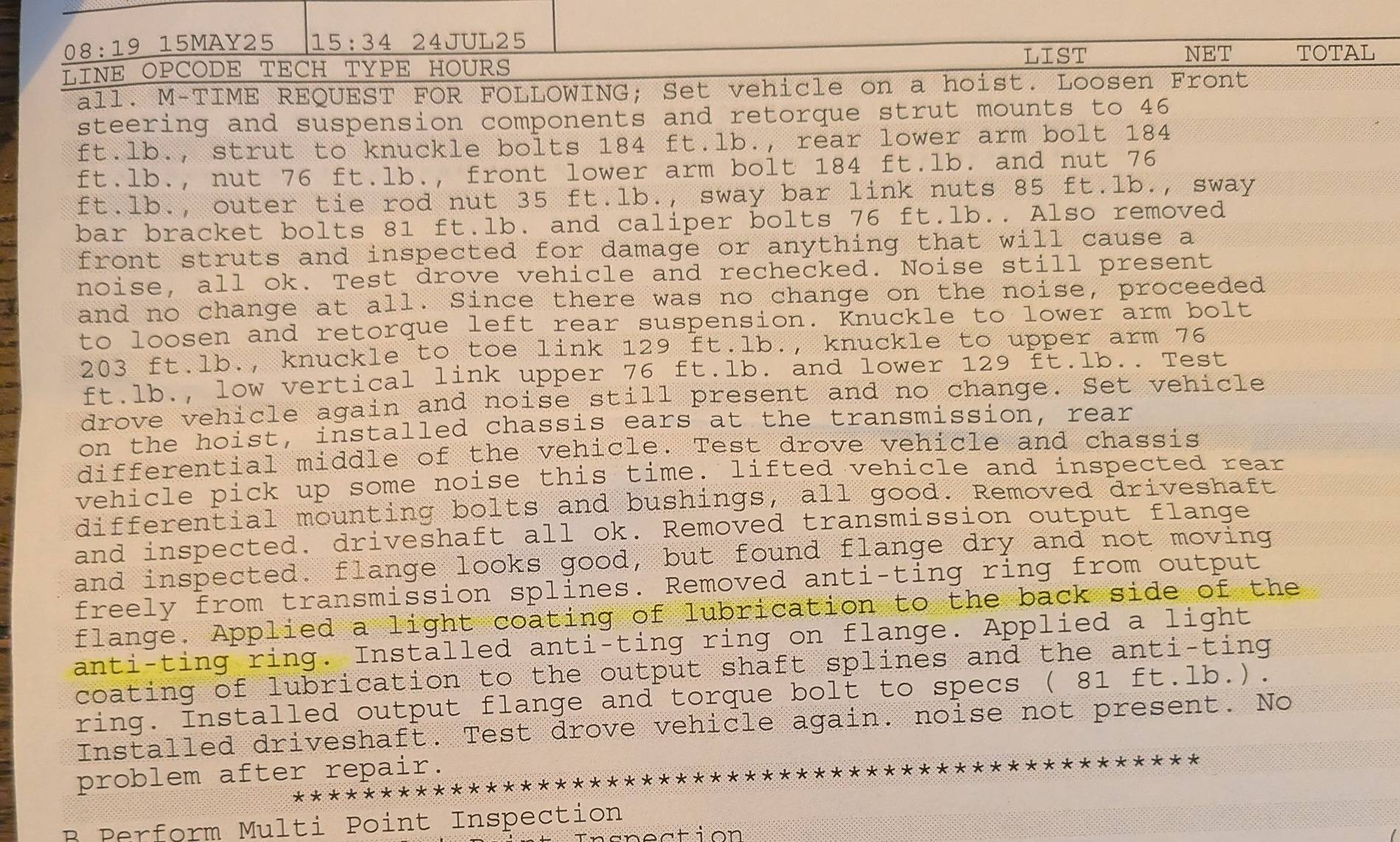

For 3 months they went through all the repairs they thought would fix it. They actually found it when Ford had them take apart the drivetrain and notice it was not lubricated. There's four of them elsewhere. I think this how your mechanic looking them and yes we thought it was coming from the rear but it was the drivetrain so that can be tricky. You're sitting right there

The space between the drivetrain and trans ...wiggle room needs a lubricant and ring to keep them from knocking and if dry it knocks ... correct me if I am wrong 😂💯

I hope this helps, this should help with the suspension noise issue that no one seemed to have fixed. Liberty Ford, North Carolina fixed mine.
May I know your car's production date? I had the same issue last year and my DarkHorse was fixed by my dealer. They replaced a new output flange and lubricated it. And there are others around the world who seem to have the same issue. I'm just curious if our production dates are close...

The parts on our cars are 2023 so yes we all have the same issue if we got that 2024 ...it's not too bad was just hard to find
