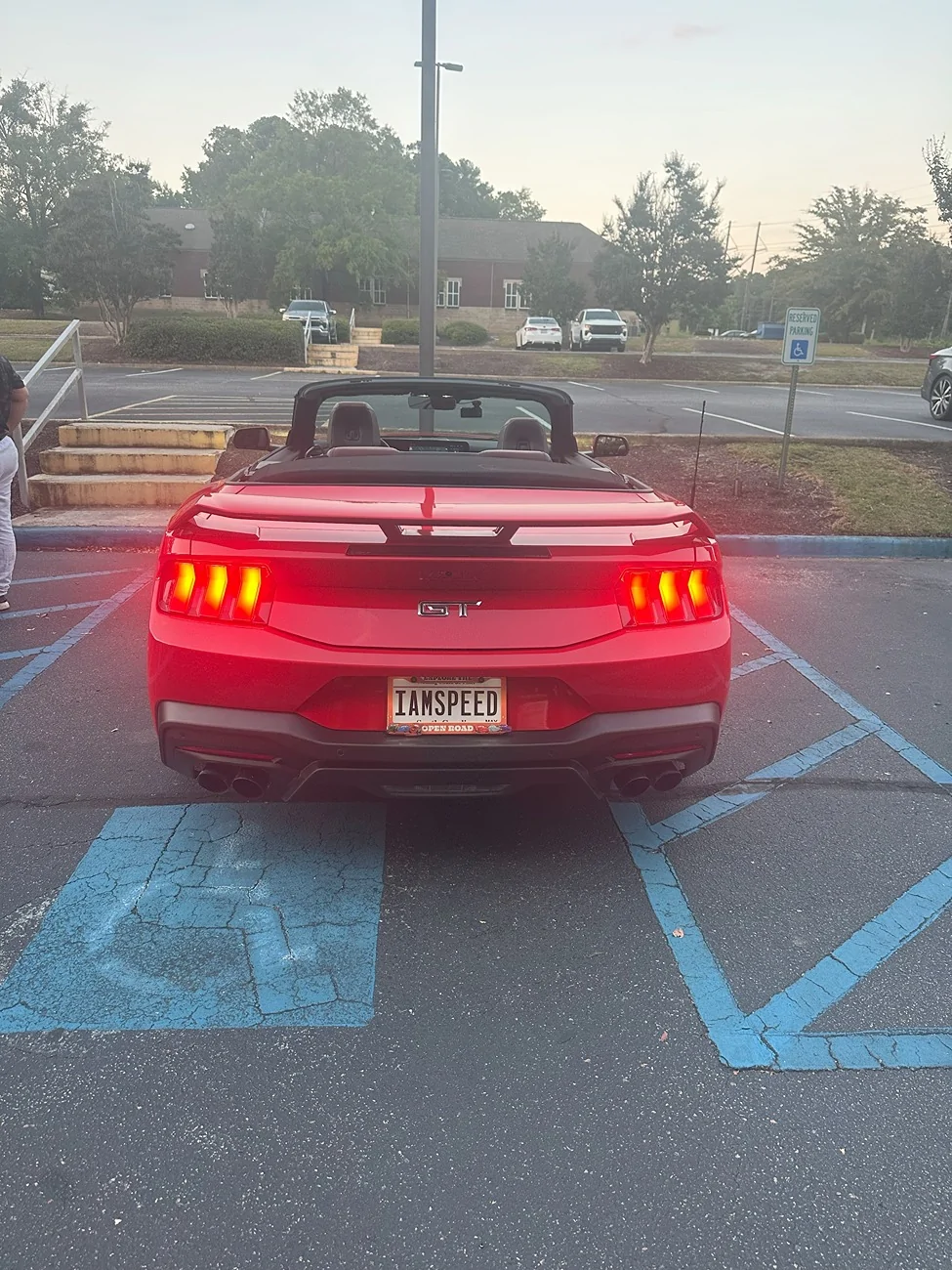

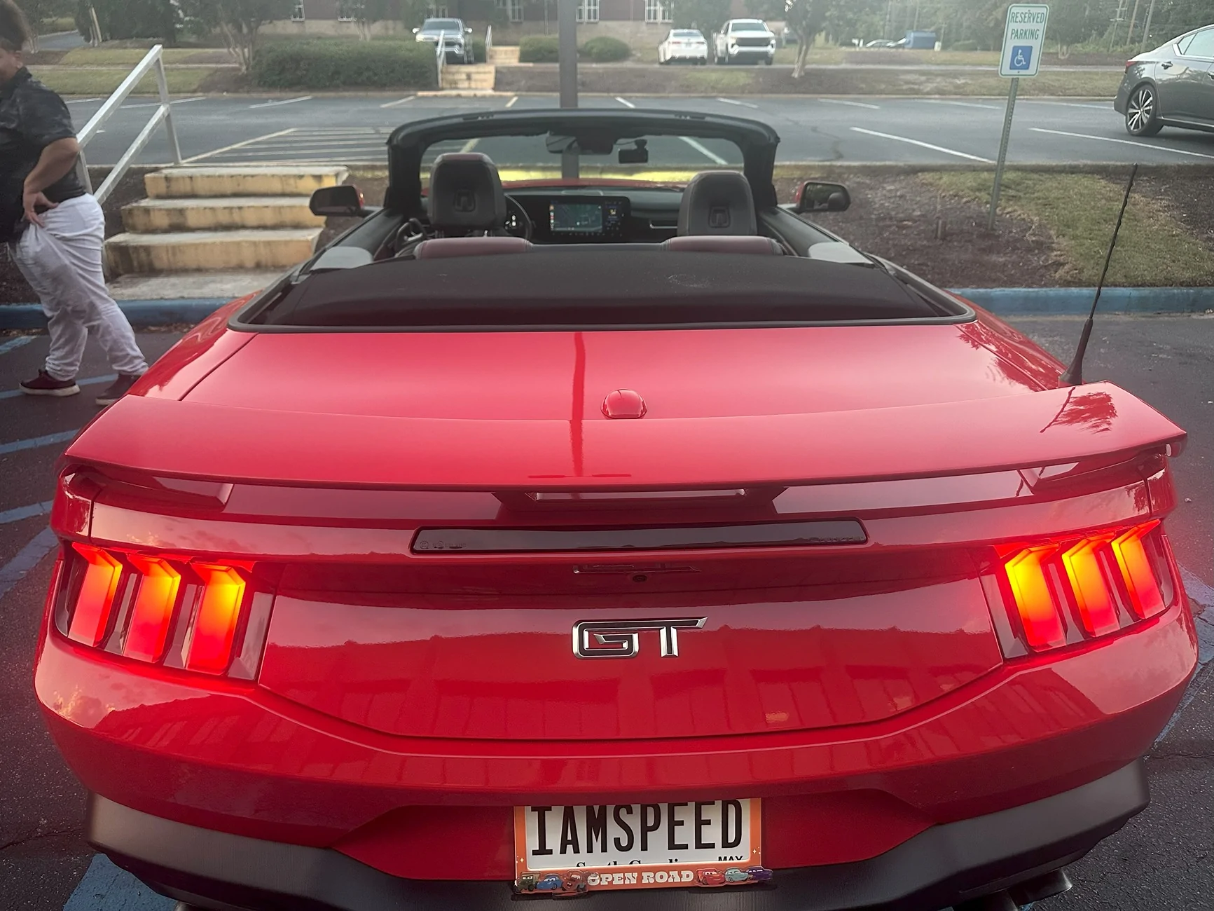

mounted easily with no issues to brake light or really anything. Does touch the radio antenna when opening trunk

Whole post is why as soon as you choose convertible Ford deletes spoiler even with Performance Package. Clearly it fits and does not cause any issues with 3rd light.

Did you replace the slug or detach and apply? As in, isn’t the rear section of the truck lid (the slug) different on the convertible and the coupe? It was initially assumed the removable slug was intended to make the spoiler swap as easy as a bolt on but with the integrated third brake light it more or less became a separate and fasten instead of a drop in place solution.

We took the "slug" that came with the spoiler and used it as a template for where to drill the 7 holes,
2 x 1 3/4, bolt goes through trunk, and slug M6 with large washer
3 x 1/2, for the pin on either side and center
2 x 1/2 for the 2 plastic pin clips
here is the crazy thing
The 3rd brake like actual had a cut out where those center clips and pin go.....I was like what the heck.
probably did not even need to take the slug off at all, except the hole saw center bit probably would have hit the trunk underside.
