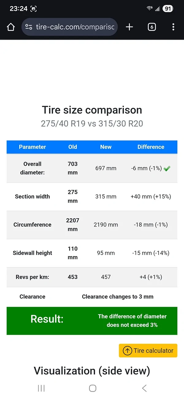

Would I need to retune my whipple if I get new tire sizes? I'm looking at swapping tires to a larger tire than my base 275. The only real options I see are to upgrade to 20-inch rims from my 19-inch rims.
Current setup 275/40/R19 (which I would like to keep for winter use)
Summer set up? 315/30/R20. From what I see, the change in actual diameter is very small, leading to the question, would I need to retune the whipple with the flare tool?

The diameter is less then 1% off, so hopefullly it shouldnt? What percent off are yours?
I appreciate the warning.
The problem with stock size wheels is I cant get to 315 size on 19's and keep the same diameter as they dont really make 315/40(or35)/ R19
I calculated it in past. Don’t remember exactly but it was outside 3%. Put stock 19s back on. Had it recalibrated. Then put smaller fronts on that are within 3% & problem recurred.

Yeah, cruise control is a must for me to. I think the computer mainly uses rear size for speed and adustments. I could be wrong (just something i read before trying to plan my journey), sorry changing front probably didnt do so much (edit, just read your height post guess its a combo for the adaptive cruise).
What I read is the total diameter matters more then width (although width will make small changes changes in diameter.)
I found your old post, and yours were 7% off? As you started on a low tread wall at 30/R19. My main goal is just to get wider tires to put down power better. I started at 40/R19. So going to a 20 is the only way I can use michillen and keep my same diameter; is to go to 20s. If I got the 19s on michillen 30/R19 my diameter would be to small.
Mine should be close diameter for both rear and front to original within 1%.
