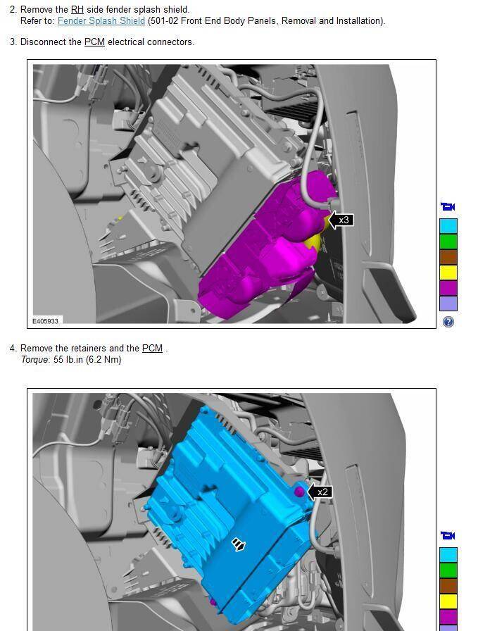

Its not under hood anymore that I can see. Where did Ford move the PCM to on the S650 mustang?????

In front of the right fender/ wheel splash shield.
S650 Mustang Where oh where has the PCM been moved to?? 1749139070899-yu

Sonofabitch. Thanks ford.

That's why the right side vent is closed off even in the performance pkg and dark horse
