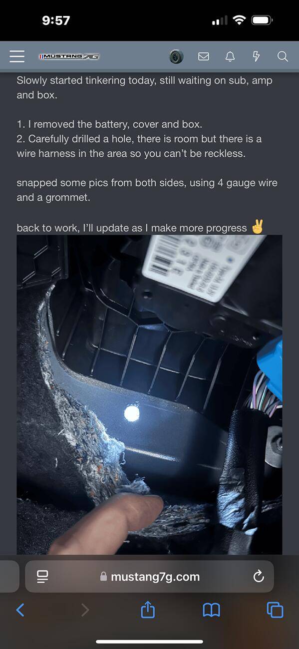

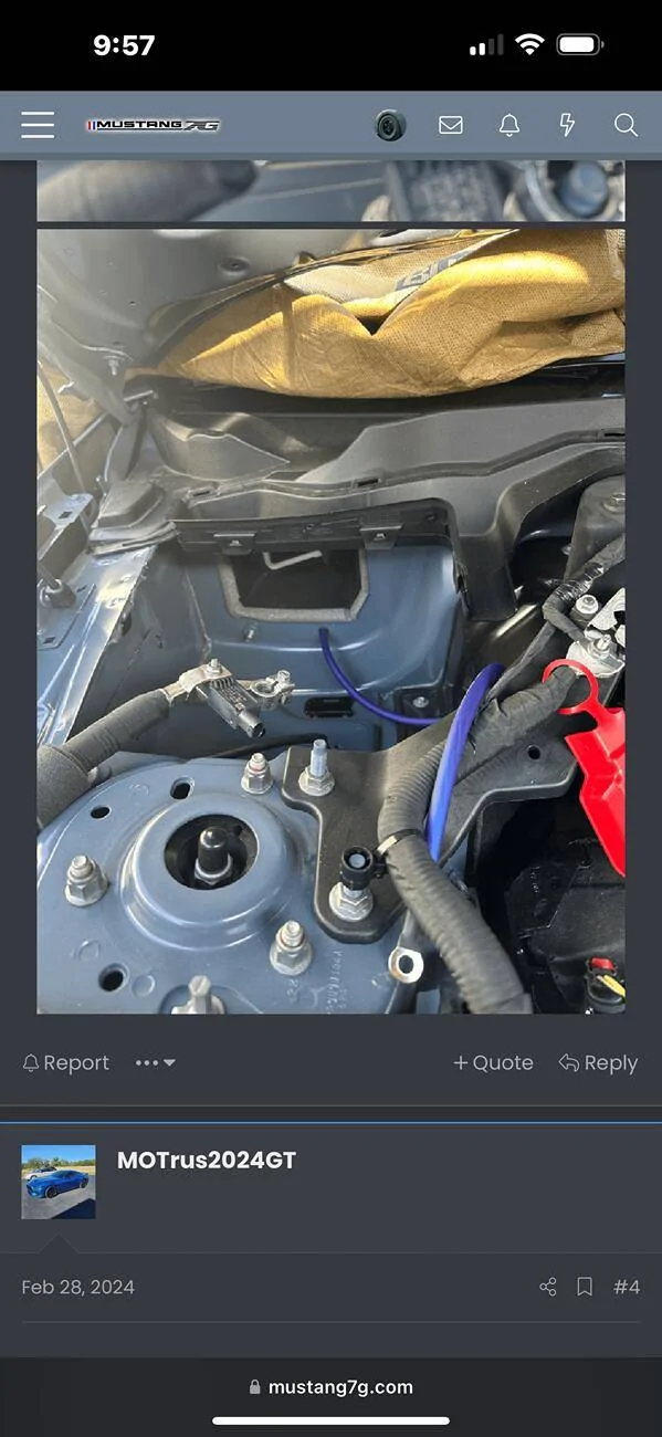

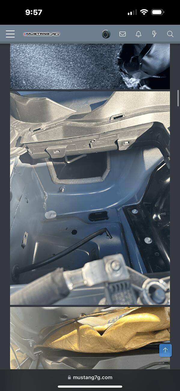

I drilled there are pics in my thread “base budget bass”
Thanks for the pictures man, I'm going to check your thread. Oh my, these turn signals are going to give me a bigger headache as I have to drill now 🤣

Maybe there is a different way, I just copied what the S550 owners did for installs
