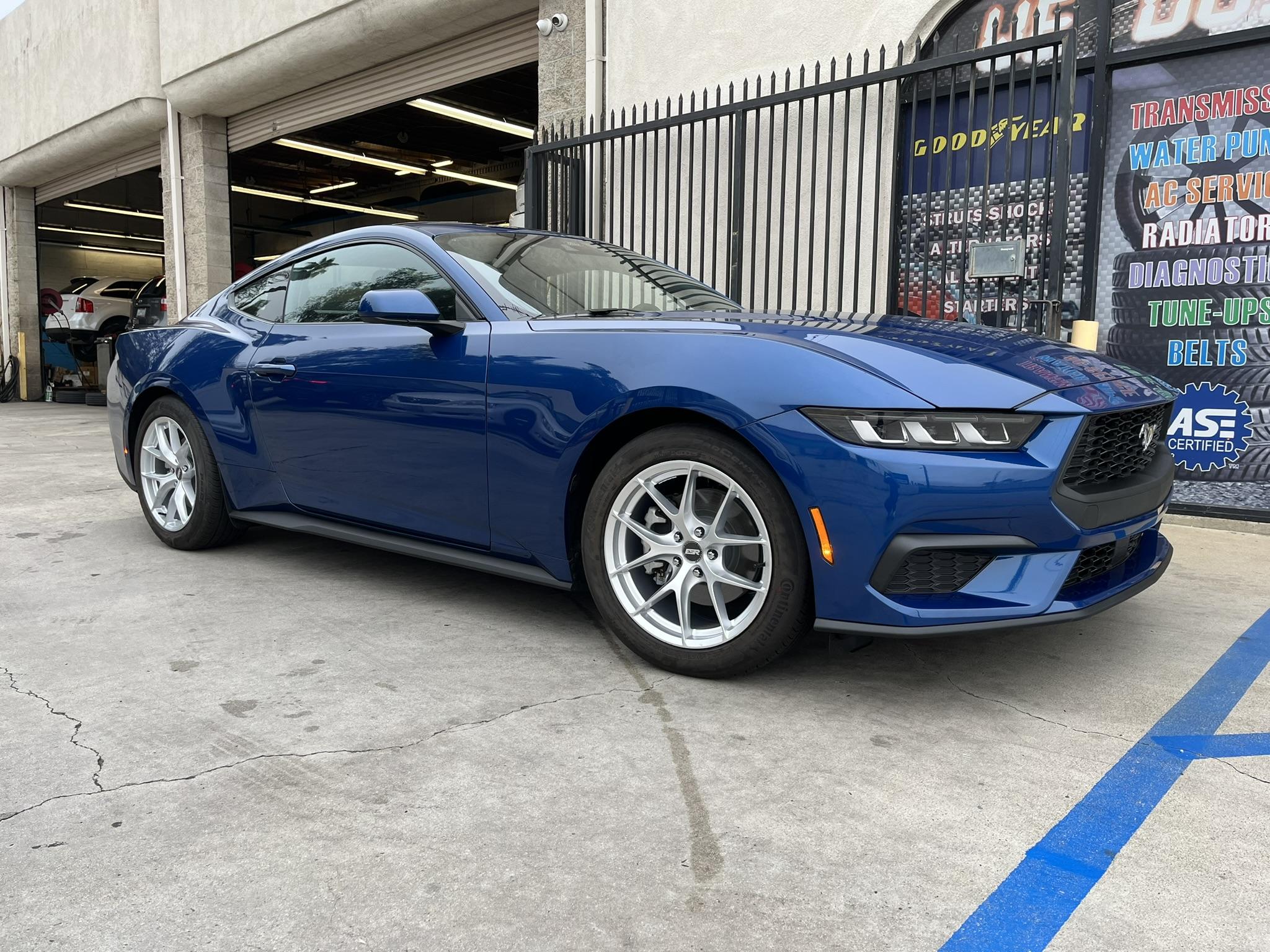

Update. Our cars do use the conical shaped lug nuts but I still had to purchase new ones with a smaller head diameter. Per online info and the tire shop, hub rings were needed to prevent vibration and they told me where to buy them.
Here's my Mustang with her new wheels. ESR RF2's 18x8.5 +30 offset.
