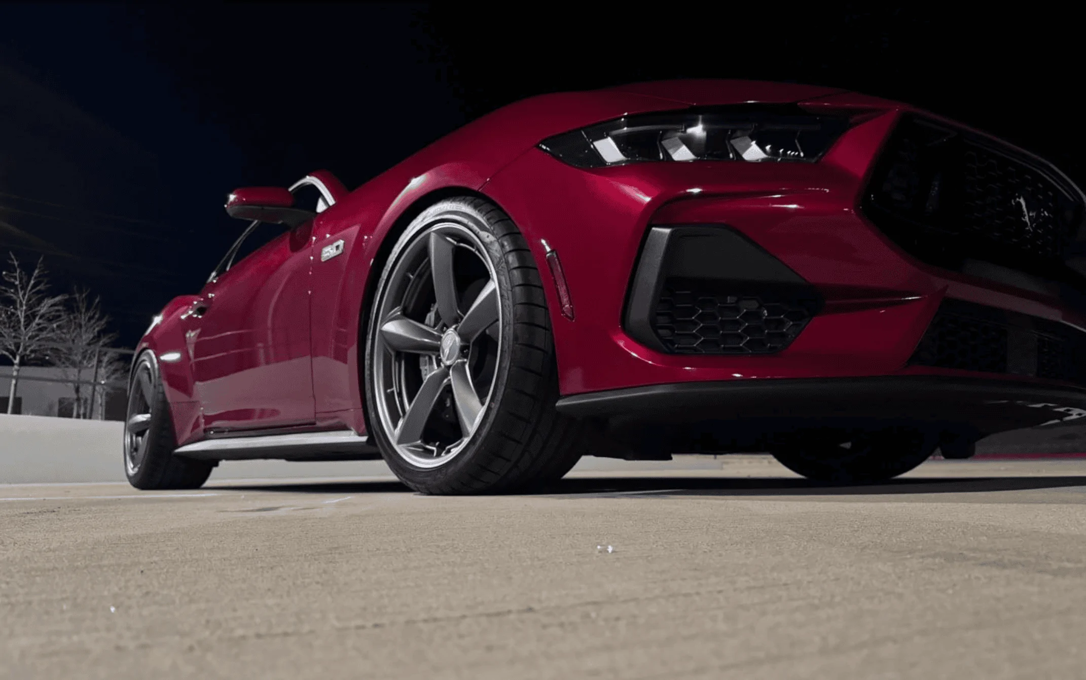

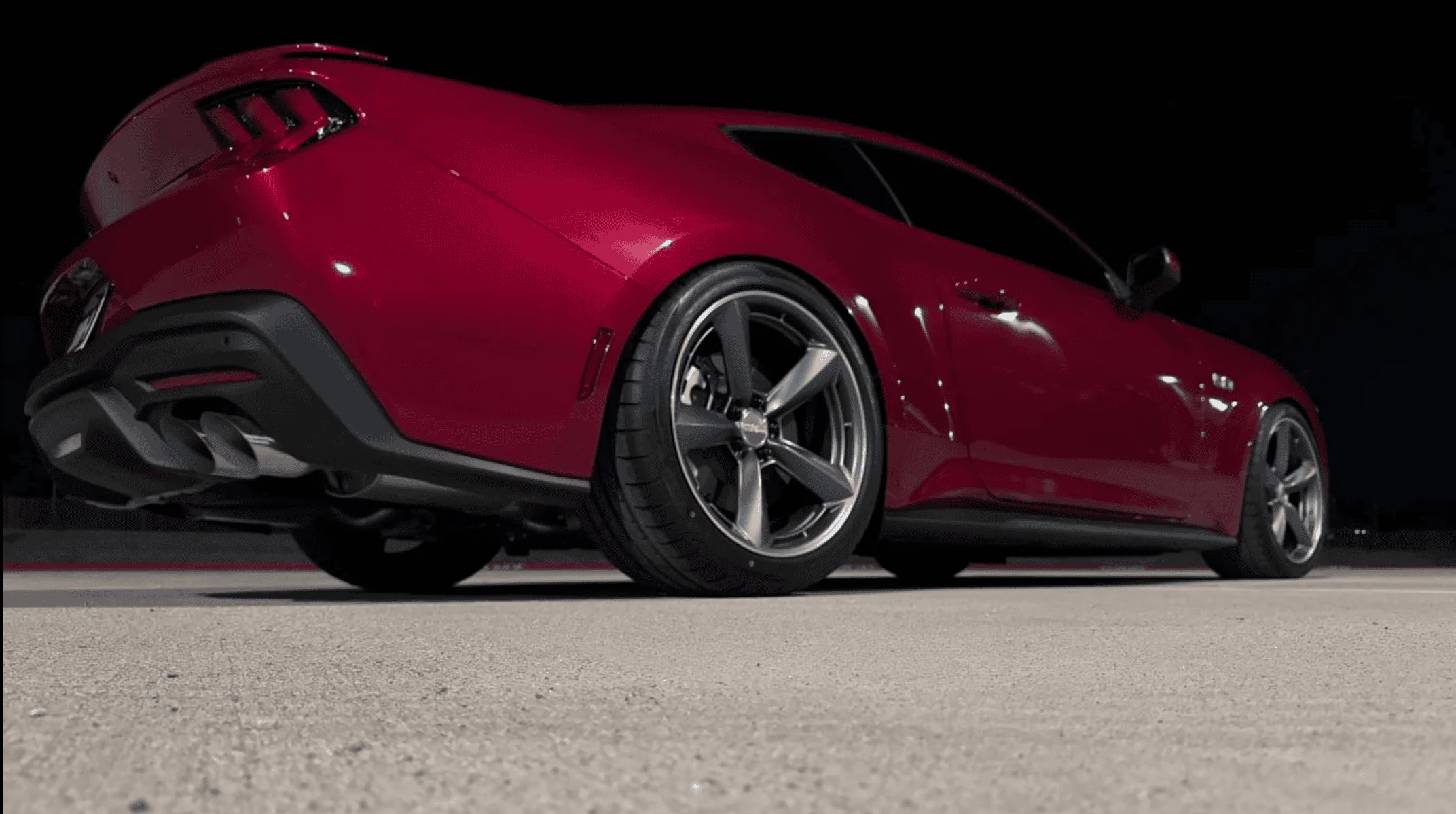

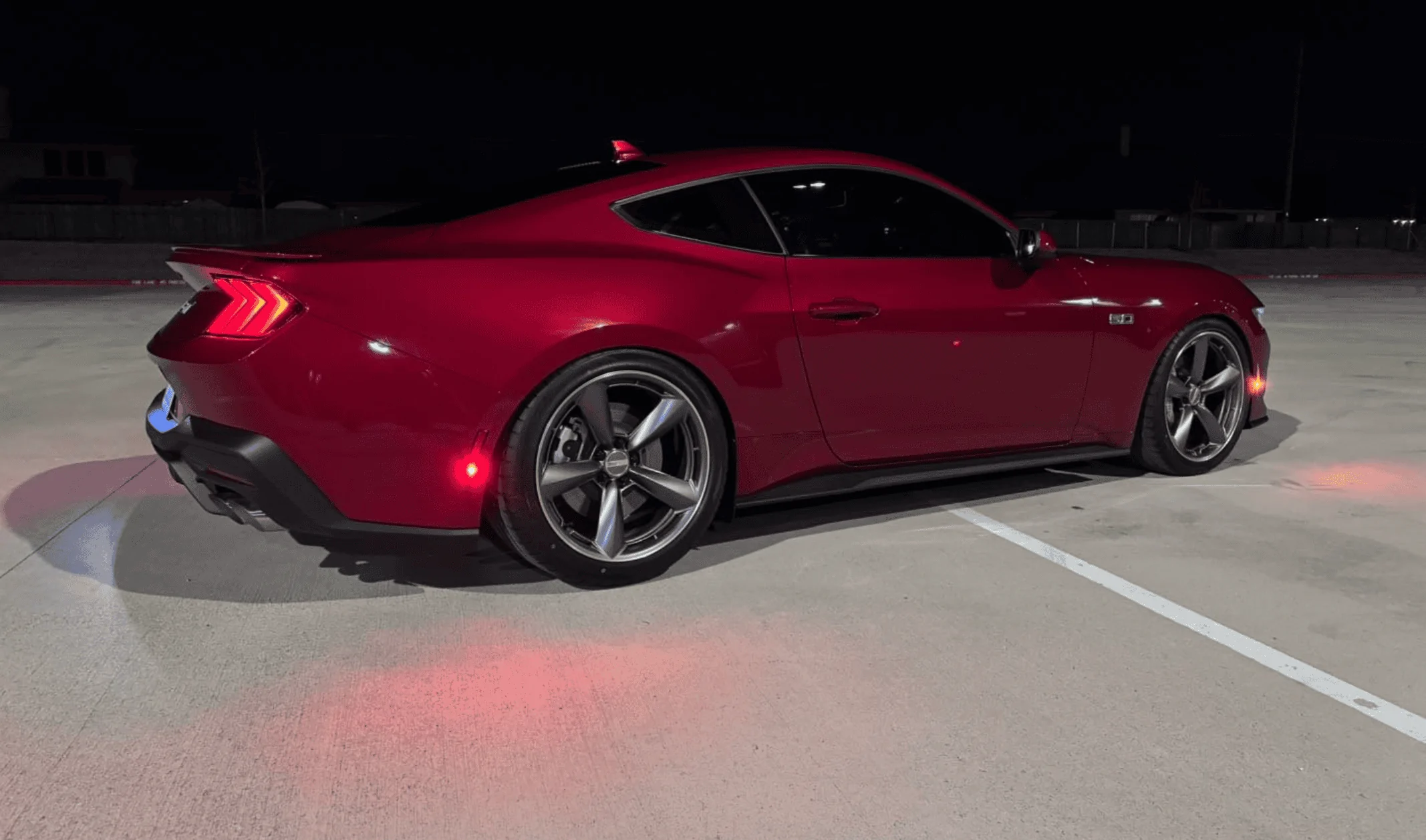

So I was able to take my car to a Ford dealer, and they got it back in spec. Took them a LONG time, but it's done. I didn't pay anything, because I have SO many points on my Ford Pass which was great. Anyway, the car rides GREAT...and is sitting just right. No fender gap at all, wheels are right there.
