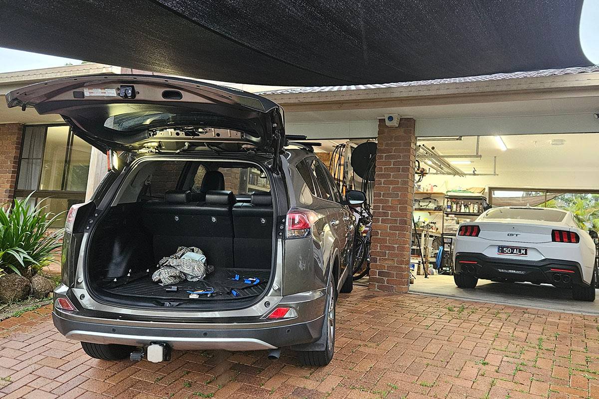

Dash Cam System #2 Install
It's the RAV4's turn to get the same Viofo A329 2-Channel dash cam system.
I have a new appreciation of how easy the Mustang install was now.

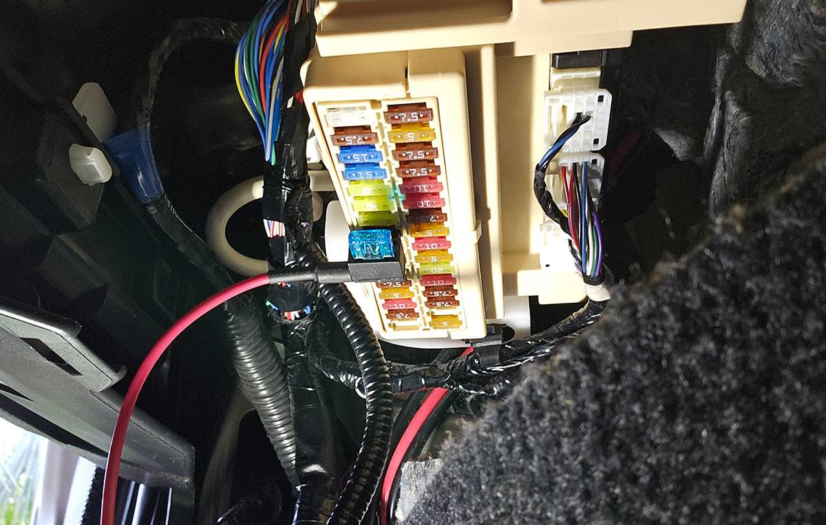

Because the RAV4 is a daily driver with extended periods of parking recording being required, powering it from fuse taps using the Viofo HK4 Hardwire Kit was mandatory.
S650 Mustang What's In ALM's Garage? 20250110_154720_1200
This bit is not difficult, just a PITA.
As it turned out, P/OUTLET No. 1 was a battery feed.
P/OUTLET No. 2 was a switched IGN feed.

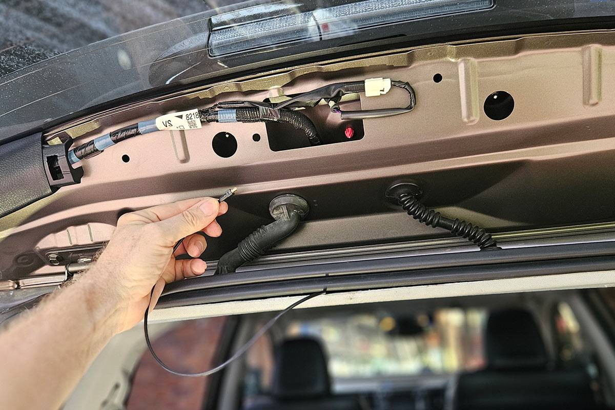

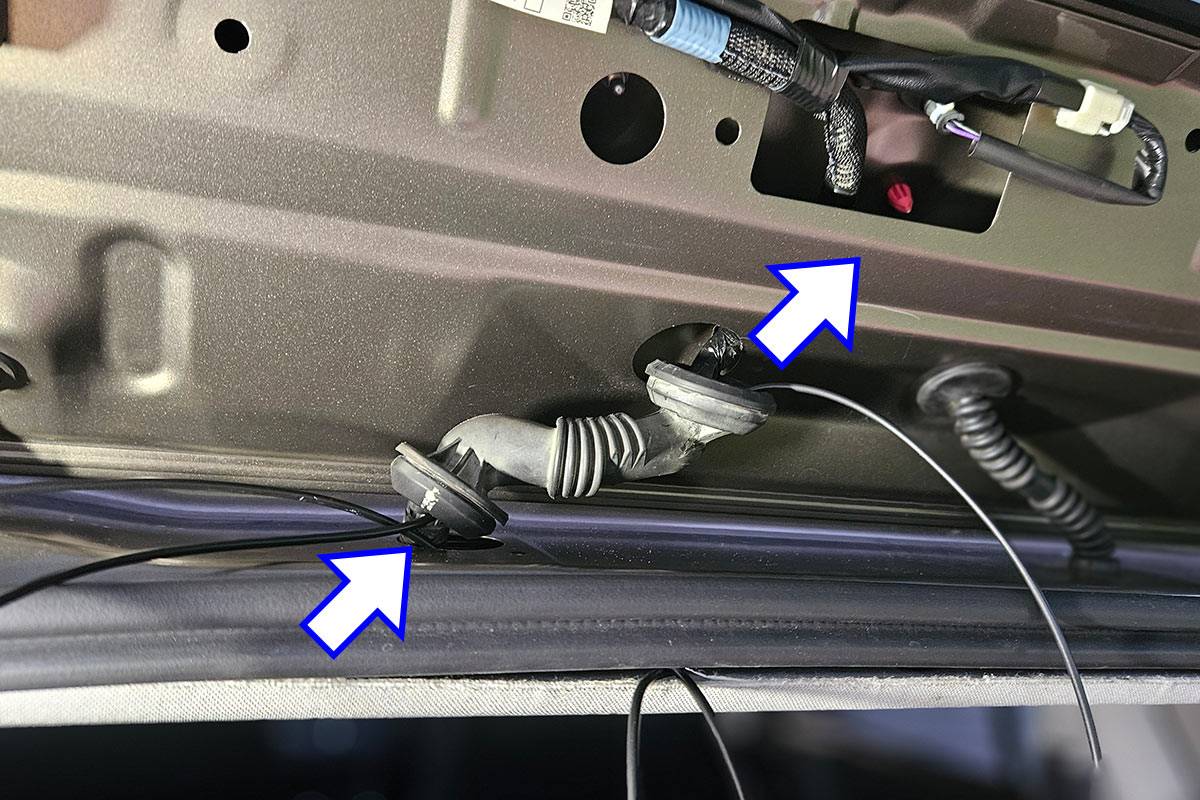

This is where the four-letter expletives start... the damn tailgate! :curse:
S650 Mustang What's In ALM's Garage? 20250110_174911_1200
Getting the cable into the tailgate.
We have two choices to feed the cable up through the rubber boots and cable management.
S650 Mustang What's In ALM's Garage? 20250110_165738_1200
Looking at photo time stamps, I spent the best part of an hour getting this bit done.
S650 Mustang What's In ALM's Garage? 20250110_174221_1200
Seriously, there must have been 20+ small wires running through here in that loom. :crazy:
Carefully nipping the rubber boot on the inside side and using coat hanger wire to feed the camera cable proved successful. Cable ties of various sizes were tried, but all got caught up inside. The stiff coat hanger wire provides visual feedback where the end is, and you can massage the rubber to help provide a straight-as-possible path for the coat hanger wire.

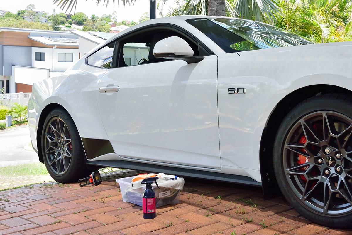

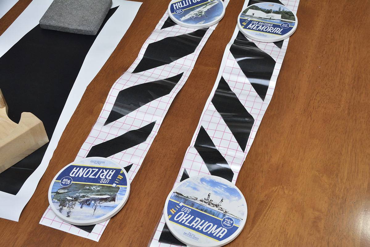

After a failed hood spears install, entirely my fault, it's taken me six more weeks to work up the courage, and apply these.
S650 Mustang What's In ALM's Garage? _DSC2997_1200
S650 Mustang What's In ALM's Garage? _DSC3003_1200
Now moving outside where there is more room to work on the drivers side.
Something about doing the weeds before taking photos! :facepalm: :giggle:
S650 Mustang What's In ALM's Garage? _DSC3023_1200
Final result:
S650 Mustang What's In ALM's Garage? _DSC3038_1200
S650 Mustang What's In ALM's Garage? _DSC3033_1200
I have to work out why I can screw up a hood spear so badly, being a single segment, but the rocker panel graphics comprising of 10 segments each side can be done quite OK. :whew:
Matt black tends to hide any imperfections so much better than a gloss black vinyl, I know that.
And a very un-exciting time lapse below, starting after the large rear segment was already on.
I was constantly referring the passenger side to measure the distance between the inner segments, which I was applying separately. This was because the front protective layer had ripples in it. ie; wasn't dead flat with the vinyl behind it. You can see that in the image below:
S650 Mustang What's In ALM's Garage? _DSC1857_1200
To be sure the squeegee was making proper contact on all of these segments, they were applied individually. Not hard, just took a bit longer.

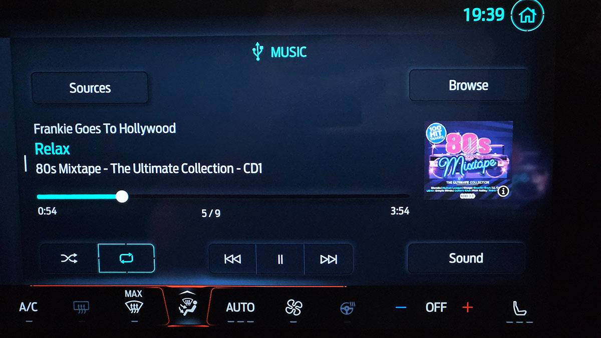

An unexpected discovery tonight!
Not sure if this is in the manual or not (the html manual is vague and generic, slow and painful to use, and I avoid it unless desperate!), and just discovered by trying it out, you can play .FLAC audio files on the B&O system.
S650 Mustang What's In ALM's Garage? 20250121_195504_1200
The red glowing USB stick fits in nicely with the red Slammer weighted shift knob. :rockon:
S650 Mustang What's In ALM's Garage? 20250121_194125_1200
S650 Mustang What's In ALM's Garage? 20250121_193956_1200

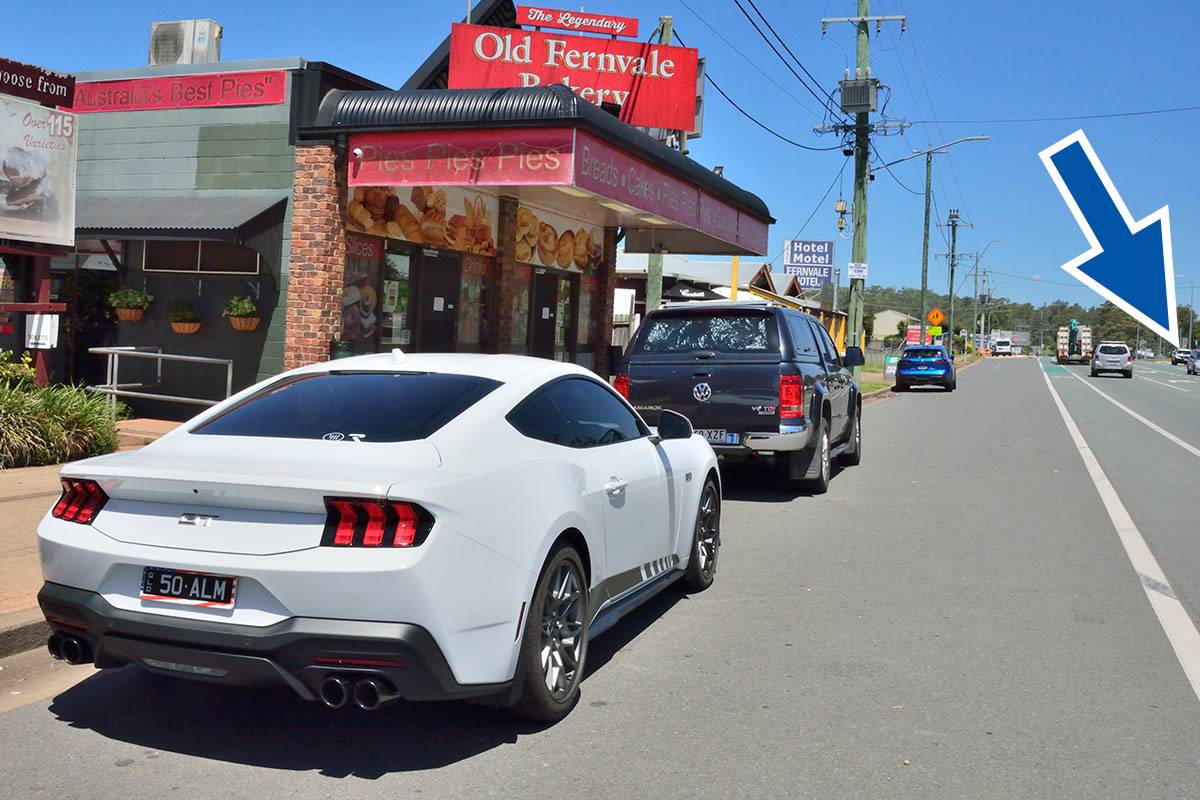

So, it was long overdue to go for a drive, and a few days ago out to the ever faithful Fernvale Bakery for a coffee and cake.
Beware!
Mr Plod with a radar speed gun sitting in his 4WD along the main drag catching those not adhering to the 50kmh town limit.

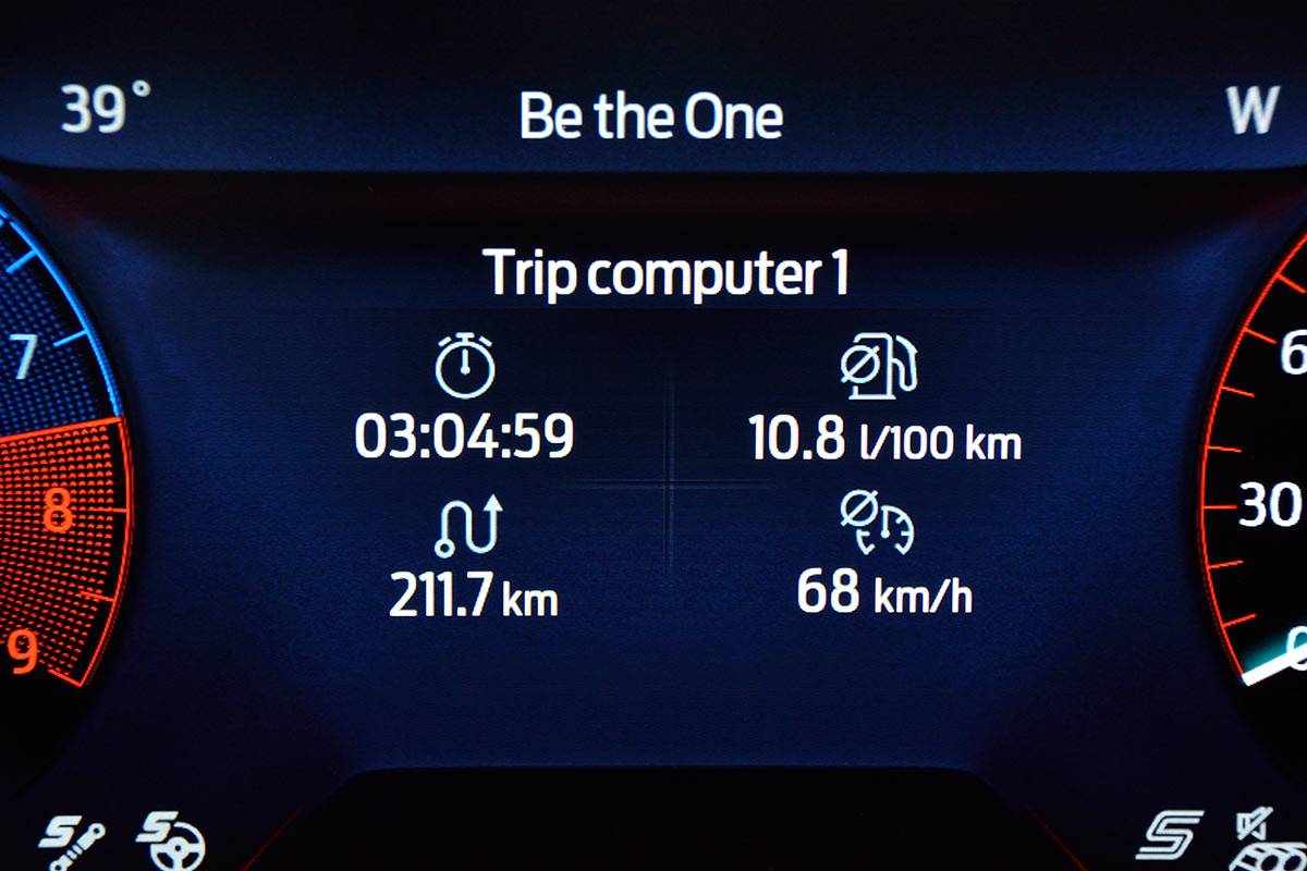

Just over 200 clicks of fun. :rockon:
