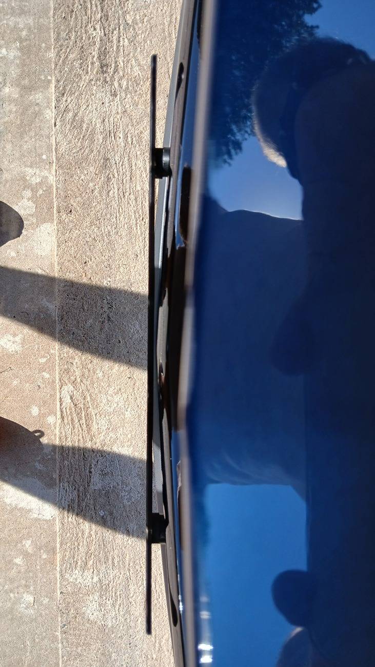

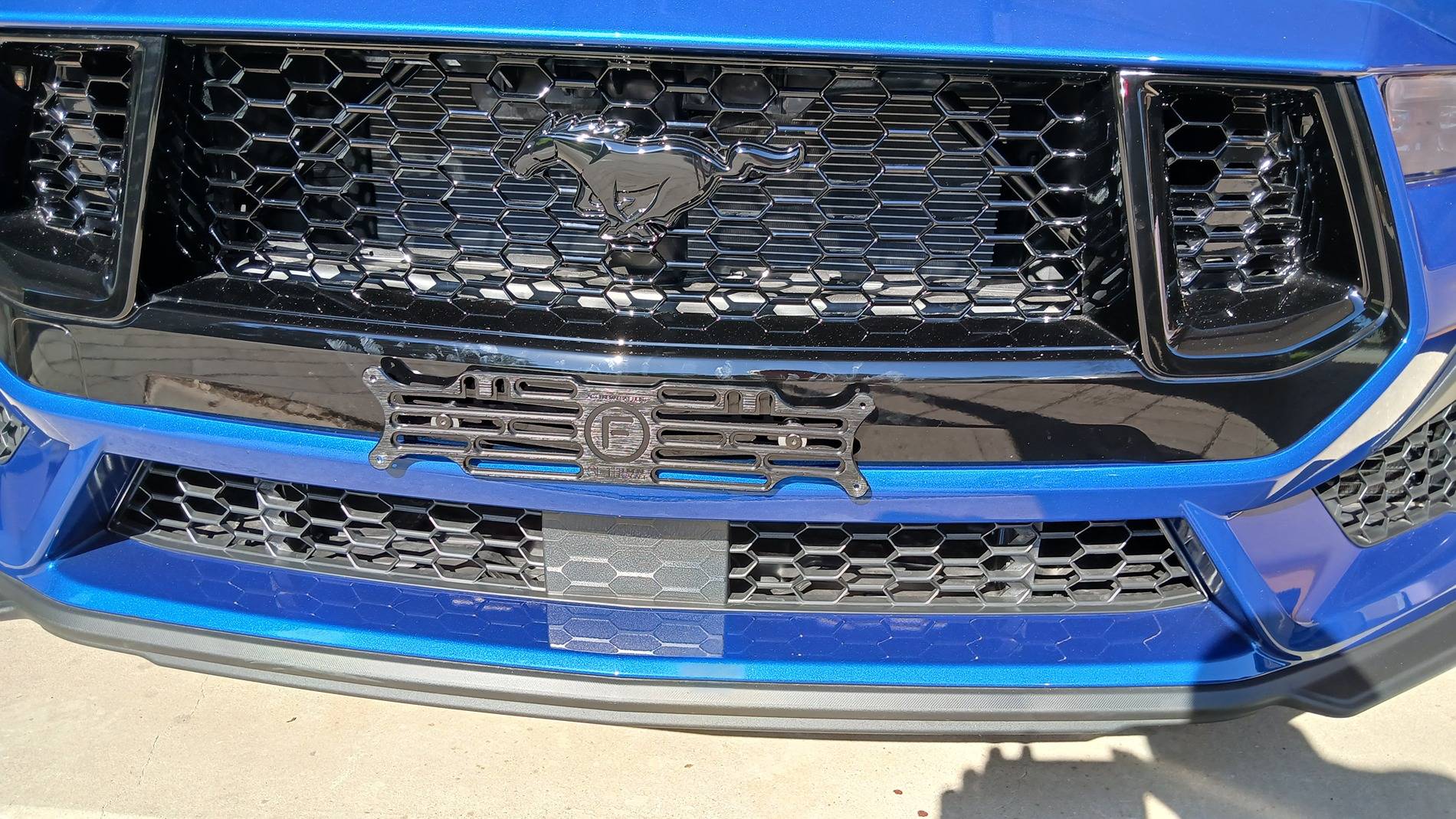

Hi All,
My dealer wasn't confident enough to fit the flow brackets to the front cause of the angled bumper, did the back plate and it looks fine.
I drove home from the dealer today with the front number plate resting on the dash on the passenger side :)
So it was up to me fit the front plate and while I consider myself a good DIYer I was VERY reluctant to be drilling holes in a car only a couple of hours old.
Using Adam's vid I guesstimated how far from the centreline the holes were and how far down the bumper they were so I could figure out where to drill. I then took a close look at the bumper and gave myself an uppercut!
There are two factory indentations in the front bumper as marks for the holes for the factory holders, and guess what - they align perfectly with where Adam's dealer drilled the holes for the Flow Brackets!
No stuffing around with measuring tapes and white out required, just drill where the indentations are and the alignment of the bracket will be fine.
For my install, I used the angled spacer and a flat spacer together to get the required offset from the "nose" of the bumper and can confirm that the "Option 1" screws supplied by Flow Designs with the brackets work just as well.
Have a good weekend.

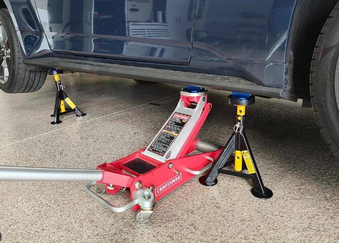

@5.0ALM , Have you used jack stands on your car yet now that you have those jacking pads installed?
As you know I have the same setup now and I need to take off the wheels to ceramic coat them. Lifting the car with a jack on these new jack pads will obviously work, but how do I swap the jack stands in. They will just need to go on the standard pinchweld spots I guess. I havent tried but was just going over it in my head wondering if that will work and if there will be enough space to get the jack and the jack stand in there at the same time.
I guess thats where the jacking rails make it easier, but I didnt want to cut the under body carpet panels.

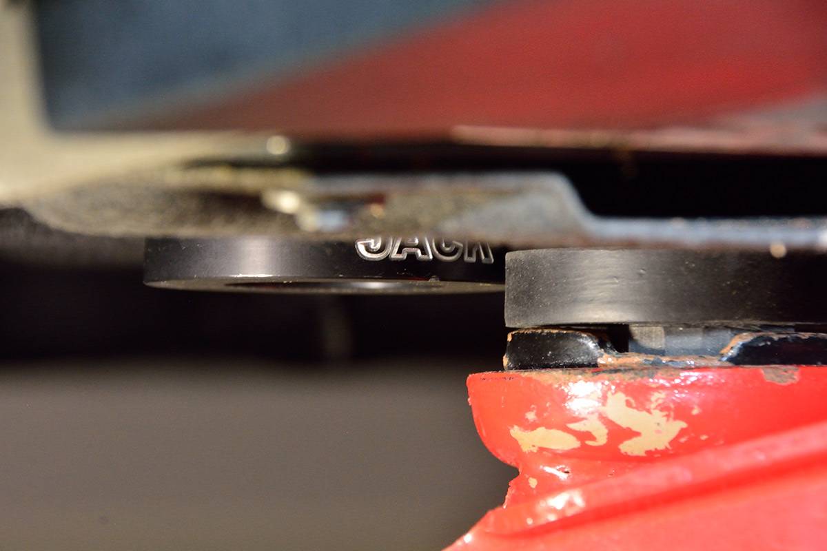

Hi Steve
Ahh.... the spare and the jack.
I was going to do a video months ago about the 20" spare, and jacking the bastard up.
That was November... never got around to it.
O/s work got in the way, then Xmas, then moved onto other things.

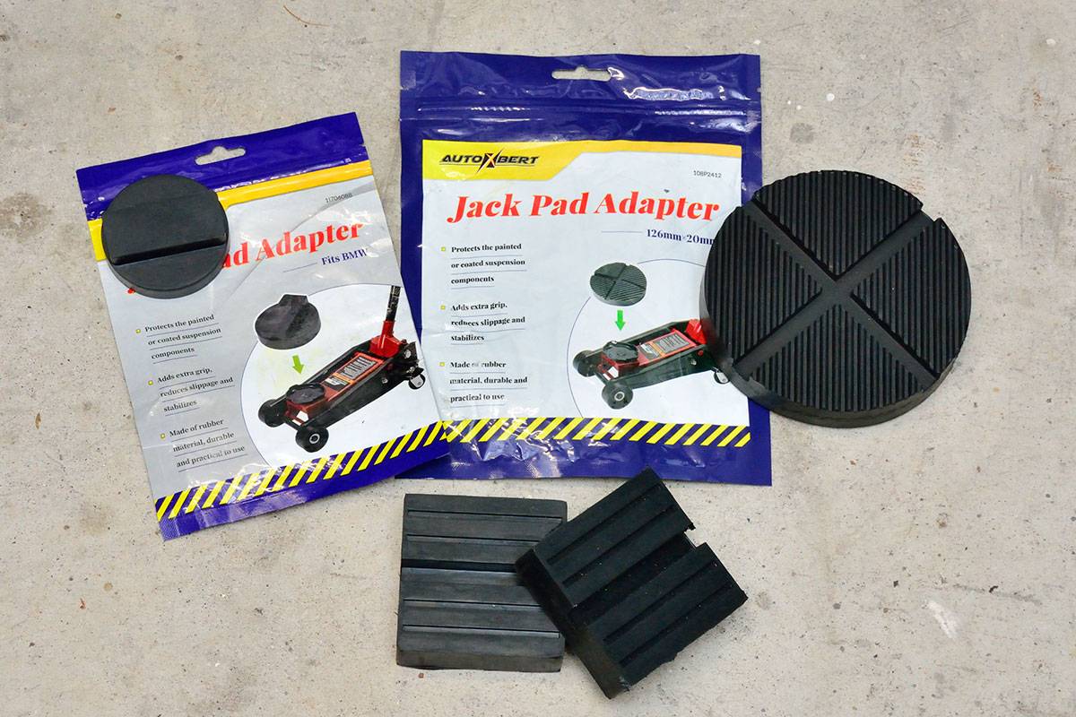

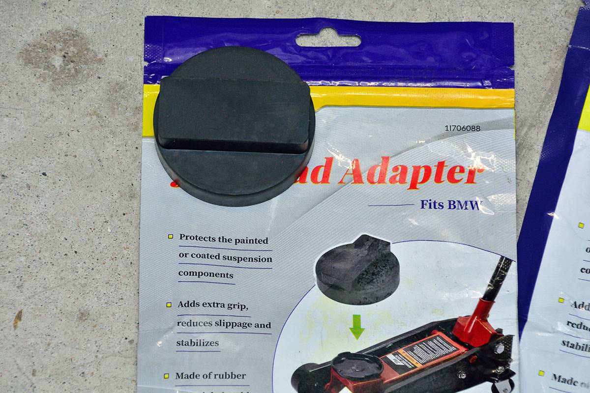

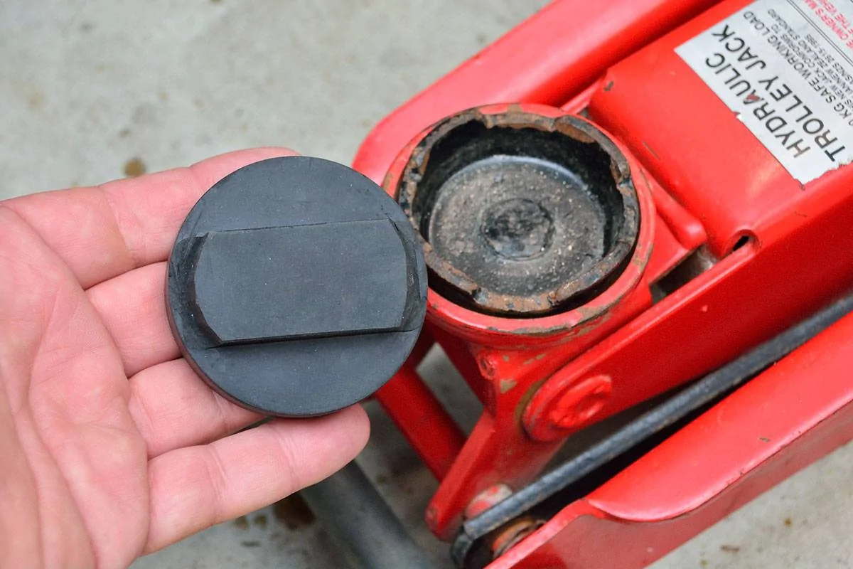

I did get a variety of rubber pads for the trolley jack to protect the underneath of the jacking pads.
Yep, neurotic! :facepalm: :giggle:
S650 Mustang What's In ALM's Garage? _DSC2388_1200

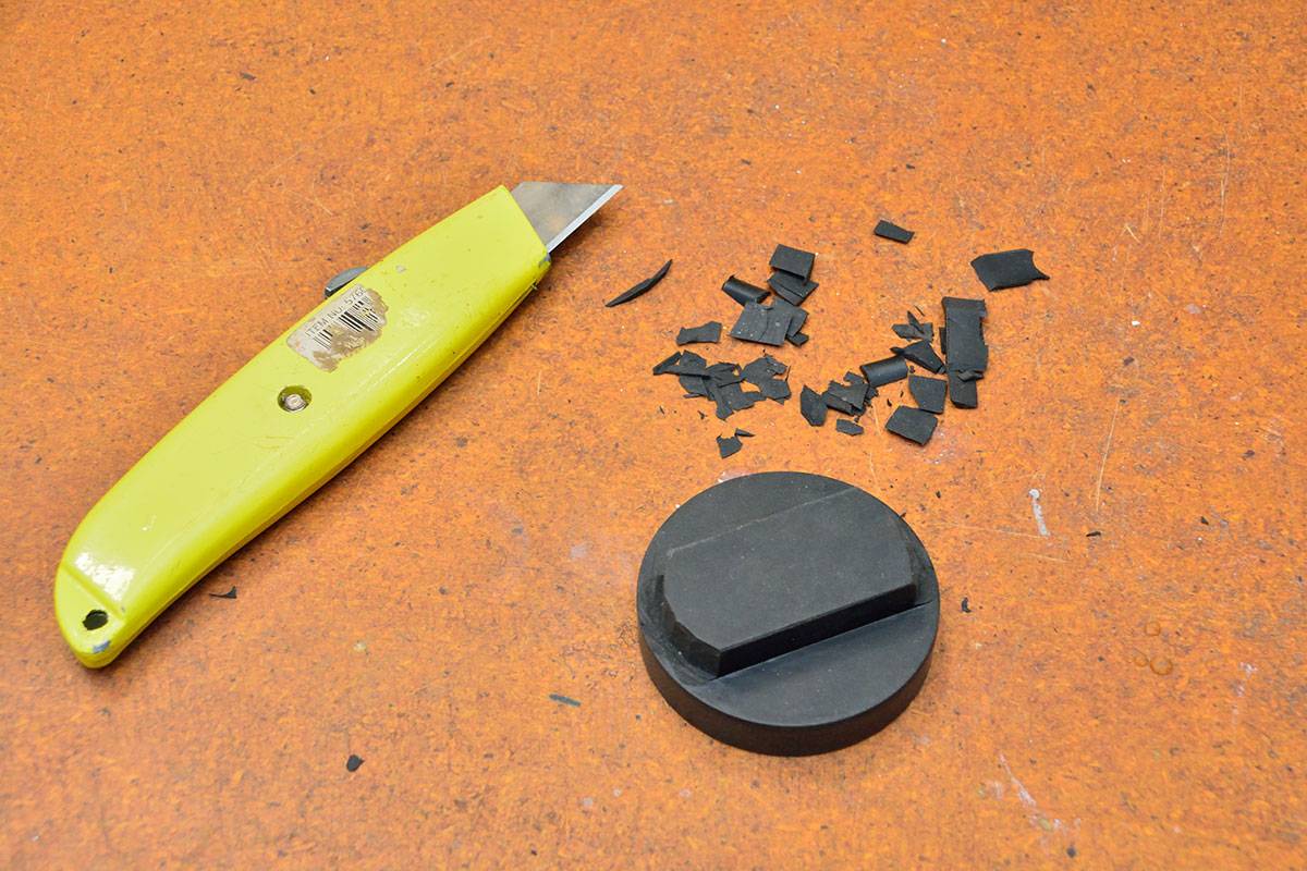

I found this one to be the most promising:
S650 Mustang What's In ALM's Garage? _DSC2392_1200
The bottom of it was shaved with a Stanley knife to fit into the jack's saddle:
S650 Mustang What's In ALM's Garage? _DSC2411_1200
S650 Mustang What's In ALM's Garage? _DSC2405_1200

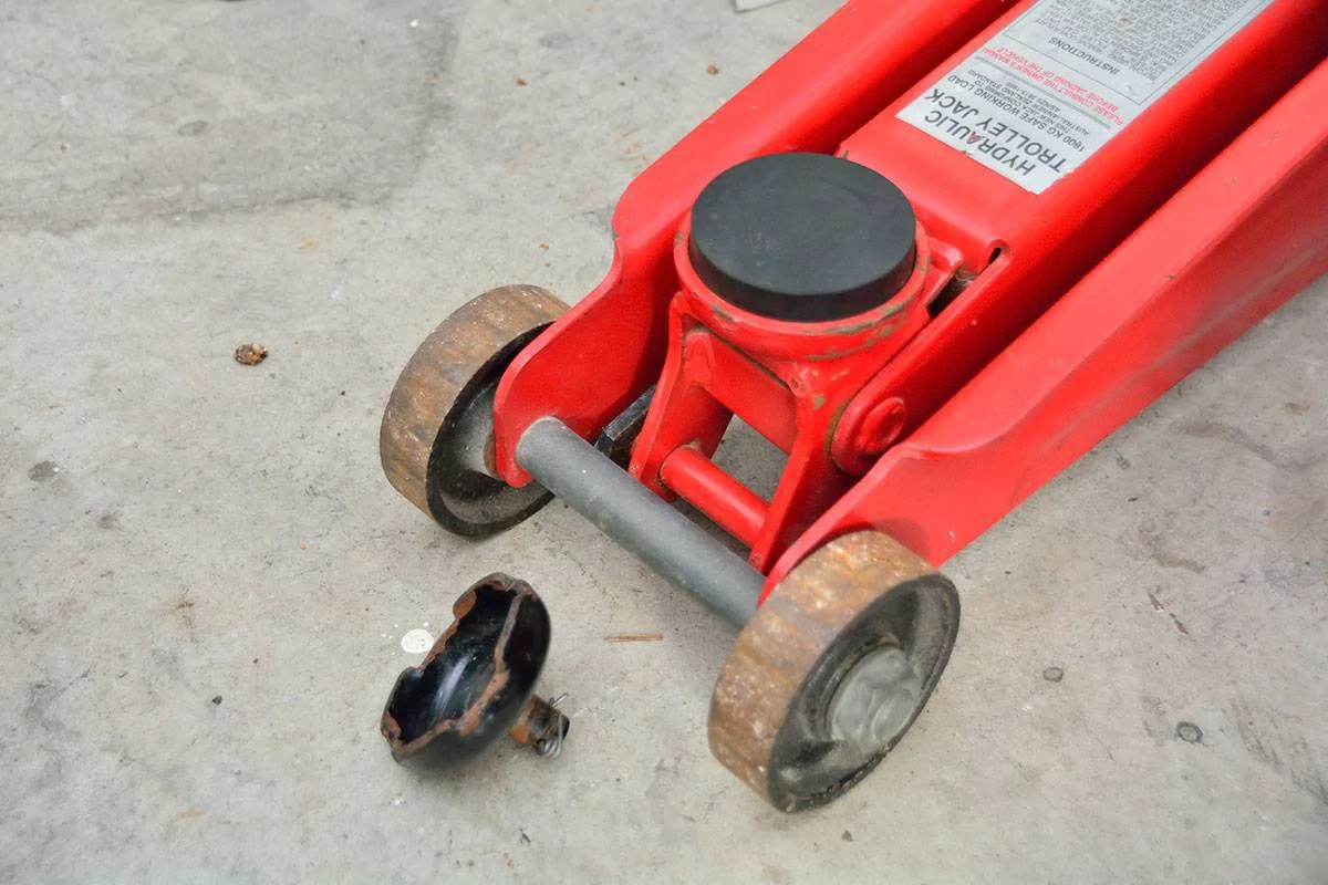

I then discovered with this rubber pad, the trolley jack couldn't get under the SVE jack pads:
S650 Mustang What's In ALM's Garage? _DSC2427_1200
S650 Mustang What's In ALM's Garage? Missed-By-That-Much
:facepalm:
I then removed the saddle, and the rubber pad now sits directly in the jack.
The pad is still free to move around as the angle of the jack changes with the car being lifted up:
S650 Mustang What's In ALM's Garage? _DSC3102_1200
It now slides in under the SVE pads.
Whilst it's all very nice using a trolley jack under the SVE pads in a controlled environment like the home garage, I really wanted to fit the spare using the jack that came with the spare.
ie; simulate a side-of-road situation with no jack stands.

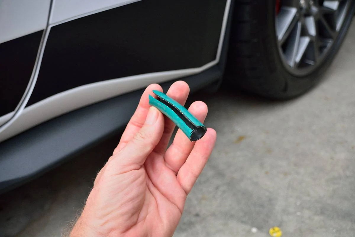

I didn't like the idea of the supplied jack's saddle going straight up onto the pinch welds.
The side profile of the supplied jack's saddle is not symmetrical, so none of the rubber pads above were suitable... they would simply split.
I ended up using a some garden hose:
S650 Mustang What's In ALM's Garage? _DSC3106_1200

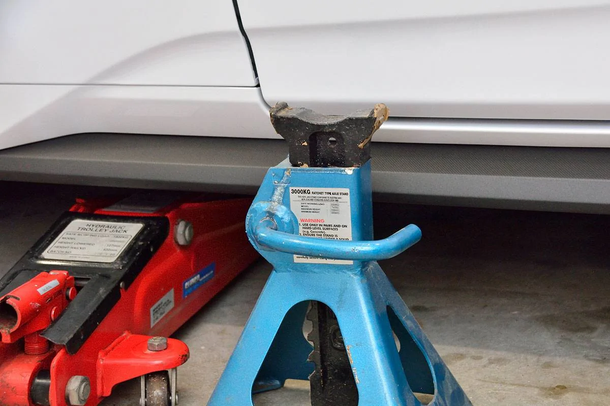

At the same time I discovered the low profile of the car meant it needed to be jacked up quite a bit for my jack stands to fit underneath.
S650 Mustang What's In ALM's Garage? _DSC2284_1200
I plan to use the rubber hose on the pinch welds with the jack stands as well.
Can't expect too many cycles of use with the hose, but I'll just cut off a bit more as required.
I wasn't entirely comfortable with jacking the car up so much, especially only having had it for a few weeks at that stage. Put it this way, I barely need to jack up my RAV4 for the strands to fit under. I was shopping around for new jack stands, but the minimum height of my existing stands were as good as any others I could find.
I really need to revisit the spare and jack.
Rehearsing a complete front wheel change was Job #1 for me in October.
Fail. :facepalm:
Neither did I - that's a butcher job that would need you to lift the car to install.
:facepalm:

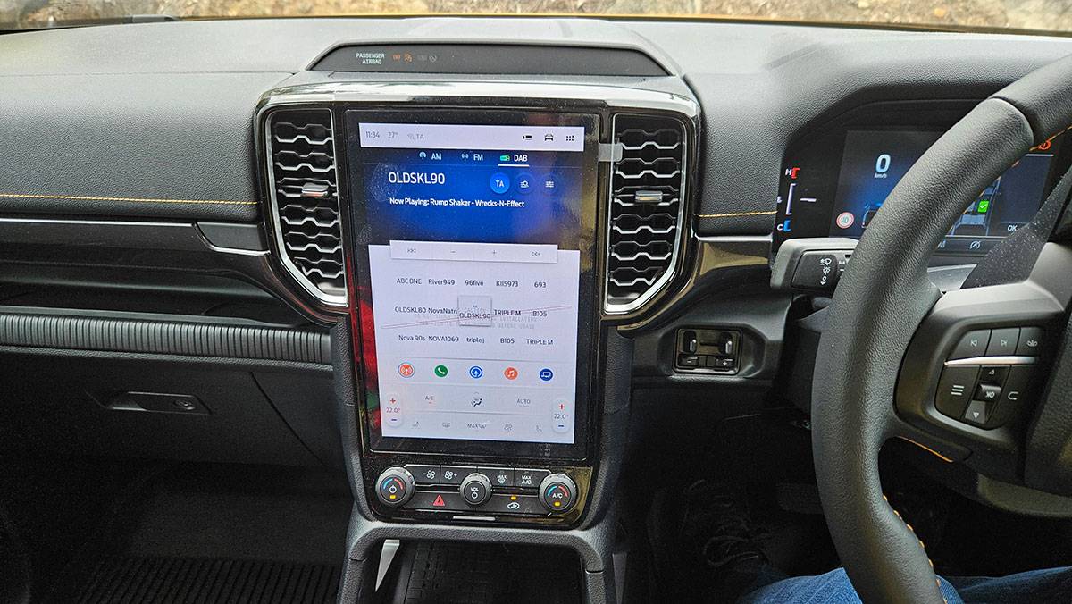

It's the RAV4's turn to get the same Viofo A329 2-Channel dash cam system.
I have a new appreciation of how easy the Mustang install was now.
Because the RAV4 is a daily driver with extended periods of parking recording being required, powering it from fuse taps using the Viofo HK4 Hardwire Kit was mandatory.
This bit is not difficult, just a PITA.
As it turned out, P/OUTLET No. 1 was a battery feed.
P/OUTLET No. 2 was a switched IGN feed.
Running the rear camera cable was same same as the Mustang.
Use your fingers and the provided trim tool to poke the cable under the headliner and door rubbers, and make your way back towards the rear.
This is where the four-letter expletives start... the damn tailgate! :curse:
Getting the cable into the tailgate.
We have two choices to feed the cable up through the rubber boots and cable management.
Looking at photo time stamps, I spent the best part of an hour getting this bit done.
Seriously, there must have been 20+ small wires running through here in that loom. :crazy:
Carefully nipping the rubber boot on the inside side and using coat hanger wire to feed the camera cable proved successful. Cable ties of various sizes were tried, but all got caught up inside. The stiff coat hanger wire provides visual feedback where the end is, and you can massage the rubber to help provide a straight-as-possible path for the coat hanger wire.
End result, and you can see the rear dash cam in the mirror!
Time will tell if the dash cam affects the DAB antenna's pattern (to the right) and reception.
And that's another thing, the Mustang's DAB antenna must be in the shark fin, because DAB reception is much better in the Stang.
I originally used the static sticker to mount the front camera, like I did with the Mustang, but the windscreen frits (the black dots) caused the static sticker to peel away from the glass. To work, it relies on the glass being, well, smooth as glass.
Once you have some driving done, you can then review the footage and tweak settings accordingly.
For the Mustang, compensation for the rear window being tinted meant tweaking the rear cam exposure up.
If you saw my Raceseng shift knob install video, I managed to sneak in some dash cam footage - always handy to have extra cameras if you're into that!
I can tell you the raw dash cam footage (of both front and back) is infinitely better than what you see on Youtube, especially the front 4k camera.
That video was only rendered out at 1080P 12MBs, and YT obviously compresses it even more.
Compression is obvious with the pixelation on fast changing scene detail (ie; the motorway on-ramp foliage off to the left).
Job done.
