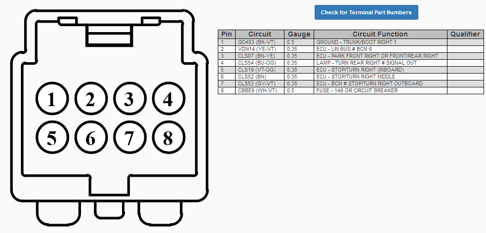

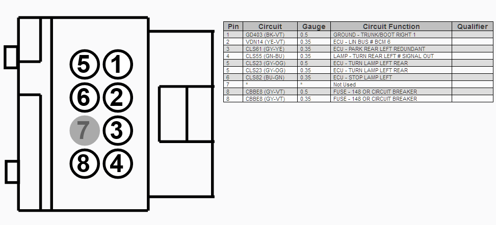

If the signal on pin 2 is CAN-bus data and the actual LED segments are controlled by a board within the tail lamp assy, then aftermarket sequential turn indicator could be expected.Also, it appears we will NOT be getting the SEQUENTIAL Tail lights, as our "Export" units have completely different wiring, connectors & part numbers (Thanks to Rocket for info).
Export Tail Lights
