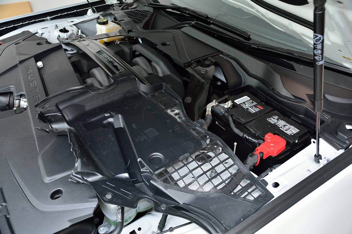

Under the Hood Inspection
After 1600km and 11 weeks of ownership, it was time to have a poke around under the hood.

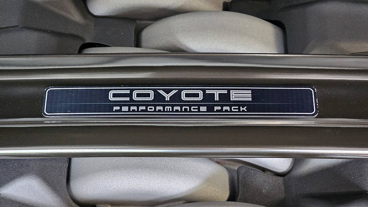

Strut Tower Brace Badge
First, checking the install (a fancy way of saying "stuck on" :giggle: ) the strut tower brace badge.
"Installed" on 27-10-2024, and the adhesive showing no signs of releasing.
S650 Mustang What's In ALM's Garage? _DSC2686_1200
I did have concerns about how good double-sided "trophy tape" would perform in a hot environment, but no worries!
S650 Mustang What's In ALM's Garage? 20250102_093743_1200
A shame the edges have printing defects, but not so noticeable when you're standing back from it, but I couldn't be bothered dealing with a vendor that doesn't ship outside of the US.

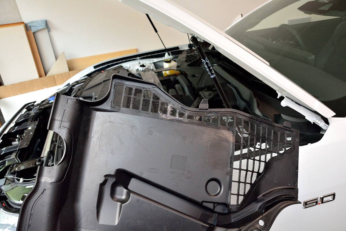

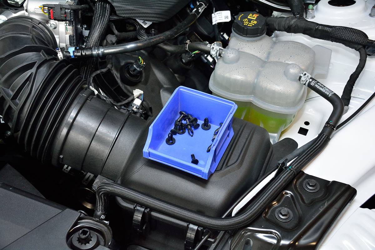

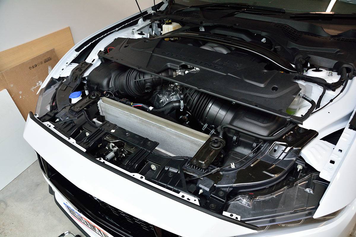

Radiator Cover Removal
I'm actually doing some research work on a front parking camera project.
The driver's low stance and not being able to see where the nose really is does annoy me.

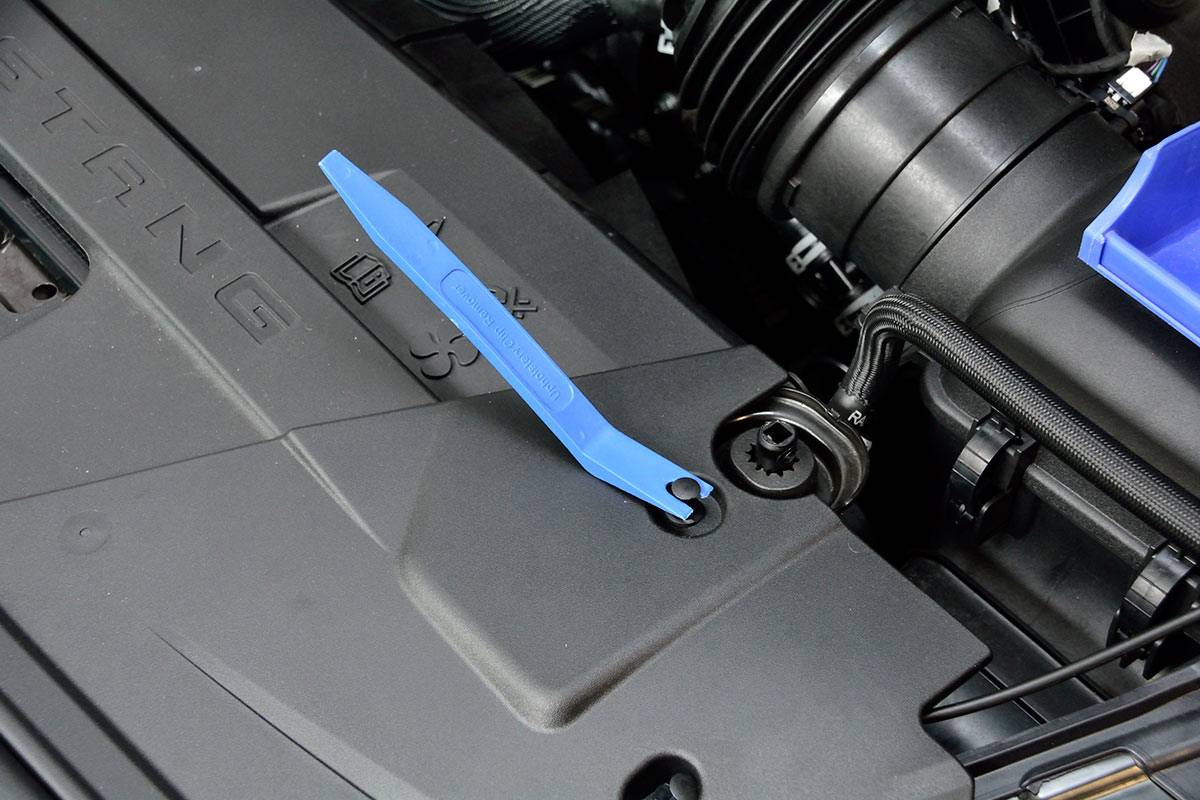

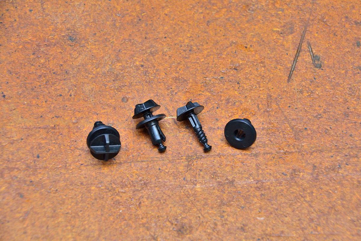

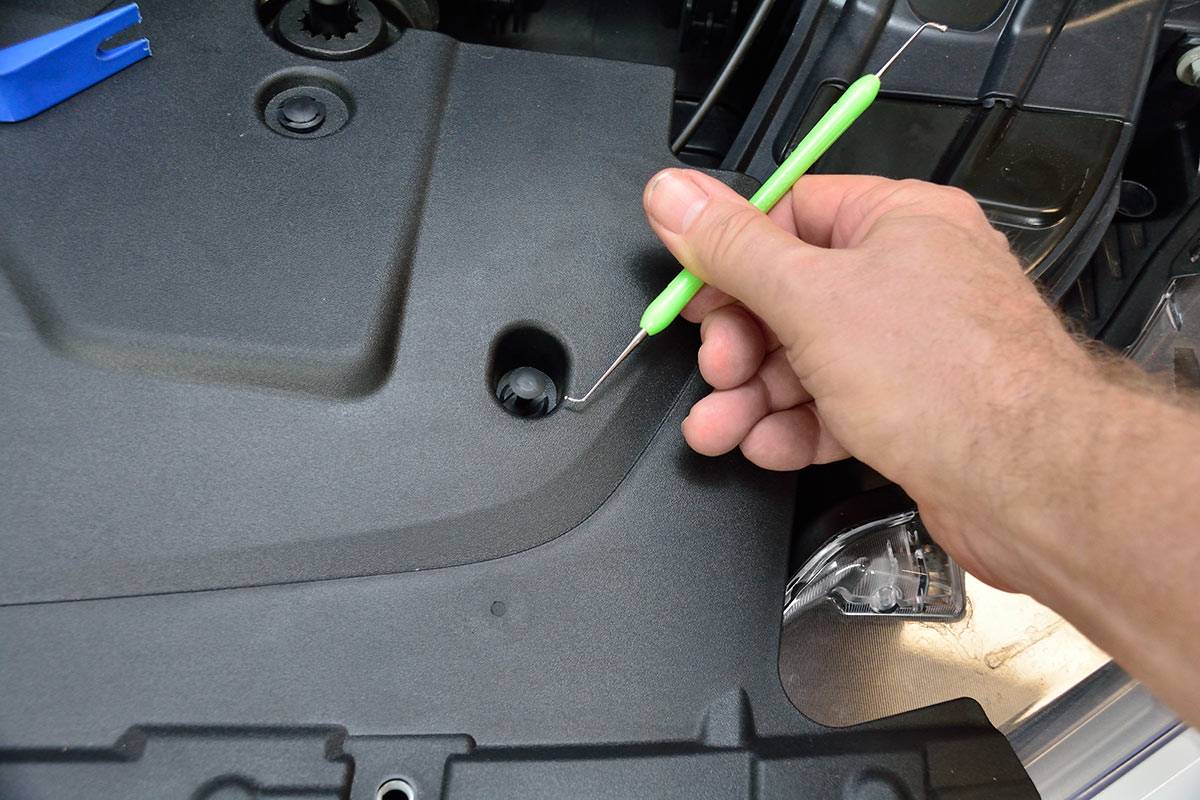

Removing the radiator cover is straightforward, 6 retainer clips are easily removed with a trim removal tool.
S650 Mustang What's In ALM's Garage? _DSC2695_1200
Two clips are recessed and you'll need some sort of "L" shaped tool to pry them up.
I just happen to have this, which I think was a part of a dentistry kit.
Use whatever you have.
S650 Mustang What's In ALM's Garage? _DSC2698_1200
Having been in the electronics game since Adam was a boy (see what I did there!) I'm into the habit of putting screws etc into containers, so they don't go missing. Ask me why I do this!
Nothing worse than re-assembling something, only to discover a vital widget has gone missing, or discovering later, a widget was left over!
S650 Mustang What's In ALM's Garage? _DSC2693_1200
S650 Mustang What's In ALM's Garage? _DSC2663_1200
My project investigations for a front parking camera lead me down towards the lower grille.

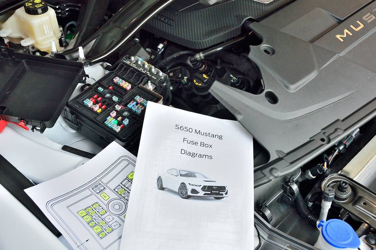

BCMC/BJB Junction Box
(Body Control Module C/ Battery Junction Box)
Weeks ago I made myself a reference fuse box document..
It's one of those things you never think about... until you need it.
Will start a specific topic and post the PDF for that.
S650 Mustang What's In ALM's Garage? _DSC2690_1200
I can tell you unused fuses F125 and F140 (both 5A) are fitted.
They both remain on for the same amount of time the mirror USB does after engine switch off, that being 1H 19M ish.
All other missing fuses don't even have sockets to plug a fuse into.
Obviously a generic fuse box used across multiple models, and populated to suit.

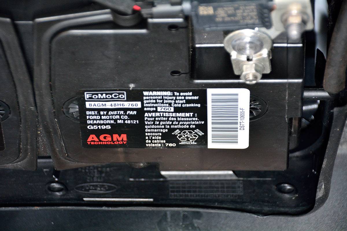

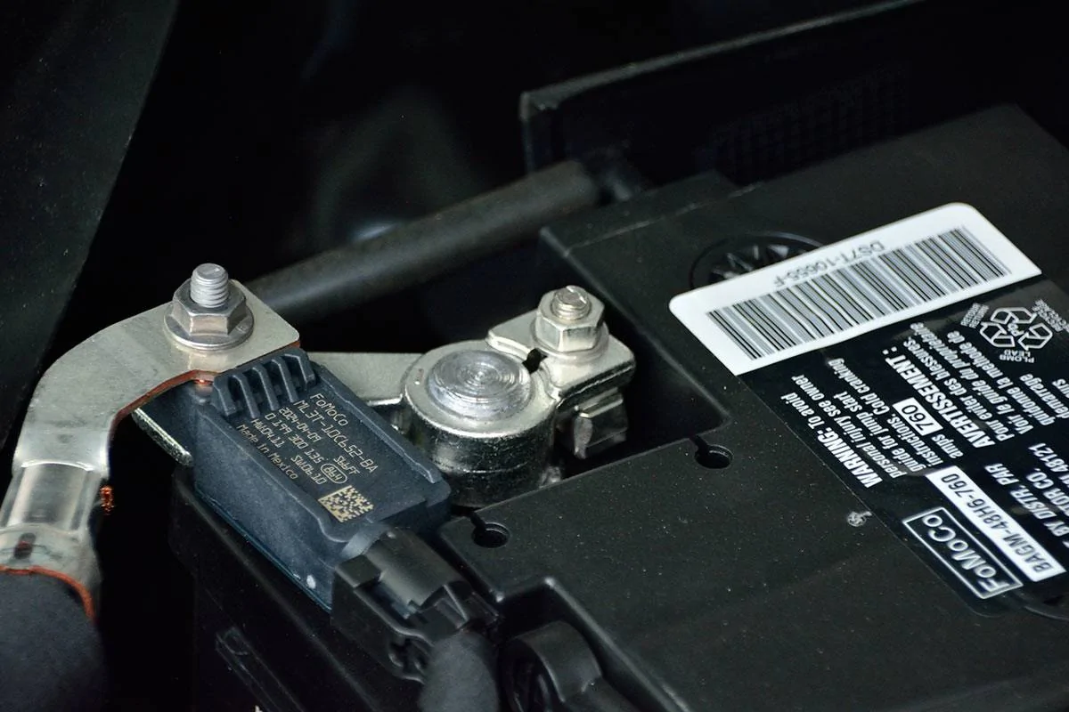

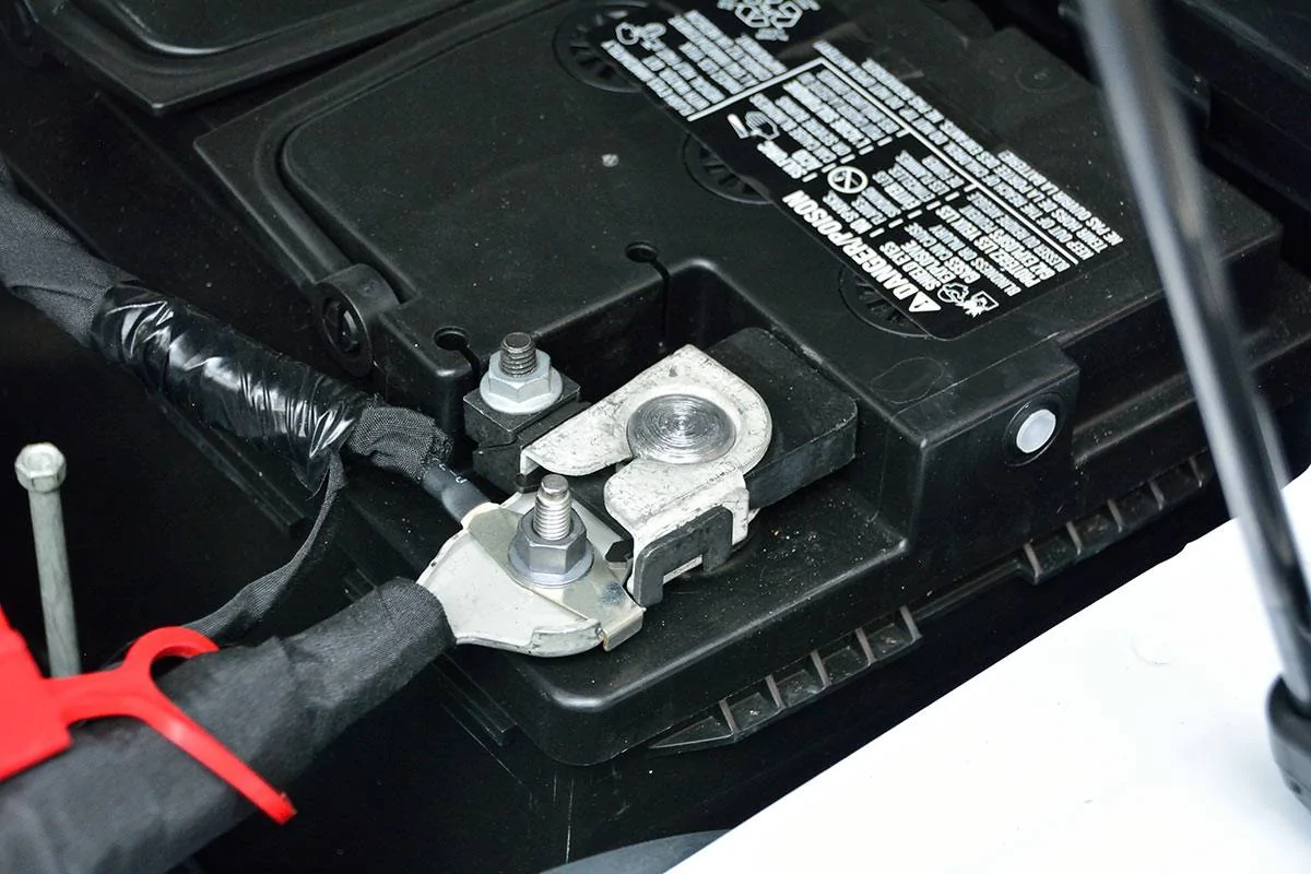

OEM Battery Inspection
Battery cover removal is easy, with only three retainer clips.
S650 Mustang What's In ALM's Garage? _DSC2684_1200
S650 Mustang What's In ALM's Garage? _DSC2680_1200

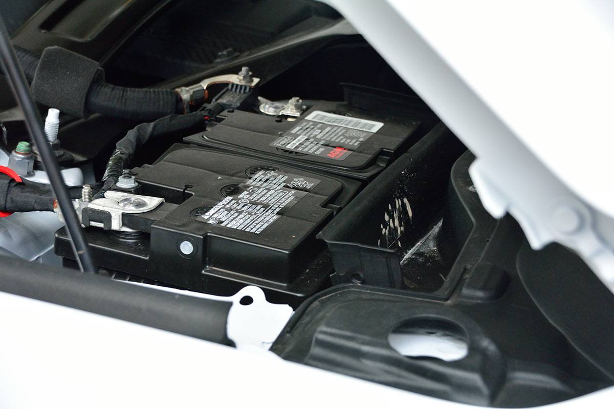

Cover removed and behold, a Motorcraft BAGM-48H-760.
If the image perspective looks weird, it was taken from front-on and flipped both V & H.
S650 Mustang What's In ALM's Garage? _DSC2675_1200
I hate to think how much a dealer is going to want for a "genuine" replacement.
S650 Mustang What's In ALM's Garage? _DSC2672_1200
No problem with either terminal.
S650 Mustang What's In ALM's Garage? _DSC2674_1200
The white powdery looking "stuff" got an immediate reaction!
S650 Mustang What's In ALM's Garage? _DSC2671_1200
It's obviously outside of the battery box area, and left over residue from the last wash.
I was under the pump doing two cars at once, and to be honest, didn't even lift the hood during that detail session. :facepalm:
Same same with the cover itself.
S650 Mustang What's In ALM's Garage? _DSC2682_1200
A quick wipe away with some 10:1 Greenstar APC got rid of that.
No issues here, so cover back on.

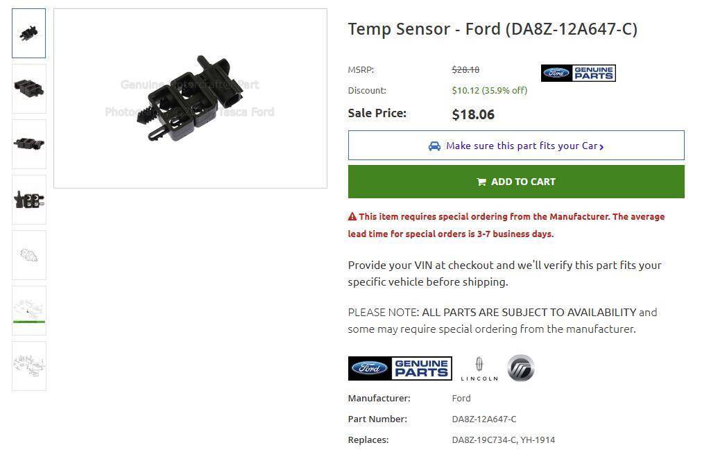

Mystery solved. :whew:
It's the temperature sensor.
It looked like a retainer clip that was holding the connector in place.
S650 Mustang What's In ALM's Garage? ambient_temp_sensor-
Better call Specsavers. :giggle:

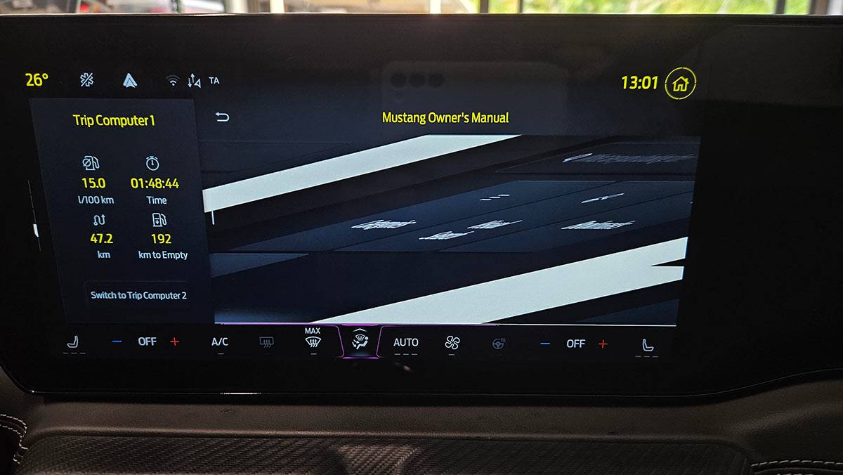

It's Not a Bug, It's a Feature
Two days ago I was sitting in the car, on the passenger side, going over settings.
Engine not running, but "ON".
Primarily to check the "Key Detection" setting was actually still disabled.
Because I was wondering why the F##K I still got a double honk when key detect was disabled, the last time I exited the vehicle. :explode:
Navigating to the Owners Manual, and this...
S650 Mustang What's In ALM's Garage? 20250102_130205_1200
Interesting that only one window of the screen had that non-sync look about it.
That window came good when going "Home".

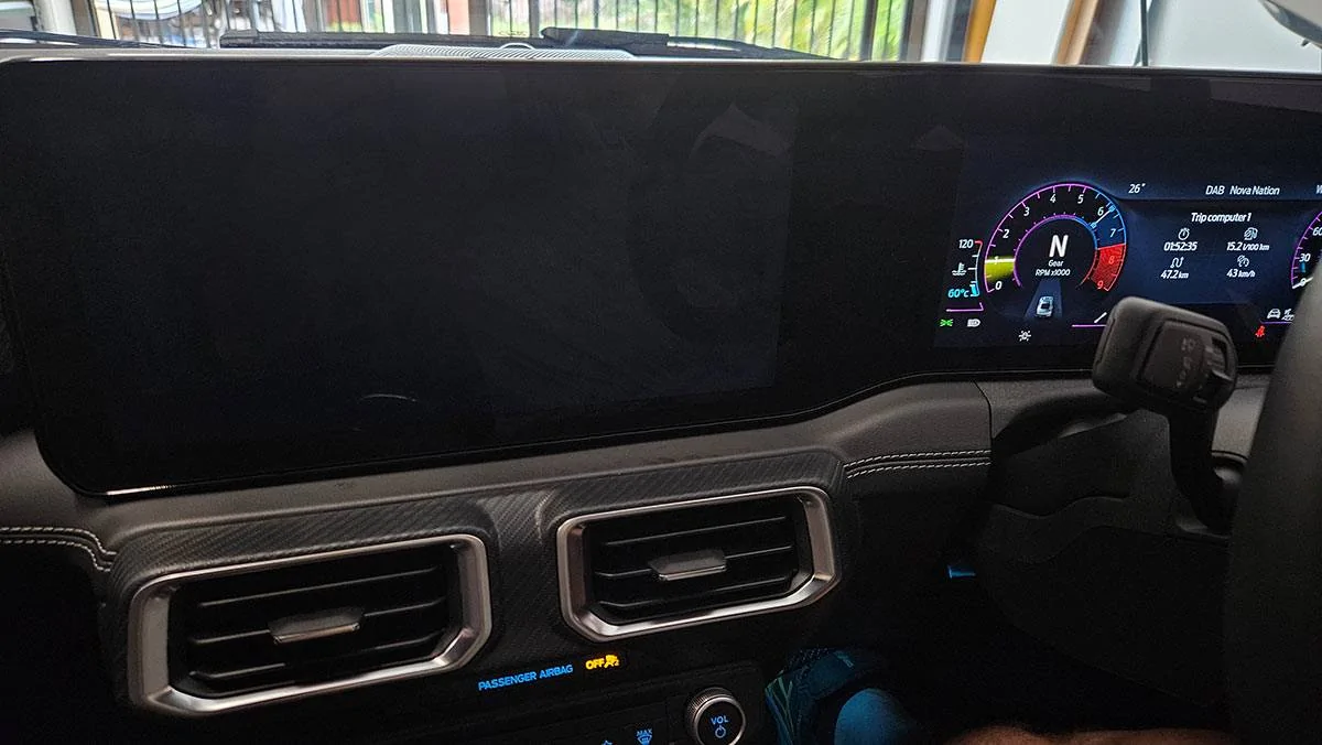

Four minutes later, the center screen goes to black:
S650 Mustang What's In ALM's Garage? 20250102_130558_1200
Note how the Instrument Cluster was unaffected.
With recall 24C35, I've never seen reference to the center screen, it's always been about the cluster screen.
No touch inputs on the center screen would change this situation. :inspect:
Using a physical button on the steering wheel to change drive modes brought the screen back.
It's been ok since, as if nothing happened at all.
