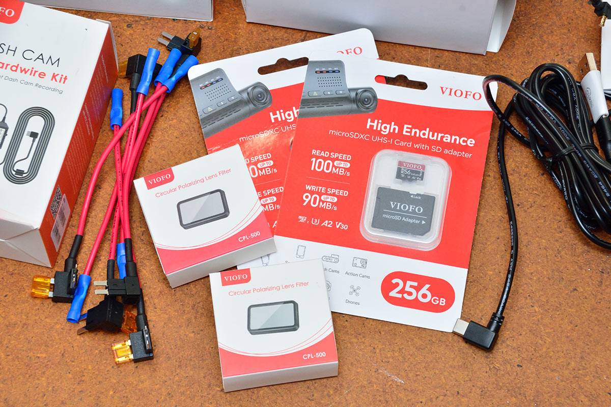

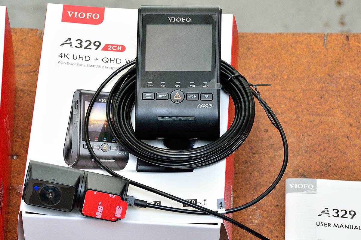

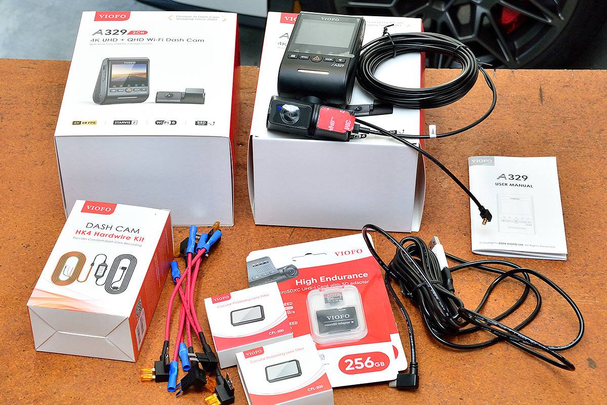

With that in mind, two were purchased during the recent Black Friday specials, one for the Mustang, and one for the RAV4 daily driver. Viofo Australia must have been overwhelmed with orders because it took over a week to ship out their door.
S650 Mustang What's In ALM's Garage? _DSC2616_1200
Powering the dash cam in the Mustang was a big unknown at the time of ordering, so only one hardwire kit for the RAV4 was purchased, along with fuse taps. More on powering the dash cam coming up...
S650 Mustang What's In ALM's Garage? _DSC2618_1200
CPL filters (circular polarising) come standard for the front cameras, but consider it mandatory to get the optional CPL filters for the rear cameras, along with the recommended SD cards. Although you can buy generic and brand name cards from anywhere, lots of people tend to have drama with cards that are not on the "approved list". That can be a bit hit and miss, and not worth the false saving.
S650 Mustang What's In ALM's Garage? _DSC2621_1200

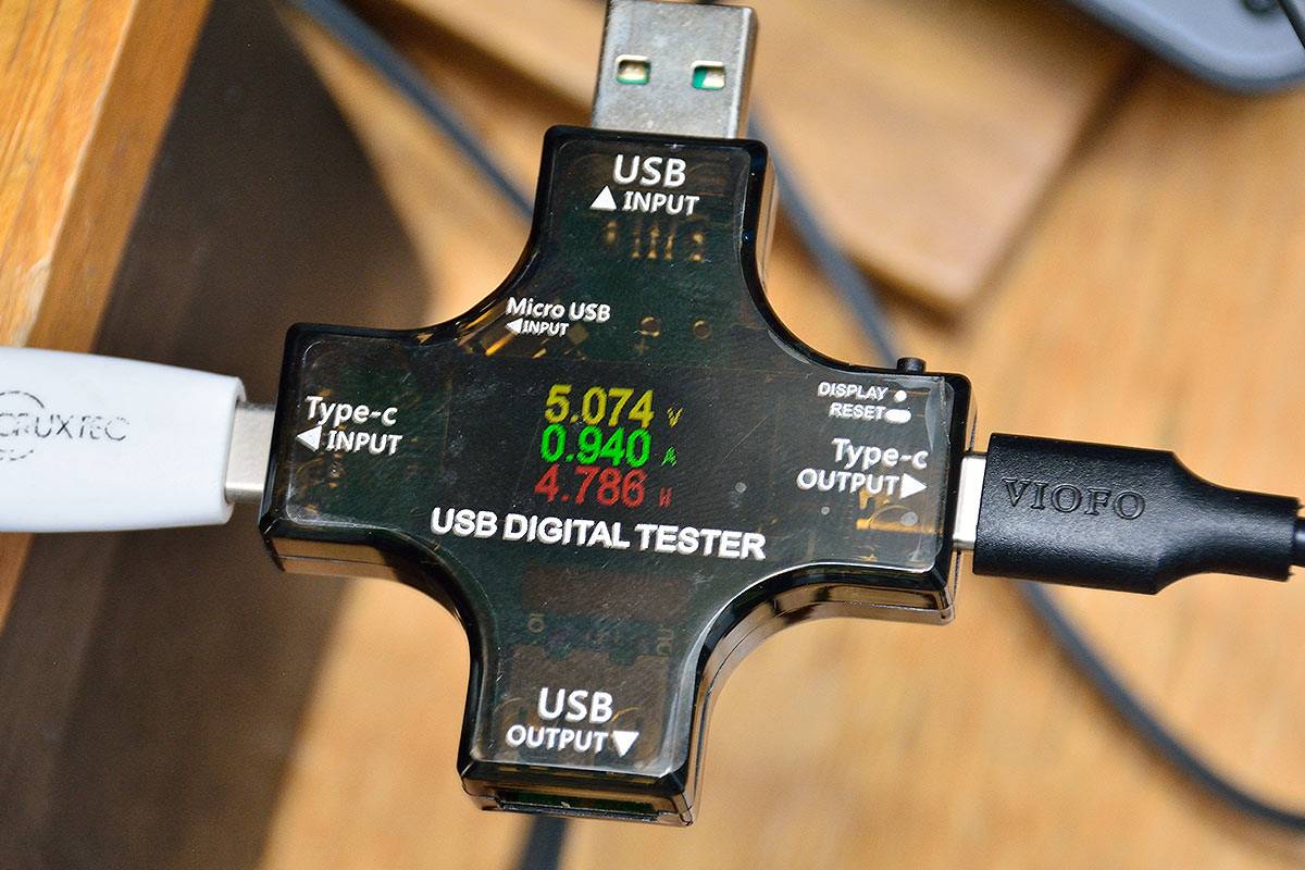

Now, powering the thing.
Just because it has a USB-C connector doesn't automatically mean it will run off 5V.
USB-C devices could run off 5V, 9V, 12V or even 18V as my HP x360 Envy notebook does.
I was pleasantly surprised that the A329 actually runs off 5V, and in the 2 channel configuration.
Current @5V was just under 1A.

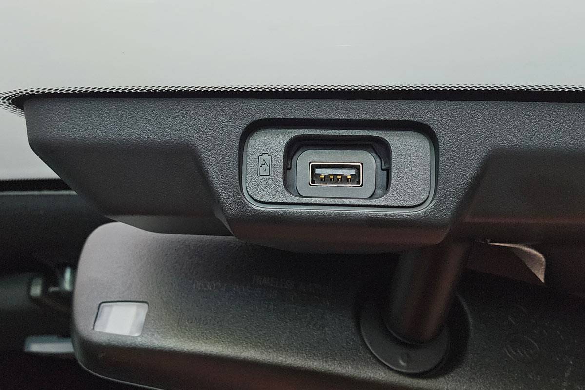

And guess what we have in the rear view mirror assembly?
A USB connector delivering 5V.
S650 Mustang What's In ALM's Garage? 20241221_115527_1200
Hooking up the A329 in 2-Ch configuration in the Mustang, and it "just works" being powered off the mirror port!
Posts on this forum suggest this USB port remains powered up for ~20 minutes or so after the vehicle is powered down, although I'm going to do my own tests to verify this.
If that's the case, then perfect for the 50ALM garage Queen.
Not being a daily driver, I have no need to keep the dash cam powered up all day long.

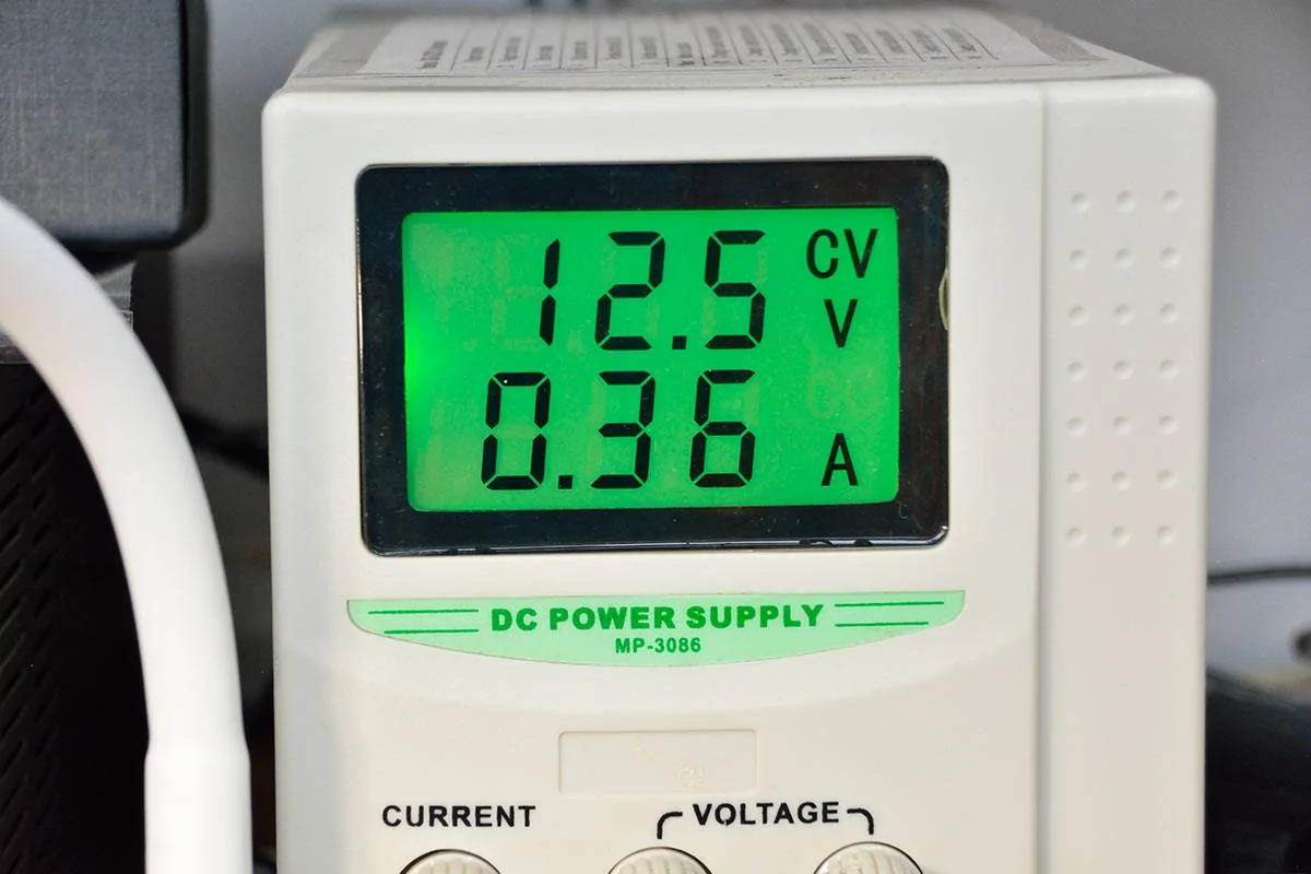

And for the hell of it, back in the "lab" inside, current draw @ 12V5 (nominal battery volts with vehicle off)
S650 Mustang What's In ALM's Garage? _DSC2629_1200

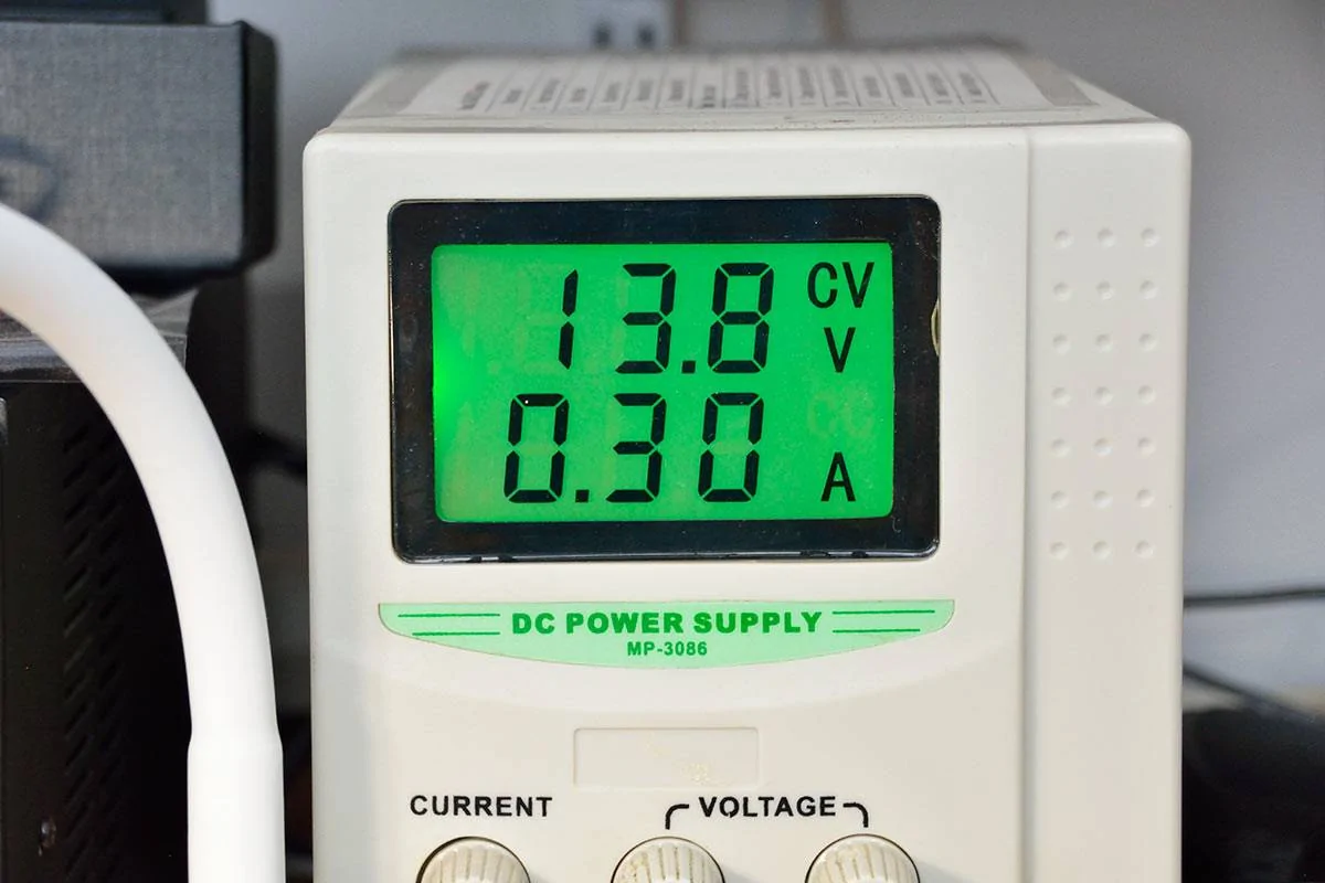

And whilst the vehicle would be running @ nominal 13V8

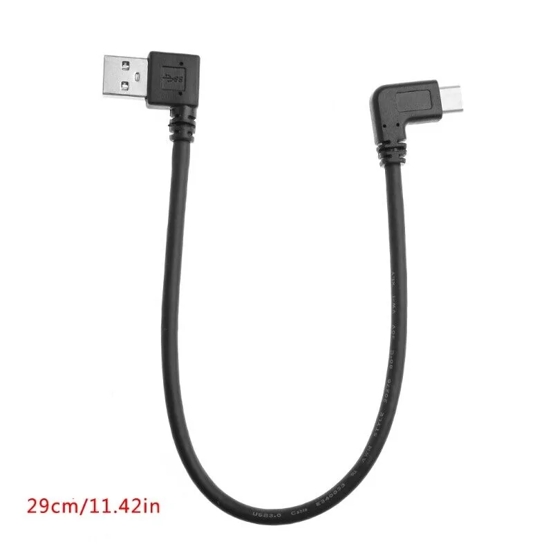

After scouring the internet, I believe I've found the ideal short (29cm) USB-A to USB-C lead with right angle connectors to keep the install neat. It was important to make sure the USB-A connector was orientated the correct way with the dash cam being on the drivers side of the mirror.
S650 Mustang What's In ALM's Garage? USB-A to USB-C RA
I'll just put up with the longer supplied lead and an adpater until this lead arrives in two weeks.

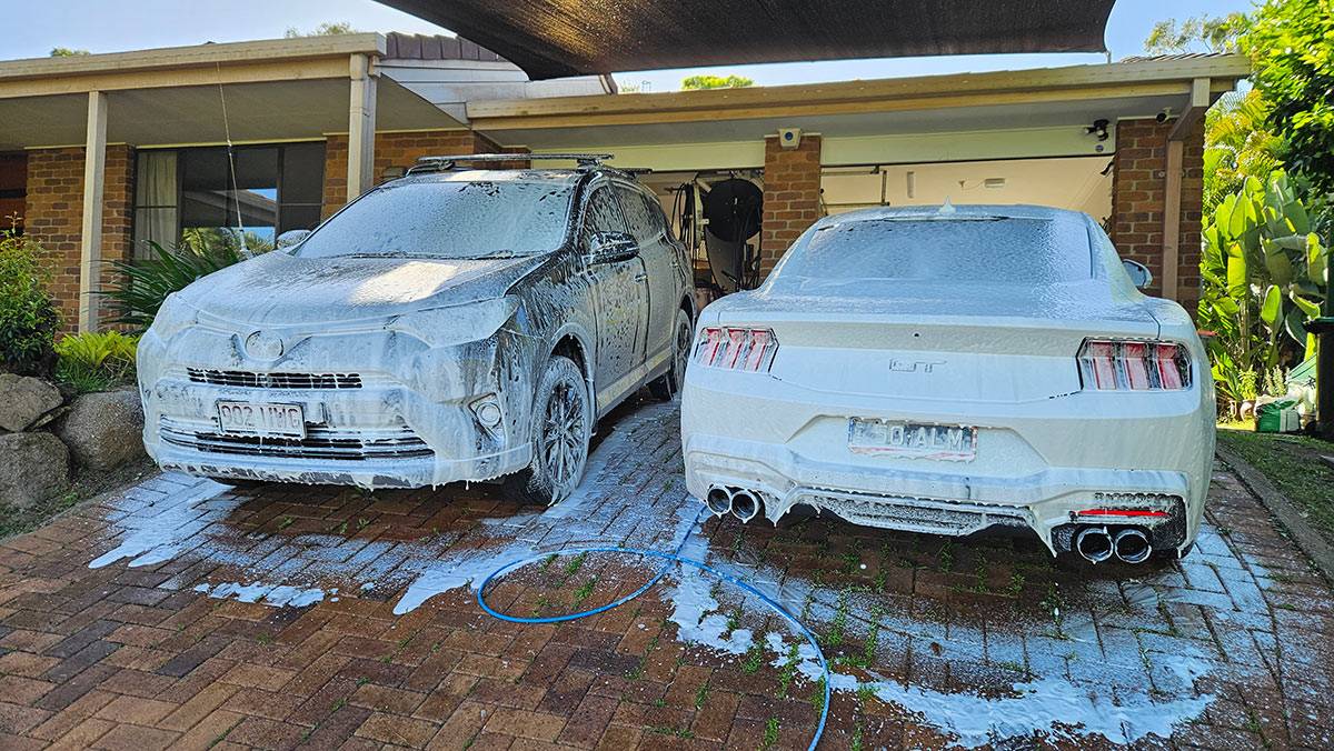

Stoopid #1

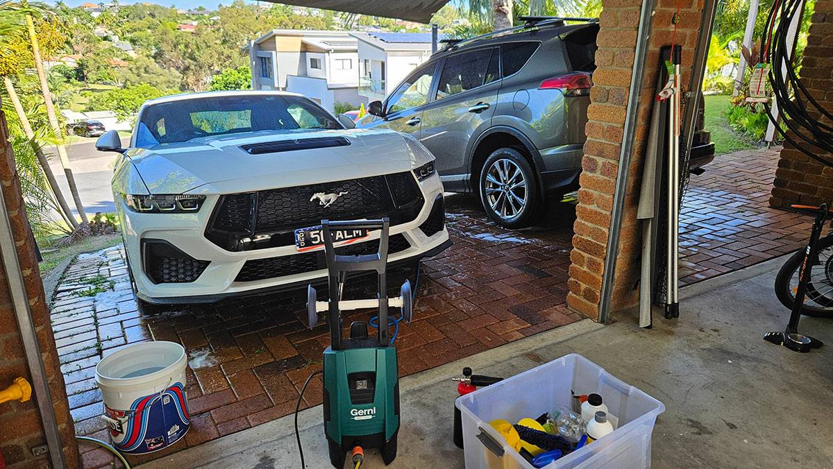

This was a stoopid idea!
The perception of "saving time" by cleaning two cars at once.
Won't be doing this again. :facepalm:
S650 Mustang What's In ALM's Garage? 20241226_155322_1200
It''s perfectly manageable to brake buster four wheels with the cannon, get in there with the wheel mitt, and rinse, one vehicle at a time.
Not so bad doing a decon foam with Carpro Lift of one after another another.
Dwell for a few minutes, and rinse off the first then second foamed vehicle.
S650 Mustang What's In ALM's Garage? 20241226_160520_1200
The mad panic then begins with foaming both with Carpro Reset , the contact wash with the mf pad, getting to the second vehicle, wash, and then rinsing before things start to dry out.
Then blow drying and touching up with a contact wipe down.
I always wash in the late afternoon with a setting sun on the other side of the house, and I have the shade sail anyway, if I do a single car parked in the middle of the drive.
Never again! :lipssealed: :facepalm:

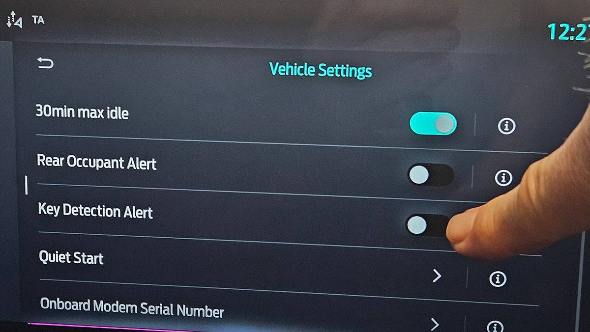

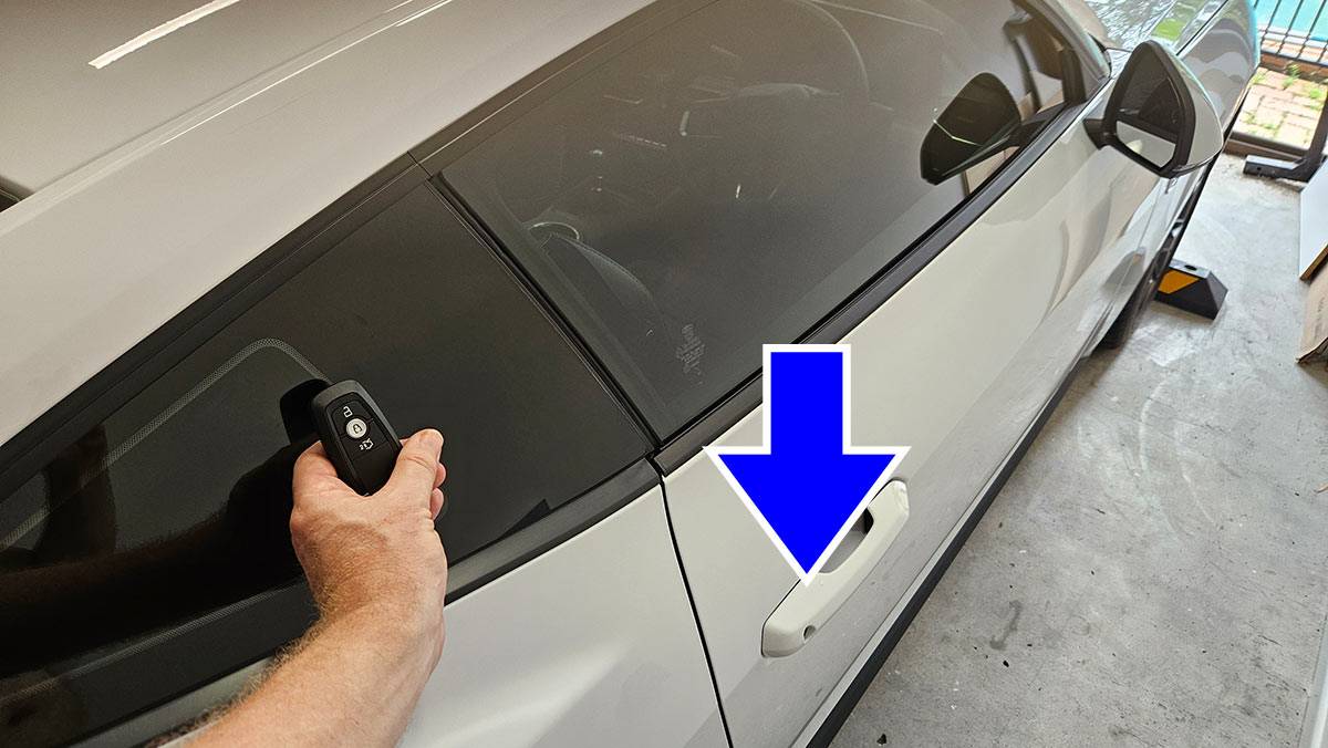

Being my first Mustang, I was thoroughly overwhelmed with the vehicle settings and quirks in the first few weeks of ownership. I learnt what I needed to know, and since then it's been a slow drip feed of learning on an as-required basis.
The thing that annoyed me the most, second to mastering the touchscreen and getting Waze up and running irrespective of what was on the screen, was the dreaded double honk when exiting the vehicle.
I searched on this forum and found an answer that had you holding the key fob by the rear window as you exit and locked the vehicle with the other hand (using a finger on the "lock" door handle sensor).
S650 Mustang What's In ALM's Garage? 20241229_131735_1200
I've been doing this for many weeks now, and it's become 2nd nature, with a 99% success rate.
I was about to load up the car with cameras and head out to a nearby industrial area (today being Sunday, nobody would be around to annoy with horn honking) to shoot a video on this.
For some unknown reason, for the first time in two months, I started poking around in the vehicle settings again, and found this...
S650 Mustang What's In ALM's Garage? 20241229_122721_1200
My searching on various Ford forums weeks ago led me to believe it couldn't be disabled, unless using Forscan, which is why I hadn't bothered with the settings since.
Hopefully this means no more double honking - I absolutely hated that.
Any imbecile who needs that feature should consider taking the bus instead.
Hence, feeling stoopid I didn't find this 11 weeks ago. :facepalm:
