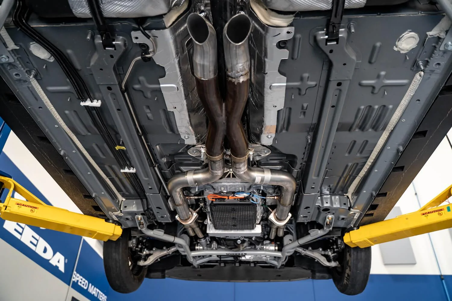

Bullets with turndowns right after the X pipe
Who makes those or is that a fab shop type of thing? I don't think I would run them for visual reasons but still curious.

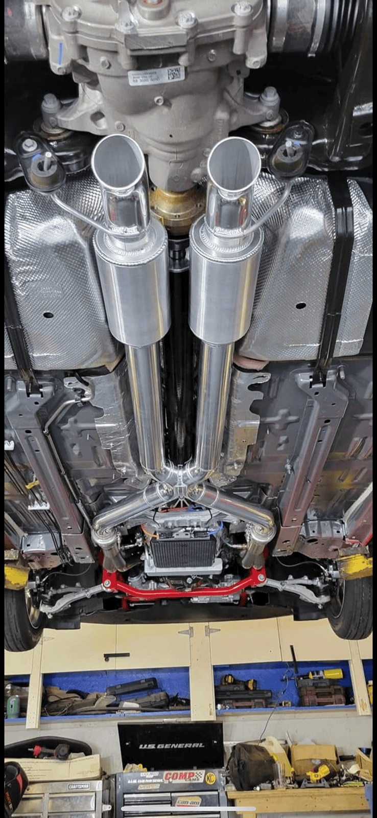

Robvas nailed it, that or herfurth aluminum HARM kit, here is boschmas harm, and steedas x dumps

Tailpipes appear to be awfully close to the rear diff and they get hot as it is, more could be troublesome.
4,856
2,679
That would be my only complaint, gotta watch the aim or have them as electronically controlled dumps and otherwise [quiet] as a church mouse officer, i think he went that way ….
4,856
2,679
Or this x, add a small h (half size of pipe) at the turndowns (or keep the dumps but make electronic?) and then back to active cans?
