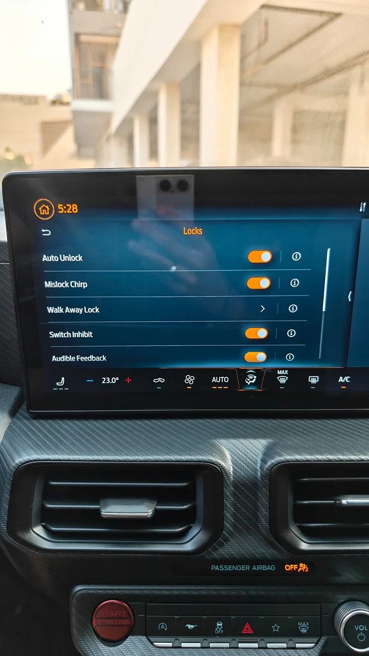

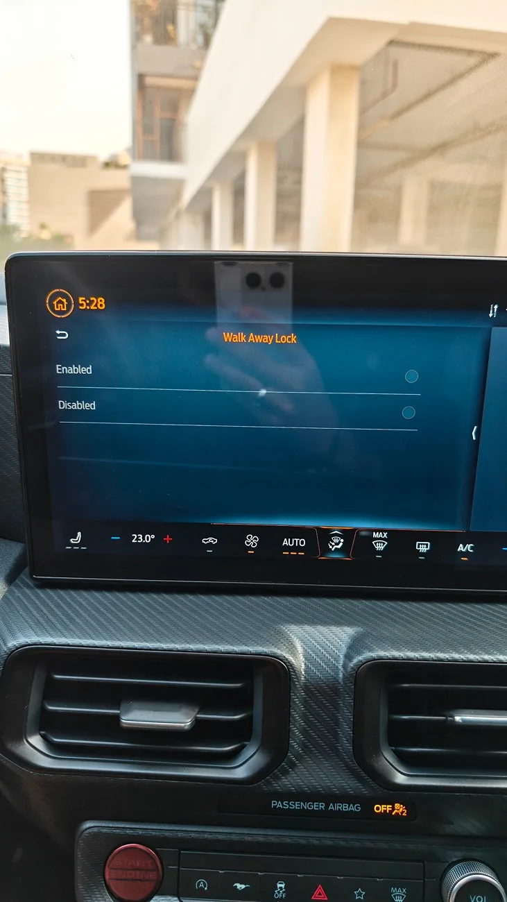

if i remember right, walk away lock has a bug in it where even if you enable it, if you turn it off in SYNC you can only turn it back on by going through FORScan
So the bug is just the toggle on/off, not the function itself?
I might be missing something then because the options are greyed out for me. Would love to have this.

I was following this thread, wanted to enable in my 2024. With the image above, the APIM letter in 7D0-09-05 is C where the * is: xxxx Cxxx xxxx. Found in another thread, worked for me.
