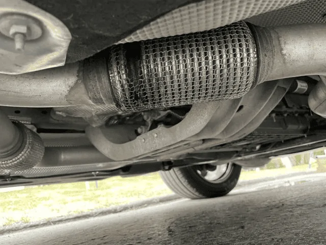

Sounds like to me its the cheap Ford flex pipe, on my Explorer the flex pipe section is a corrugated metal with a metal mesh on the outside, corrugate flex section rattles like crazy. Bad design, not sure if the mustang has the same type of flex section. Found the image below online, not my car.

The section of Flex pipe is very small on the mustang. Not saying it isn't that, it's just a lot of noise for something so small.
That could be it.
It does sound like a very tin like noise. Like very thin metal thats just pinging instead of absorbing the noise.
