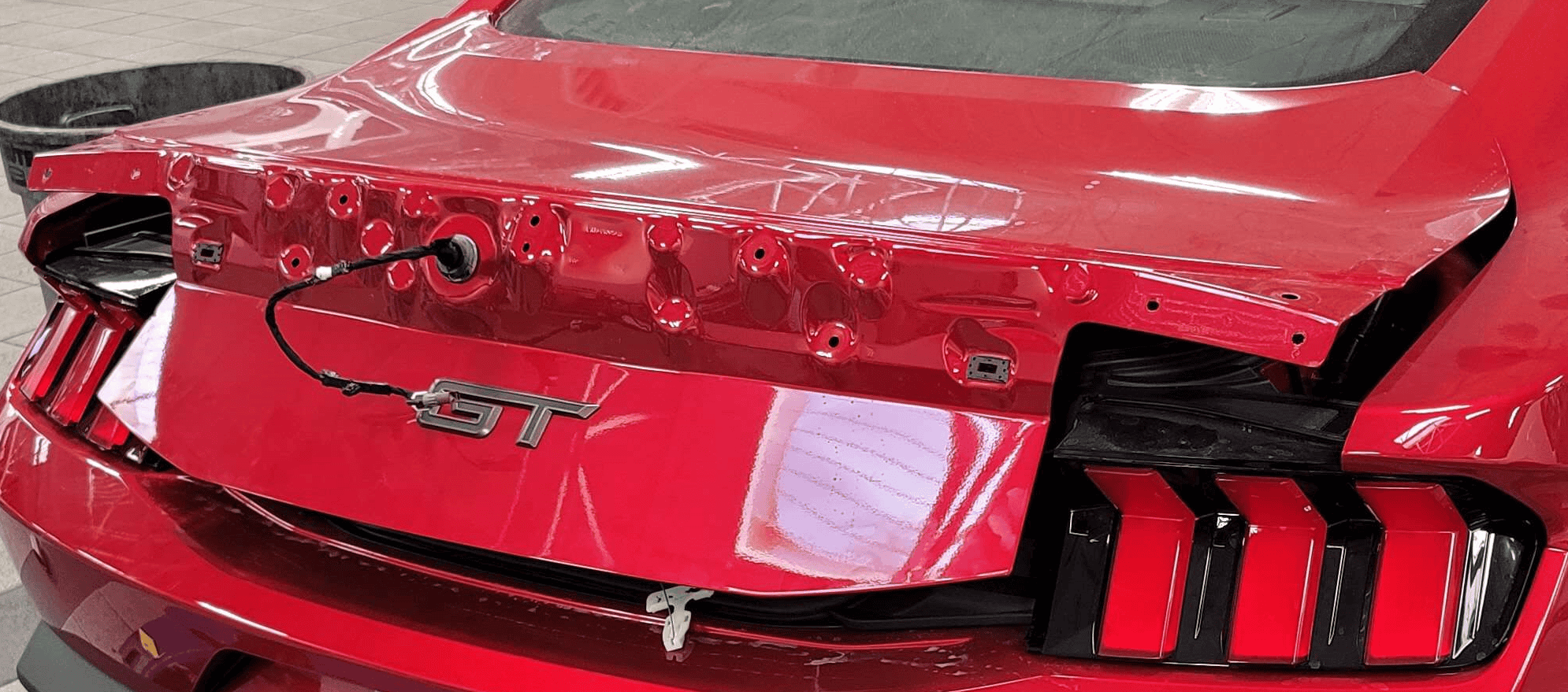

Ford changed how the wing and back-up camera are mounted to the trunk lid. no longer is the trunk lid one piece, but now it's two pieces, with the main lid and the extension. here's how the trunk lid looks without the extension
S650 Mustang Trunk seam? 1700287097142
(this Mustang was in the shop because fresh of the transporter the backup camera was horribly skewed and misplaced)

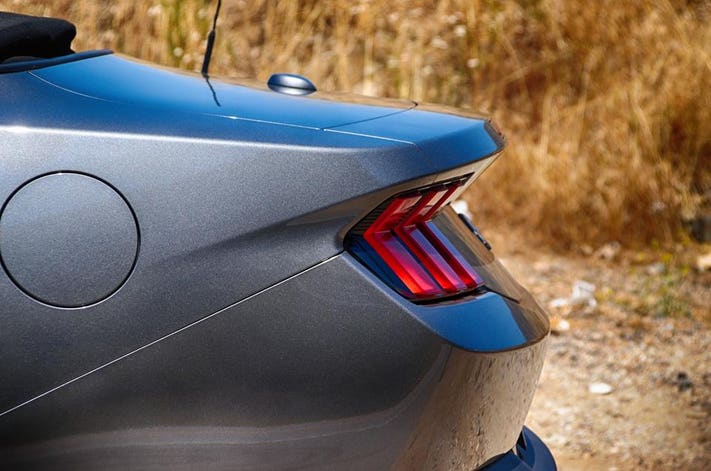

S650 Mustang Trunk seam? 960x0

Looks better than a shopping cart handle stuck on that doesn't perform any real function.

Agreed, but why the seam? A one piece trunk wasn't an option?

Metal can only be bent so much and complex shape might bunch the metal up or over stress it. They would prefer to use a single sheet of metal but that isn't always possible. When that happens, they spot weld metal together or use a filler part to produce the correct shape.

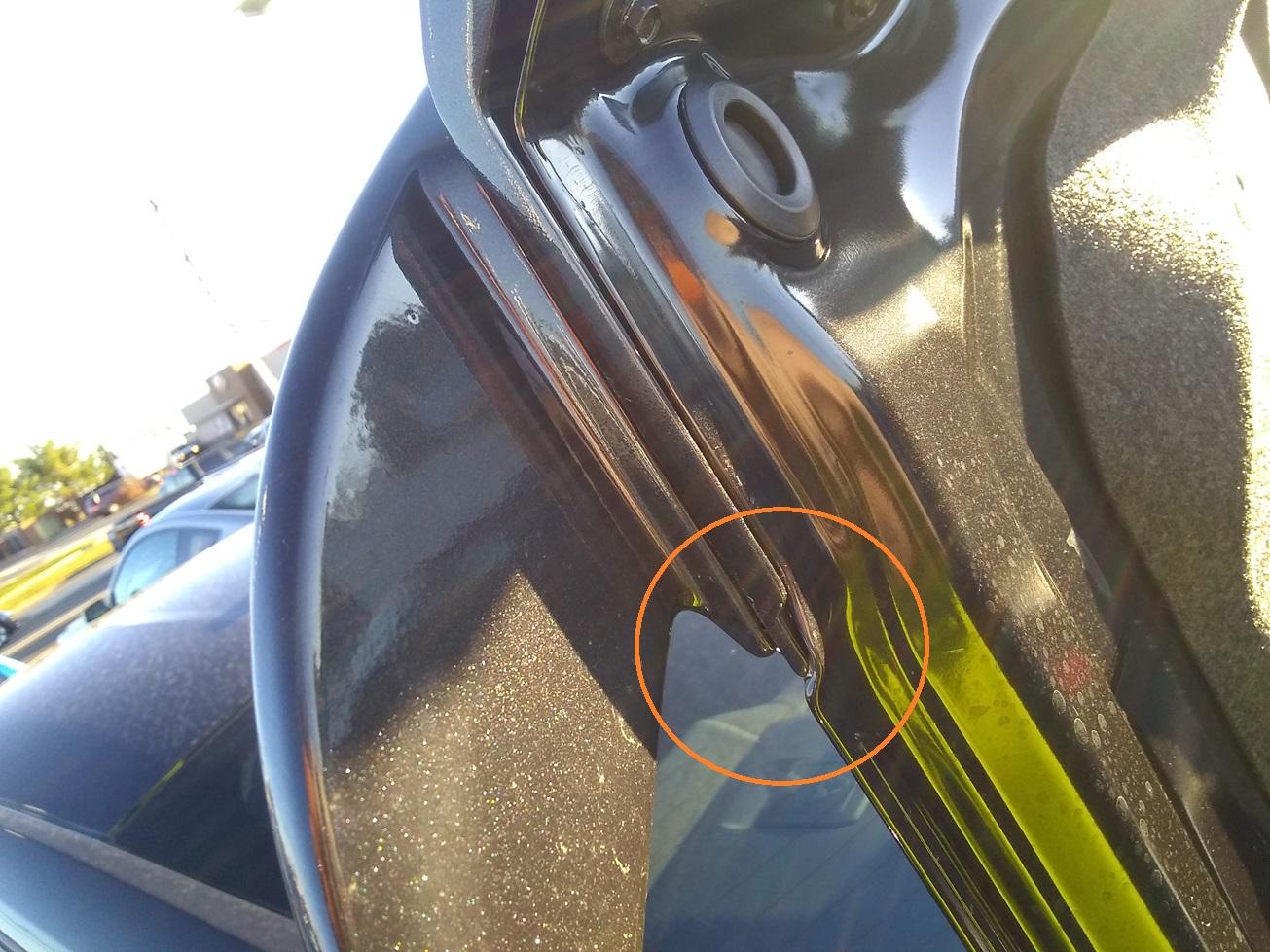

I am not a fly on the wall at HQ but I bet they (design team) couldn't figure out what shape to make the trailing edge and so punted. If you look at the pic of the red one, you can see that the bends are all reasonable and straightfoward press/draw operations.
So while the art department tried to figure out (focus group?) how much of a Elantra cut-back people wanted, if they wanted a S550-like upturn, or any other design elements, they decided to get the big die made and could experiment on the side.
Notice how it's 2 parts butted up and bolted together. There's likely some adhesive in the overlap as well.
Cars with spoilers the leading edge is shy of the channel by about 5mm which IMO is a mistake - it should COVER the ghastly line. But with 1/2" worth of plastic you won't see it from certain angles...
S650 Mustang Trunk seam? IMG_20231118_155221241
Whatever the true cause, the Ford styling/art department should be fired and the decision makers who signed off on it, should precede them into the darkness of banishment. Even furniture designers aren't this bad at their jobs.
The acres of yuck black pastic (diaper) around the entire rear-end is probably there for similar reasons. They were playing with the design till real late and since plastic is dirt cheap finished off the contours that way rather than try to do it in metal.

but to me it is just a blemish on the rear end
agreed. I can understand if the aftermarket wanted to be sloppy, but the factory panel should butt right up, ~1mm gap definitely no more than 2mm. Not 6+.
