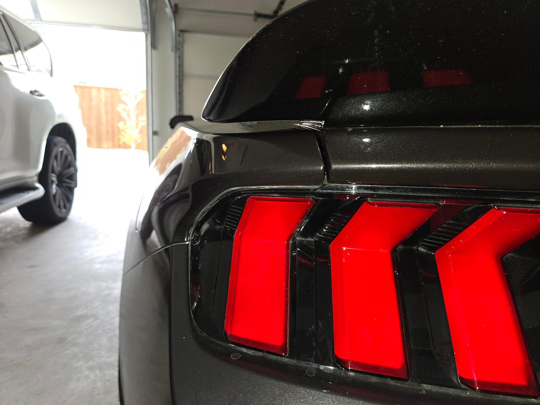

So trying to not start a whole new thread. Was installing a new spoiler, and noticed an uneven line on passenger side afterwards. I know about the rubber standoffs where you can move them in and out to adjust. But is there anything else to use for alignment/adjustment of the decklid? Drivers side is close, maybe a little low, and passenger side is definitely higher than line of rear quarter panel. I've maxed out adjustment of standoffs so that doesn't help.
