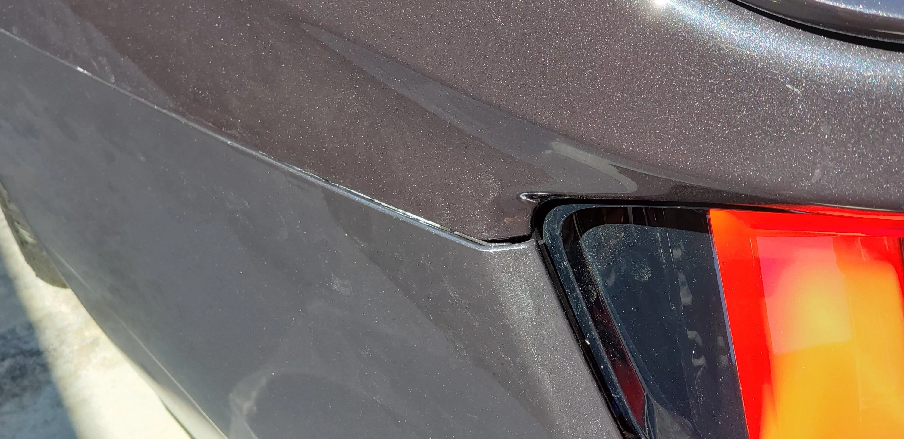

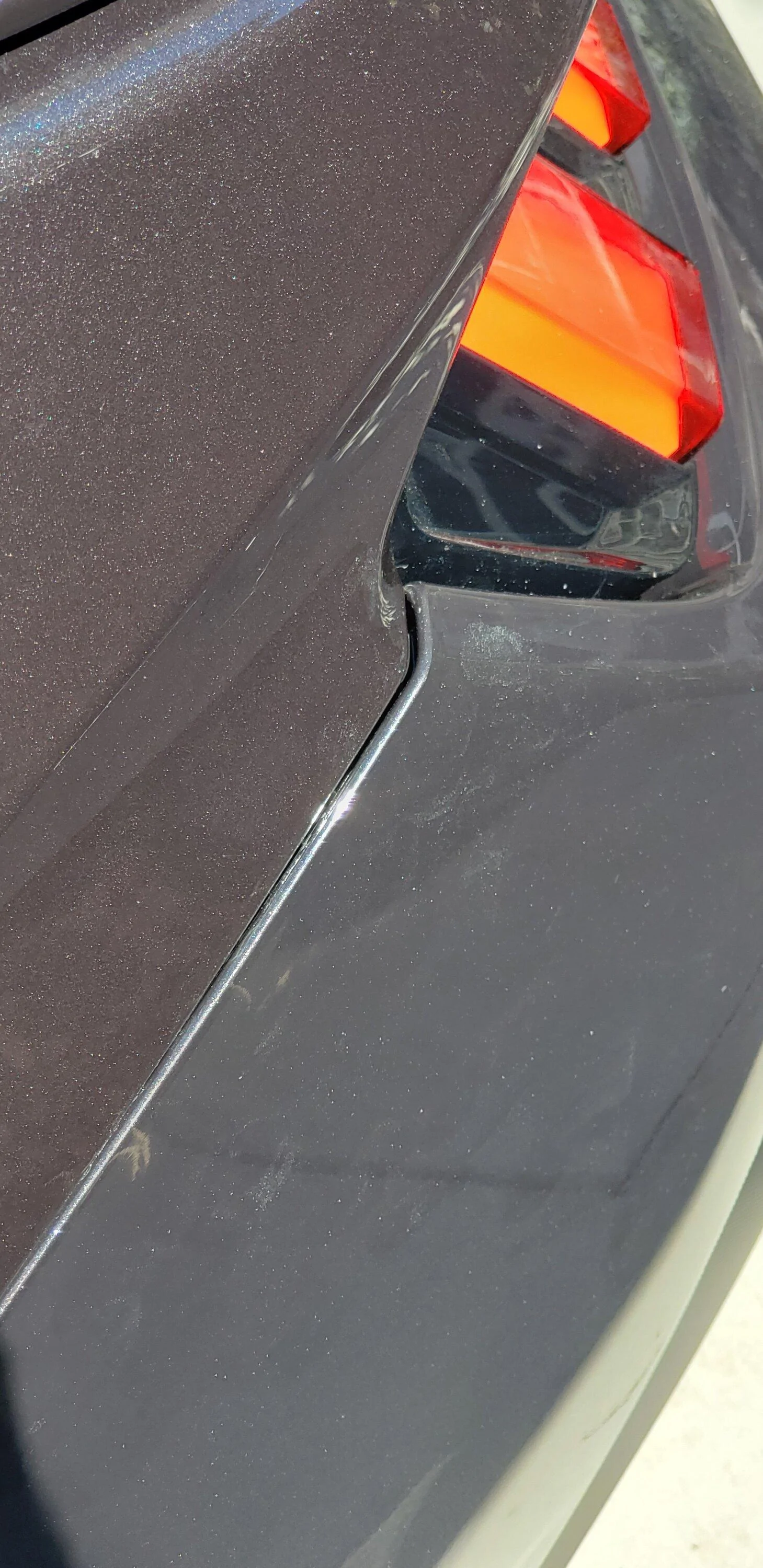

Hey all, just noticed something on my rear bumper where it comes up and meets at the taillights. Seems like there is a last clip missing to connect rear fender to the lower rear bumper here, as the back end seems to flex out at the taillight, and not stay nice and tight and in line. If I pull gently on the rear part by the tailight, it does flex out slightly.
Does anyone have this same alignment issue between rear fender/bumper where it seems like a clip is missing on each side near taillight?
Tried to take some pics of what I'm referring to.
Is this something you would address to the dealership to remedy. Obviously always concerned about lengthy time of them keeping the car and potentially making things worse, or if they would even fix it at all.

there is a TSB for this, your dealer will fix it for free.
Great, thanks for the info. Is there a reference number to it I can search for or find? Thanks again.
2,715
4,121
23-2302 is the TSB number
