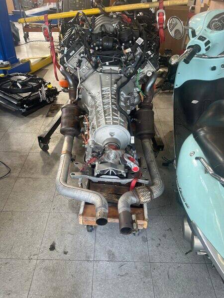

Cheval Bleu engine and transmission…before fix.

yes we have an issue with the transmission over heating at Sears Point under below average temperatures. (55 degrees to 65° ambient air temperature…
from cold pits the transmission is overheating within 13 minutes while short shifts stay under 6,000rpm & shifts between 5-7gears.

Hello all- yea AI helped out by pulling all possible info available on the web…truth be told my mechanic Tony aka(Fix It Again Tony) pointed it out to me as the engine had to come out to replace the right front clip since I hooked it into the tire barrier on the outside of Turn 1 when I pointed a faster big winged car by on my inside and lost all the air on my car and lost the downforce @ 123mph.
we are adding a large 20” x 14” x 6.5” fanned cooler(thx Jegs) in front of the radiator to cool the transmission. Then on top of that we are going to delete the cats(thx Team Beefcake) for good measure.

Based on the picture alone, I can see how the proximity of the cats to the trans could add heat to the trans. Whether that’s an issue or not, I don’t know. Makes me think.

-The work on resolving our Dark Horse Automatic Transmission overheating issue is almost complete. Our recorded best lap from earlier this year at Sonoma Raceway, on the 2.52-mile configuration, was a 1:43.3 on the 5th heat cycle, using Toyo RR 295/30/19 tires, square, mounted on handling package wheels. Our car is a base model with correct front adjustable camber plates from Ford Performance.
-This was a laid-back lap, short shifting at 6,000rpm and only using 5th, 6th, and 7th gears. This gentle driving approach was necessary to prevent the automatic transmission from going into the red and causing the car to enter limp mode.
-COMPLETED WORK on the 10-speed automatic quasi handling package base model.
1. Removed both Cats and replaced them with equal-length headers purchased from Beef Cake Racing. (The cats were sandwiching the transmission and could reach 1,600 degrees, and were darkly discolored from excessive heat.) LTH claims a potential gain of up to 70 hp from their high-performance track-only headers.
2. Removed the thermostat valve that only opens at 180 degrees to allow transmission fluid to flow through the air-to-fluid auxiliary transmission cooler.
3. Removed the OME air-to-fluid auxiliary transmission cooler and replaced it with a larger one (not as large as the one described in a post above) with a 650cfm fan and mounted it with custom-fabricated aluminum brackets tied to existing bolt holes from the factory and positioned it in front of the AC condenser radiator coil, which is located in front of the engine coolant radiator and fan.
4. Installed a transmission cooler fan “switch” inside the driver's cockpit, which will be flipped on as soon as we fire up the engine on pit road.
5. Lastly, we are replacing the two OME cone-shaped air filters with the blue Steeda ones that they claim improve torque by +2lbf-ft and +3hp throughout the entire rpm range during a 3rd gear pull on their dyno up to near 7,000rpm.
