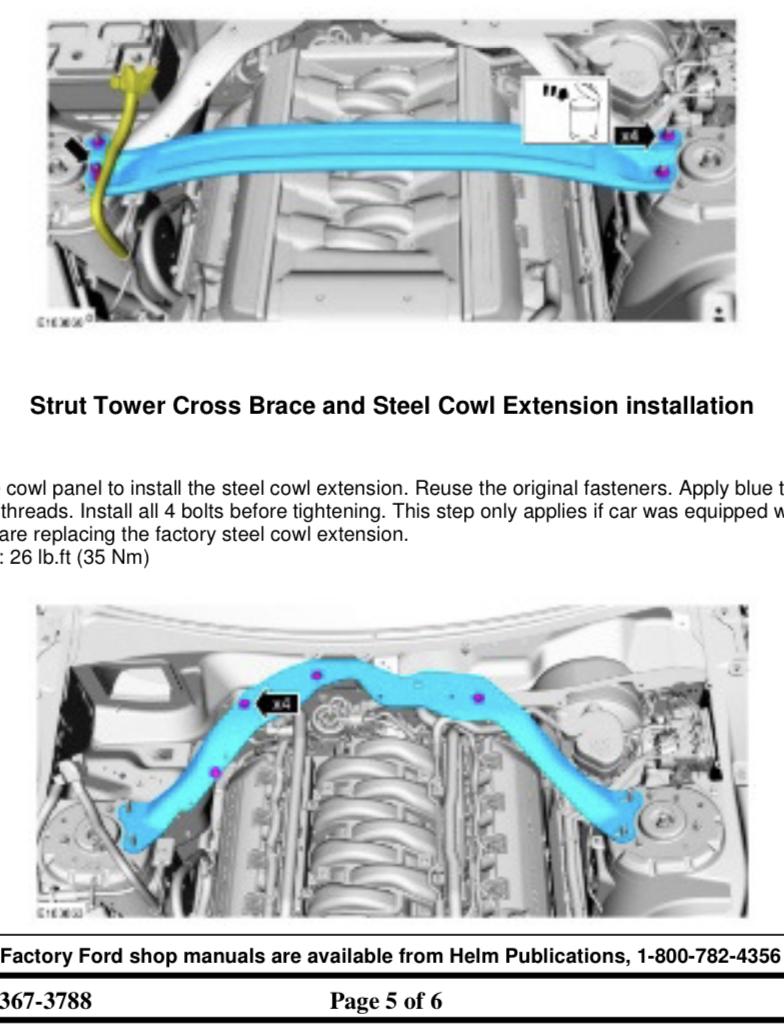

K brace is the member that ties the front subframe from side to side under the car right?
No, I’m referring to the black piece in this picture. It bolts along the cowl under where the wipers attach and then to the strut towers. I think you’re thinking of the K member which is the cradle under the engine and ties in the lower suspension.
S650 Mustang Strut Tower Brace Included with Non-PP GT? IMG_7684
Here it is installed in the lower image:
S650 Mustang Strut Tower Brace Included with Non-PP GT? IMG_7685

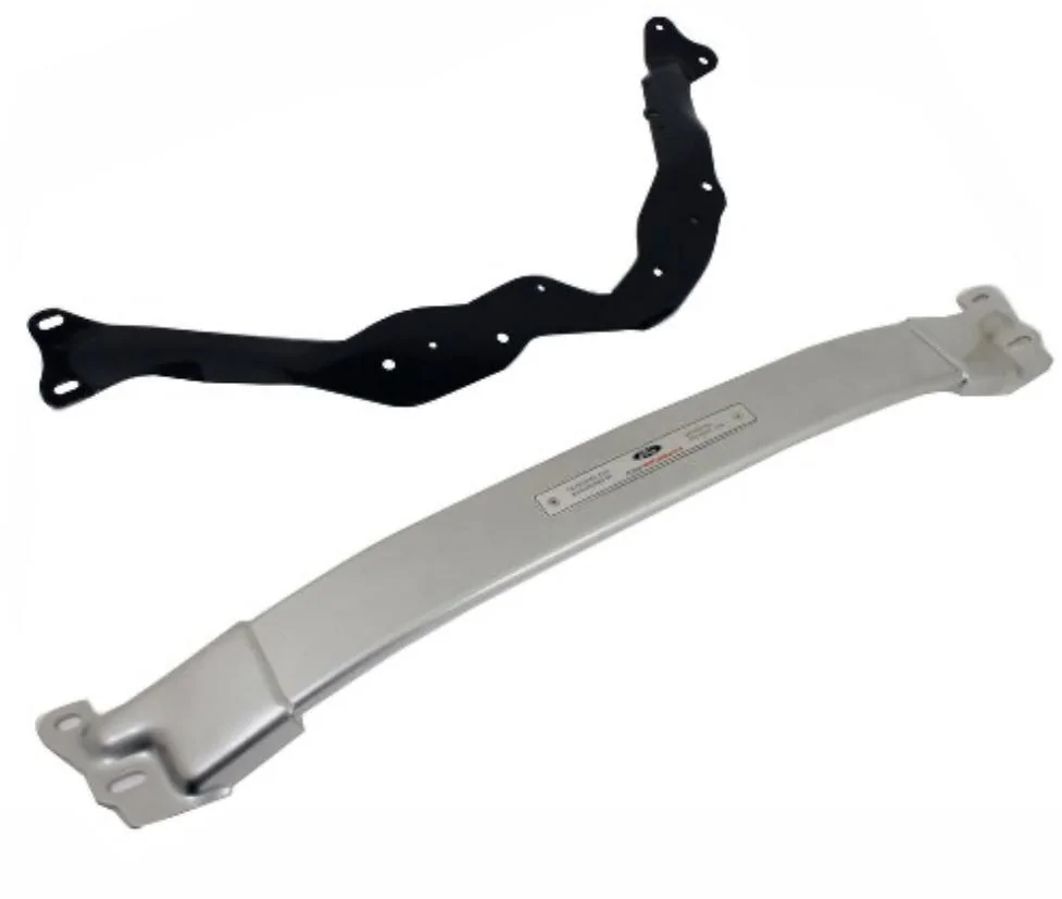

https://performanceparts.ford.com/part/M-20201-GT350
Ah yes, thanks.
Looks both parts are $220 and quite simple to add, not a deal breaker.
My 2024 GT 401-A with the Active Exhaust without the performance package, I added the strut tower brace. The black piece in the picture on my 2024 Mustang GT was made out of plastic.
When the dealer installed my new strut tower brace with the new black piece in the picture is made out of steel. They’re both very heavy.
Both pieces of mine are black and on the STRUT it says “Ford performance”.
