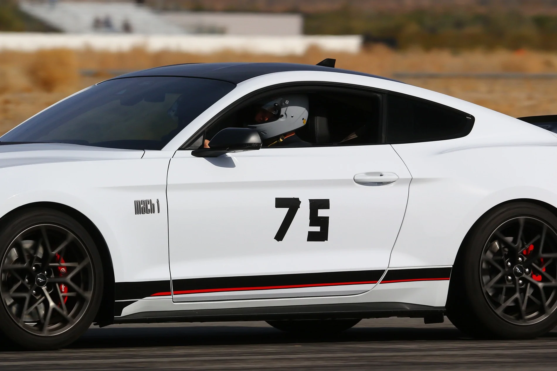

You don't need the rear upgrade for track use.
All the Mach 1s had the 6 piston fronts and 1 piston rears. It is plenty for track use. Trust me.
S650 Mustang Still No Aftermarket Brake Kits Available? CVR_3677_Mar1525_926PM_CaliPhoto
