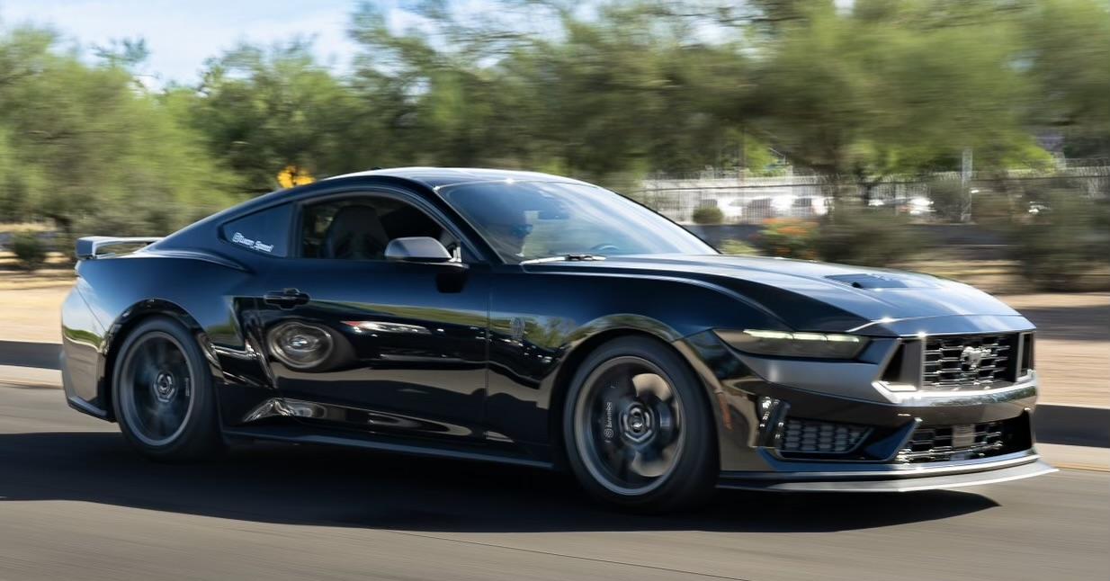

Looking to install some suspension mods before the whipple comes in. Looks like these cars share the same wheel hop issue as the s550.
Curious if anyone has a preference of steeda over BMR or the other way around. And why?
looking to add things like the subframe alignment kit, front and rear sway bars, end links.
happy to hear other things that people are running on their s650 - suspension wise.
currently running the steeda dual rate springs on my DH.
