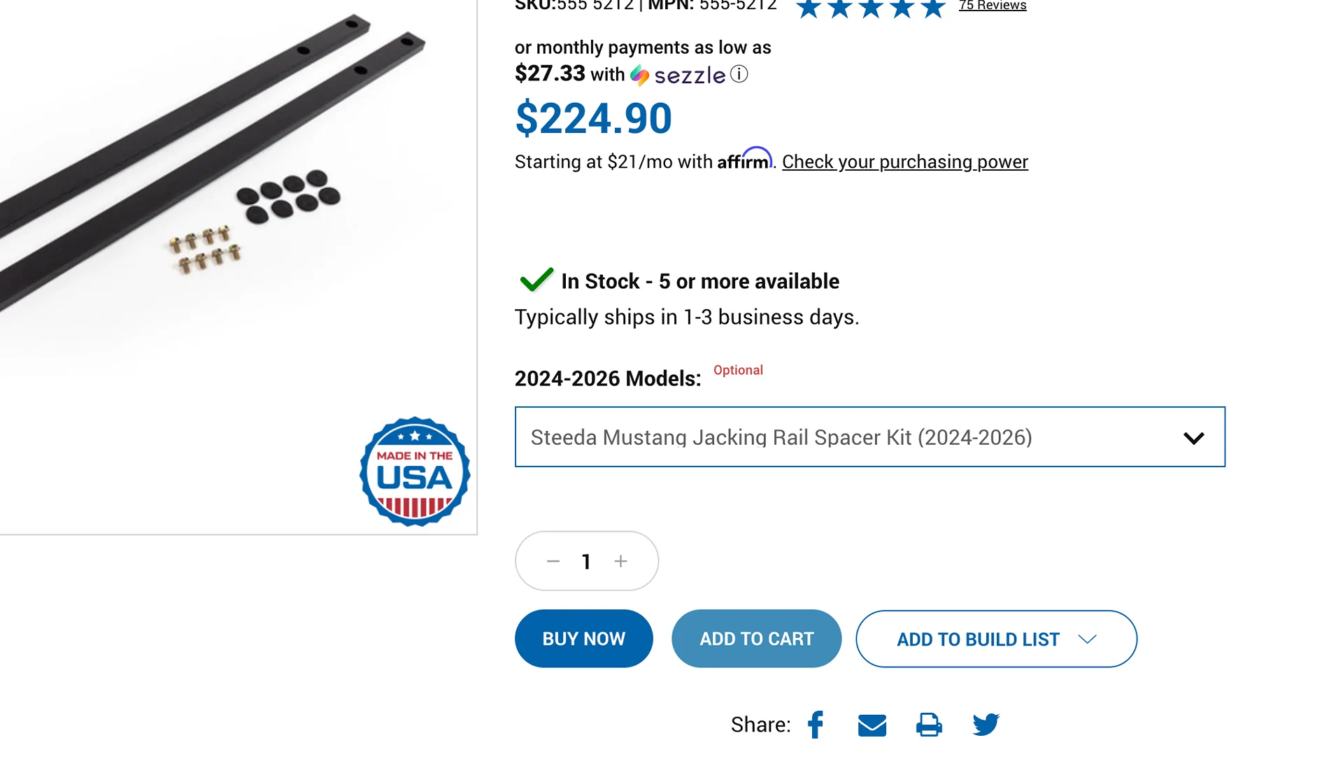

On our website, we advise the following:
Note: S650 Models require the optional spacer kit to ensure jacking rails are level.

And how does one go about getting a spacer kit when they purchased the jacking rails before the spacers were available?

So wait. I was sold these without the option for any spacer kit. Is that why they don't sit flush?
Give our sales team a call at 1800 950 0774 & they will review your order to discuss next steps.
As Sergio mentioned earlier on:
You don’t actually need the spacer for installation.
Our jacking rail fits the S650 perfectly. On the S650, you’ll notice the front of the rail extends about 1/8" past the pinch point, while the rear sits flush—this difference is due to the frame being slightly different from the S550.
If you use the 555 5213 spacer, it adjusts the fit so that the rear of the rail protrudes the same amount as the front.
Running the full-length rail on an S650 without the spacer gives you a setup that’s a blend between the full-length and low-profile versions.
@Steeda-Sergio can help with further clarification.

The coupes get 2 spacers, one on each side, in the rear for the S650.
The Vert has a factory brace in the way, so we use 4 spacers, 2 on each side, for them.
When you use the factory pinch welds with jack stands, you’re only supporting the car on a single small contact point at each location. Our kit engages the full length of the jacking rail, maintaining complete support while incorporating two rear spacers for proper fitment.
Let us know if we can help assist further.
