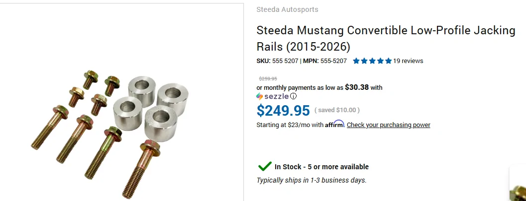

The convertible has a different part number on the Steeda site. Oddly, the convertible version comes with the spacers and the coupe version says
" Note: S650 Models require the optional spacer kit to ensure jacking rails are level.
The pictures on the vert version also show the spacers where the coupe version pictures do not.
https://www.steeda.com/steeda-555-5212-s550-low-profile-jacking-rails
https://www.steeda.com/steeda-s550-...-chassis-jacking-rails-15-17-convertible.html
Translation, we know there is a problem with our product not working/aligning properly on the s650 as we are just reusing the s550 rails and do not want to update the product with the proper equipment to fit the rails to the car as they should be aligned unless you pay us more.

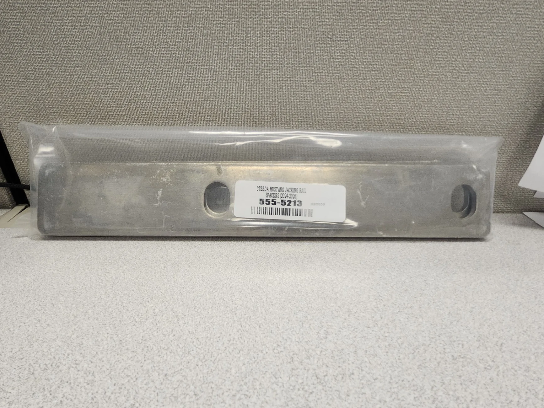

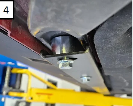

Hey Guys,
Seeing as we don't have any pictures up on what the Spacer Kits look like for the 24+ Mustangs,
I'd thought I'd jump in and help.
As you can see from the images, The spacer kit is a bit different from the Convertibles to the 24+ Coupes.
You don't technically need the spacer.
Our Jacking rail bolts up perfectly fine on the S650.
What you will see on the S650 is the front of the rail will protrude an 1/8 past the pinch point, and the rear will be flush, and this is caused due to the frame being slightly different than the S550.
The 555 5213 slips in and makes it so the rear protrude the same amount as the front.
The Full length on a S650 without the spacer is like having a hybrid of the full length and Low profile.:)
