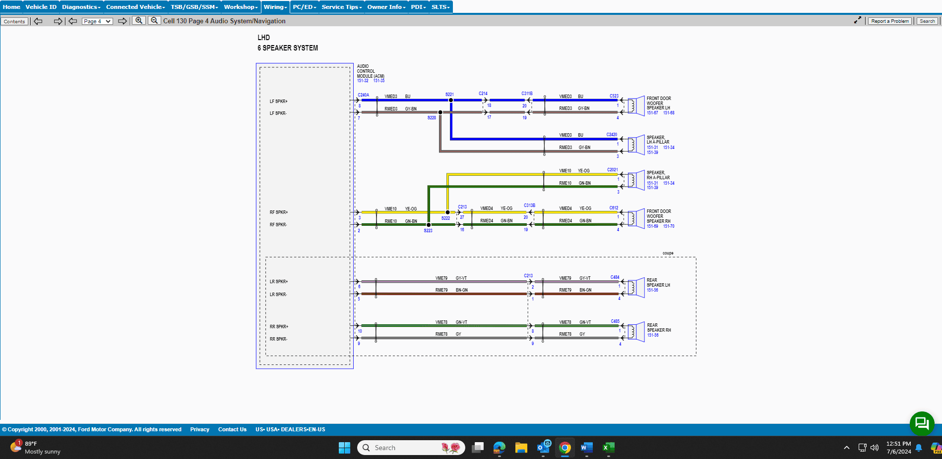

S650 Mustang Speaker Sizes 1720284751411-xc

That schematic shows two door woofers and two pillar tweeters, I think I have two door speakers and nothing in the pillars.

Some googling of the very limited amount of info that is out there shows that the door speakers are woofers only, not 2 or 3 way speakers, and the uppers, regardless of location, are only tweeters.

Yea, there is very limited info on the 2024's out there. Crutchfield hasn't added the S650 to the database yet. I think I remember you mentioning that you work at a dealer? The parts counter should be able to get you the part numbers for your speakers and compare them to the previous year. If they are the same PN, then it would be 1" tweeters and 6.5" or 6.75" for the door and rear decklid.
I did something similar in my truck to what you want to do. I would recommend you add some bass-blockers to the tweeters. Based on the diagram above, the signal the ACM sends to the front tweeters and the door speakers is the same.
