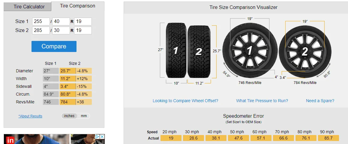

Besides the fender gap (that can be lowered and speedo) would it be a bad idea to get smaller diameter tires?
Stock = 255-40 with 3.55 gears
275-35 Final ratio = 3.61
285-30 Final ratio = 3.73

S650 Mustang Smaller Diameter Tires to Boost Final Ratio Screenshot 2023-08-03 101338

Does that show about a half foot less per rotation?
Yes, about 4.1 inches less, which equates to about .05 mile less for ever 1 mile on the odometer or about 5 miles every 100 as can be seen with the speed chart under the tire images

Car is lowered 0.6 inches.
Braking should be better.
Rotational inertia decreased in tires.
Smaller sidewall will feel bumps a bit more.
Fuel economy will suffer.
Speedo will be off by a few MPH, not the end of the world.
70mph on the speedo will be 67mph in reality.
Acceleration should be more aggressive in all gear instead.

Yeah I worded that badly, the point I was trying to get across was for every 1 miles worth of rotation the larger tire does, the smaller one only completes .95 miles, so you'll need to push the tire that 5% longer to achieve the goal of the larger tire.
