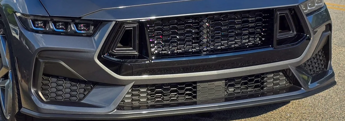

Hey guys,
I was looking at the front end of the S650 and noticed the grill covers on the lower left and right sides. (my car is a base GT non pp) Has anyone here tried removing them yet?
I’m curious if they’re just cosmetic inserts or if there’s functional ducting behind them. If you’ve pulled them off, was it an easy clip/screw job or more involved? Also wondering if removing them helps with cooling/airflow or if it just opens up to a blank panel. I think it would look alot cleaner with both sides open w/o the blanks on the back.
Any insight, pics, or DIY guidance would be awesome!
Thanks in advance.
pic of my cars lower grills for reference:

Drivers side cover is removed for oil cooler. Passenger side has been removed for other applications, Shelby does for some of their builds.

If you remove the blank off on the passenger side you will expose the ugly windshield washer reservoir. Opening the drivers side could cause issues with air needing a place to exit. Seeing as you do not have the PP equates to no oil cooler.

do not remove that left right cover. doing so means you are exposing your washer fluid reservoir and PCM to the open. Shelby is only able to open the left right side because they do a reservoir and PCM relocation

do not remove that left cover. doing so means you are exposing your washer fluid reservoir and PCM to the open. Shelby is only able to open the left side because they do a reservoir and PCM relocation
I think you mean the right side? Oil cooler is on the left (drivers side) on PP cars, correct?

you're right. i don't know how i messed that up, but i did
