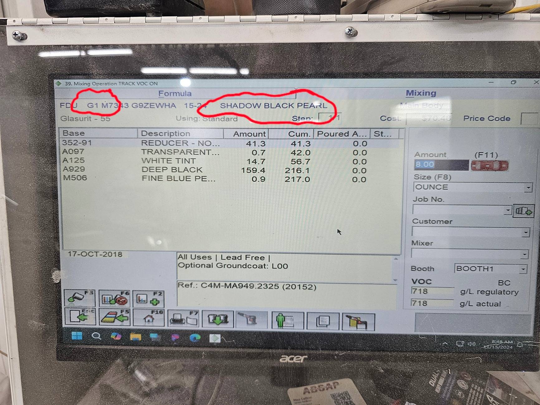

S650 Mustang Shadow Black 20241115_085628
2,714
4,121
G1 Shadow Black Pearl

Very small amount of blue pearl

Shadow Black definitely has what looks like a little bit of purple flake in the paint, so blue pearl would be correct. It’s only visible up close, at certain angles, and when the car is swirl free and clean…which is almost never.
