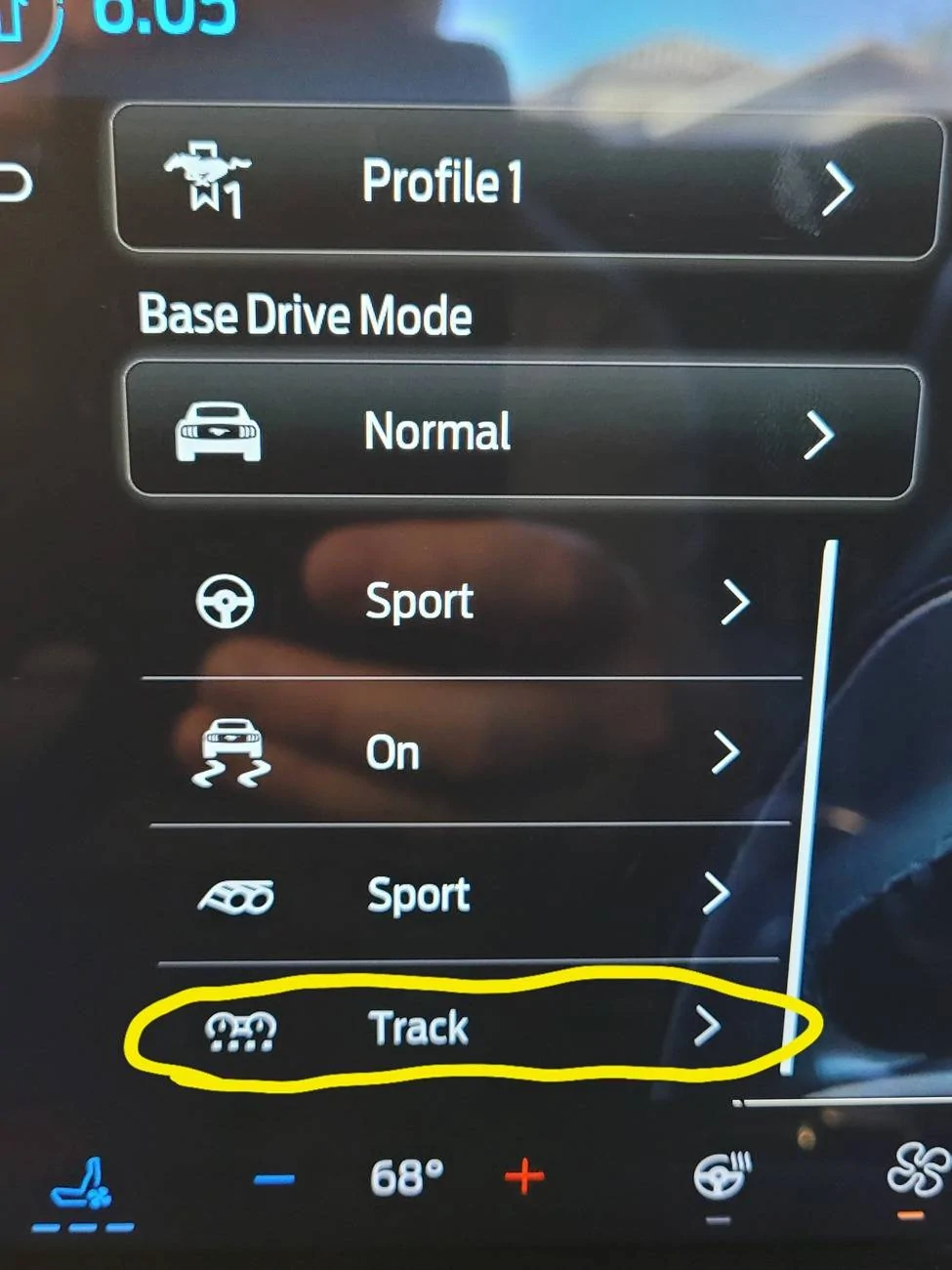

Did you try to save the Sport gauges in the Custom Mode like this? -
S650 Mustang Saved drive mode, Sport mode, no longer being saved 20250723_180517

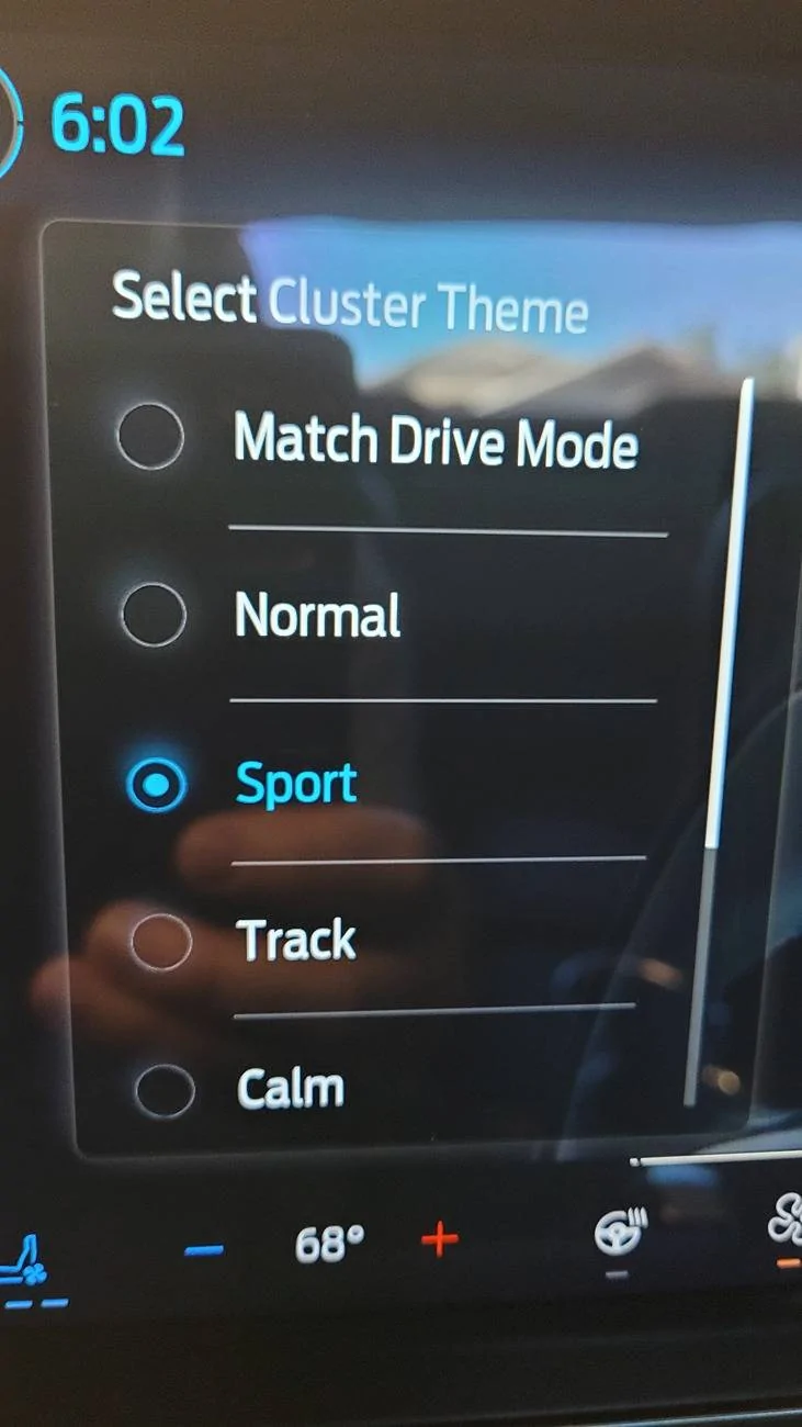

Or did you try and save it the cluster theme menu like this? -
S650 Mustang Saved drive mode, Sport mode, no longer being saved 20250723_180238

Hmm, I believe the bottom picture is how I saved them.
Ok. Mine also does not save after a restart when I select that. It defaults back to "match drive mode". Personally I don't care much as I prefer the different gauges in each mode. But I've always wondered if it's a glitch.
Can anyone else confirm if their settings save when using this?
