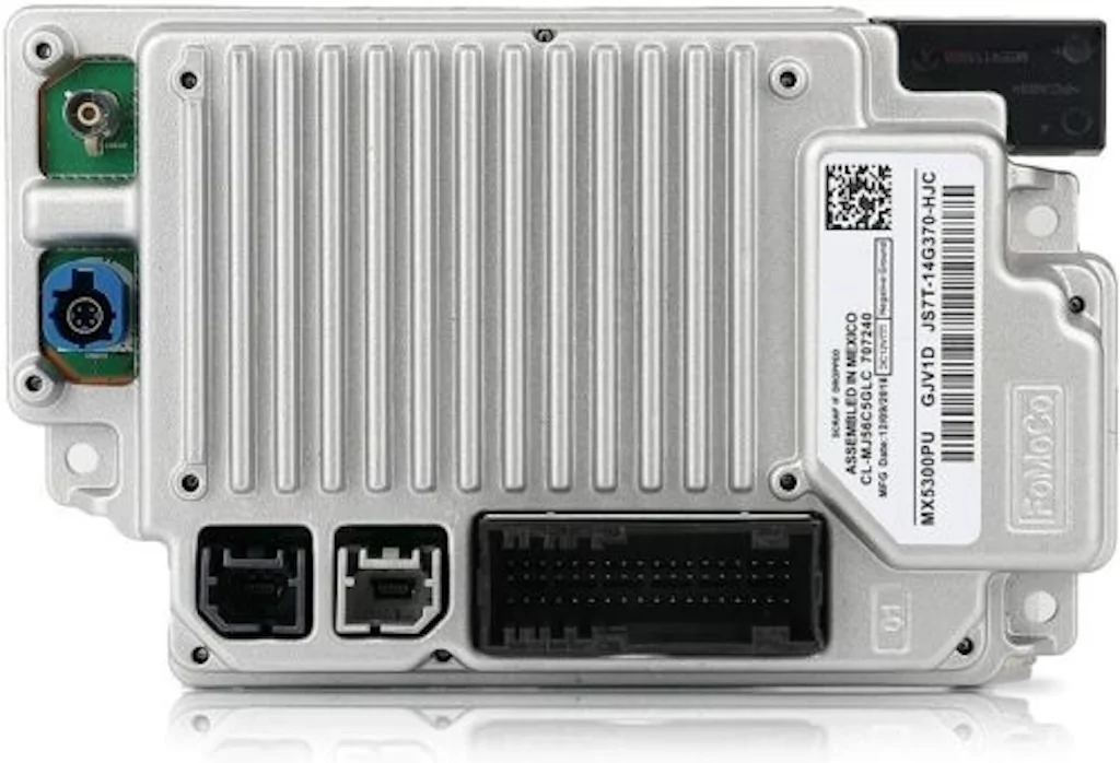

In the dash, supporting all infotainment, is an Accessory Protocol Interface Module (APIM). On the backside of the APIM are several physical ports, one of which connects the shark fin antenna to the receiver (in the APIM).
In several previous threads, body shops have left connectors loose or disconnected inside doors. If they removed the dash, I'd think odds are good there's a connector issue there.
I feel if it were a software issue, that'd be a very specific problem, reported by others as well.
Edit,
Software is easy enough to check. A dealer could hock up, then use Ford Diagnostic and Repair System (FDRS) to check all modules and their connectivity. It'd take only moments. It won't necessarily confirm a connector fault, but they should at least be able to show the APIM is working and has the latest software. This could encourage the body shop to go back into the dash.
It depends on the dealer. One understanding and with time will have someone connect and check quickly. Others, they might charge you a diagnostic fee.
Edit,

Do you happen to know where this module is located in my car?
These videos give a good rundown of what is involved, where the APIM is.
By minute 4 in this first video, they are at the APIM. You'll see the connectors of interest.
This second video is something of a condensed version.
TBH though, you're dealing with a car under warranty, warrantied body work from an accident, insurance, etc. I would not attempt or touch. I appreciate it's a PITA: you're in-between the shop and the dealer. But if you do anything, it gives any of them an oppourtunity to wash their hands of it.
Initial thoughts, you could go about it two ways.
In the first, you go to Ford, pay a diagnostic fee, have them confirm the status of the APIM and services, then take that to the body shop. Maybe any insurer can reimburse you for money and time. Maybe the insurer would pay to have Ford fix? IDK.
In the second, you attempt to reason with the body shop the service was working before and should be working after repairs. You've done the initial checks with Sirius, no one in the 7G forum is complaining of a similar issue, there are no open recalls or TSBs and you need them to double-check.
