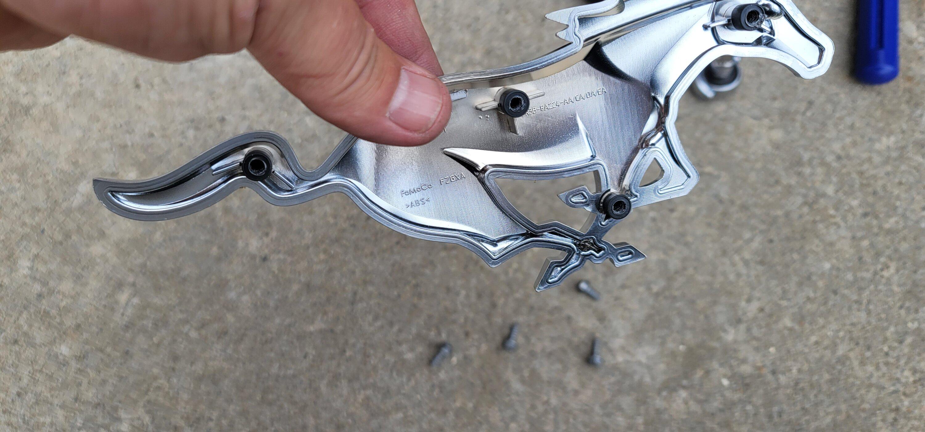

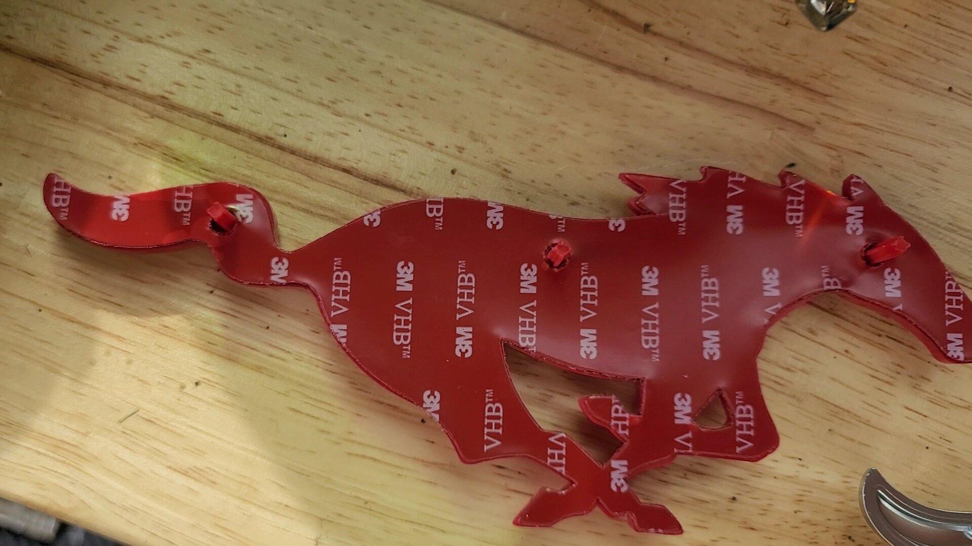

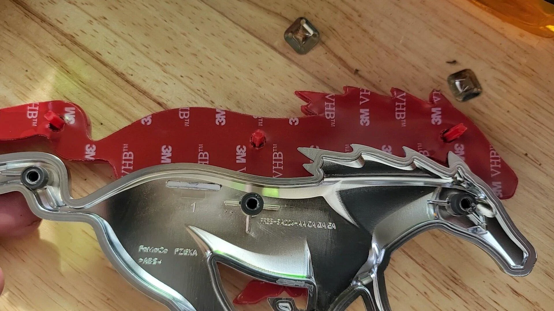

The pony grill emblem on the S650 is slightly different than the S550. As I am finding with several of the parts, Ford made a slight tweek. Just enough of a change to drive you crazy! The biggest difference is that the new emblem is held on with 4 5 mm bolts. The S550 emblem is held on with 3 retaining clips and 3M adhesive. I have some pictures posted below. I also made a video describing the differences and showing how to change them out. Here is the link to the video. 2024 Mustang GT S650 Pony Grill emblem
S650 Mustang S650 Pony Grill Emblem Replacement 20231011_145329
Above is the new S650 Pony emblem.
S650 Mustang S650 Pony Grill Emblem Replacement VideoCapture_20231016-111113
Above is the old S550 Pony emblem.
S650 Mustang S650 Pony Grill Emblem Replacement VideoCapture_20231016-111155
Above is a comparison between the S650 & S550 Pony emblems.
