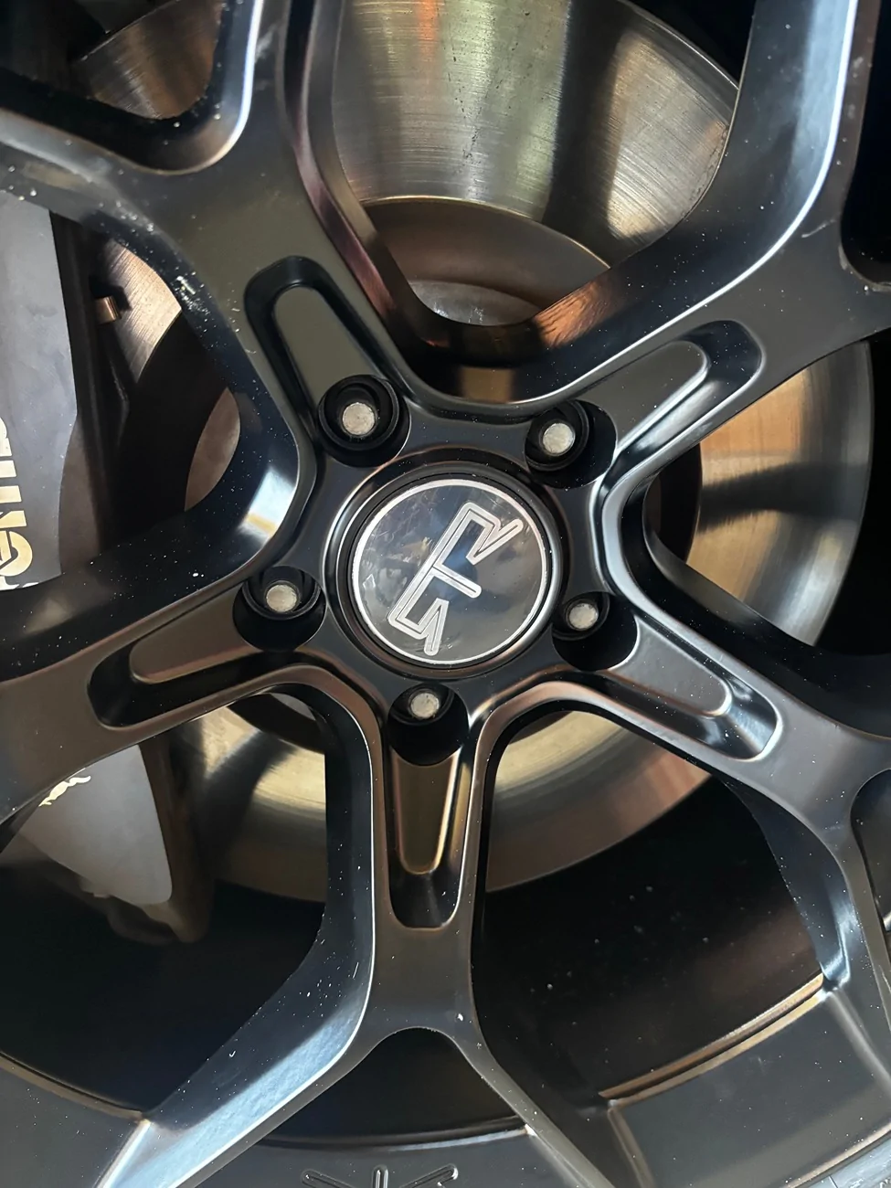

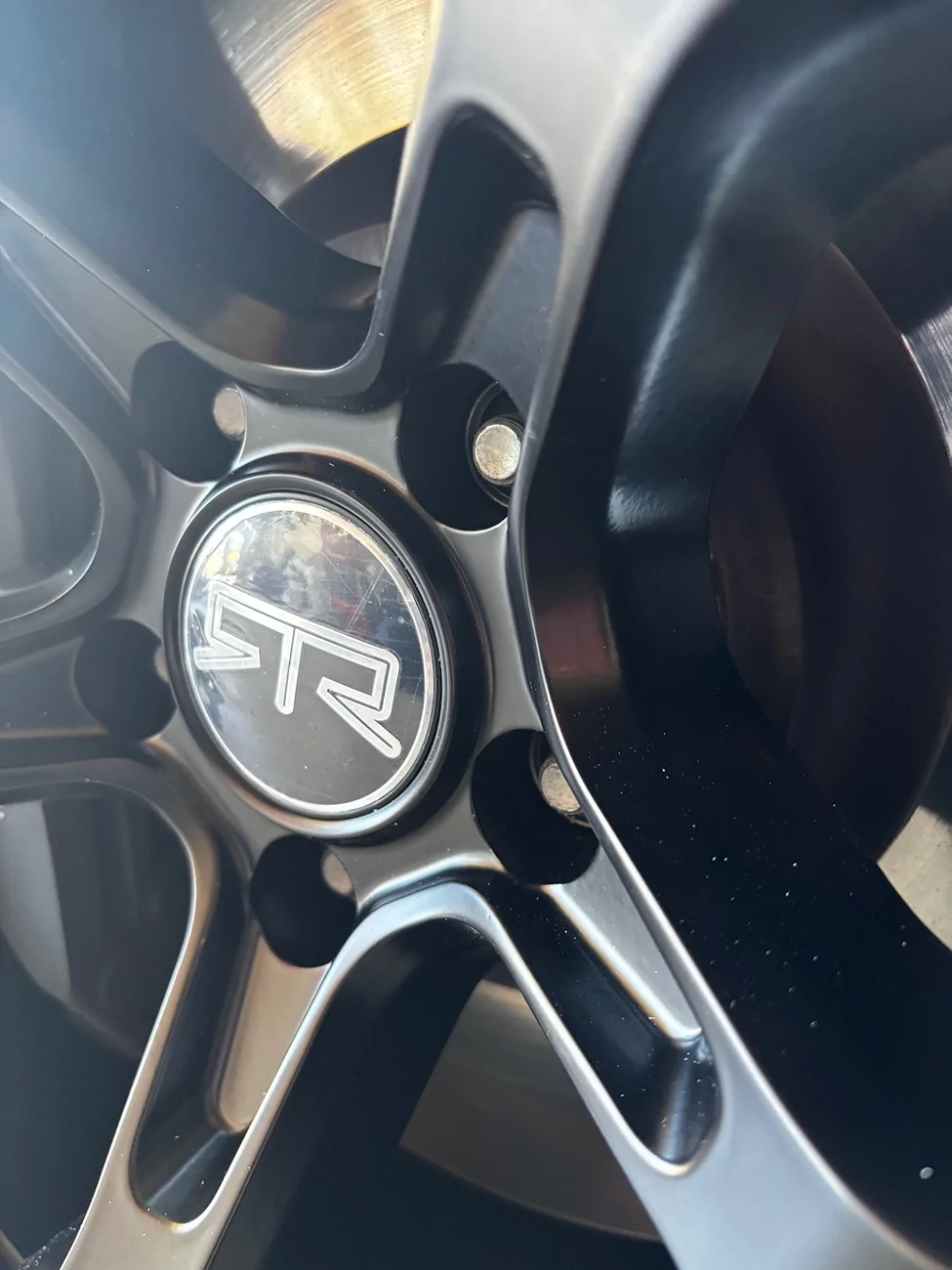

I just got a set of RTR Aero 5 20x9.5 fronts and 20x10.5 rears. Tried putting the front tire on and the wheel studs aren’t even close to being long enough, anyone else run into this and find a lug that works with the nub of a stud?

Are you using the stock lugnuts or the spline drive tuner lugs?

Agreed with @robvas, you need tuner lugs

Hey @mlj32, other commenters here are correct, you'll need to pickup a set of tuner style lug nuts as our Aero 5 wheel is not designed to work with Factory lug nuts. We're sold out at the moment, but the tuner style lugs can be found at most auto parts stores.
