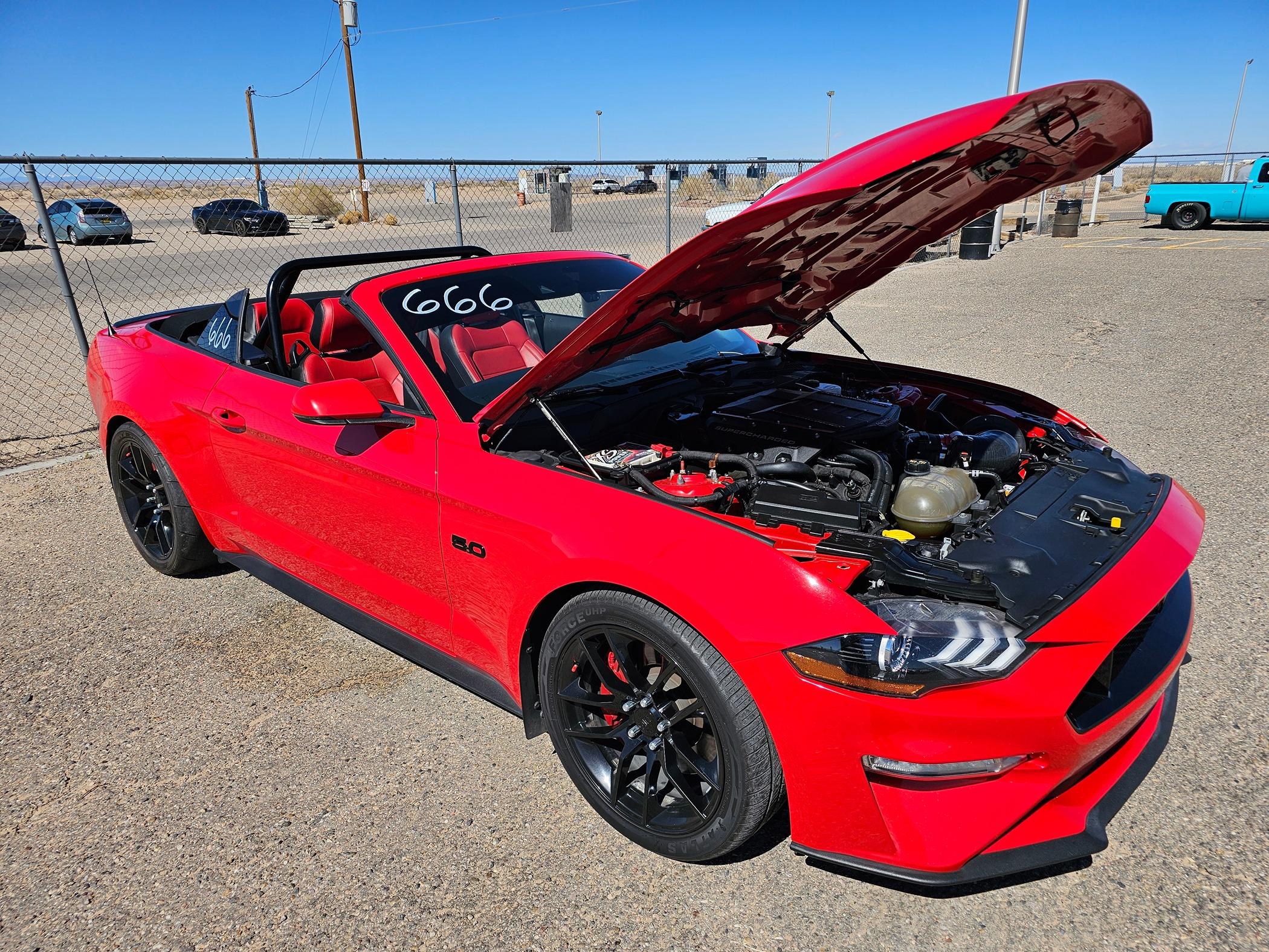

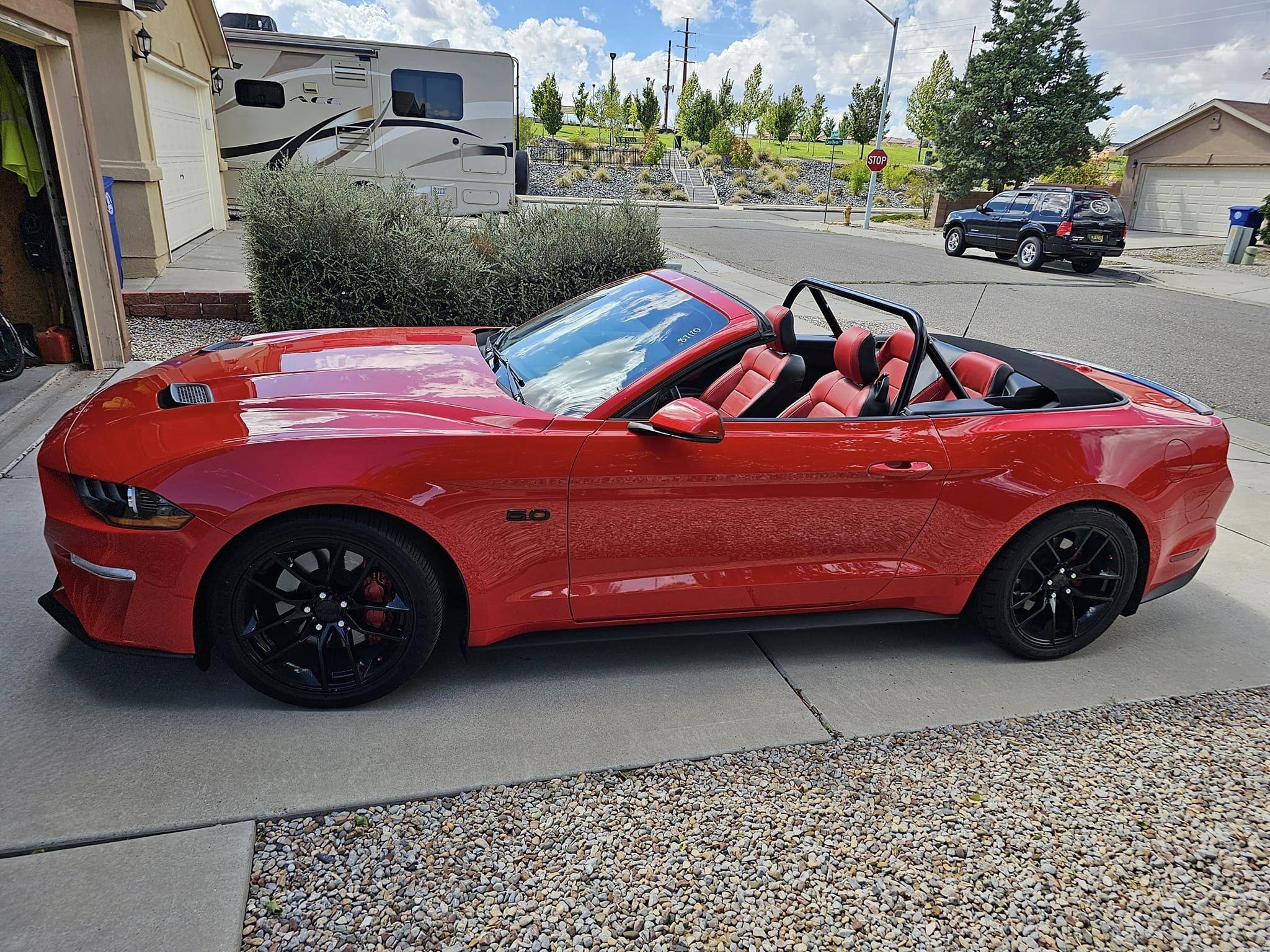

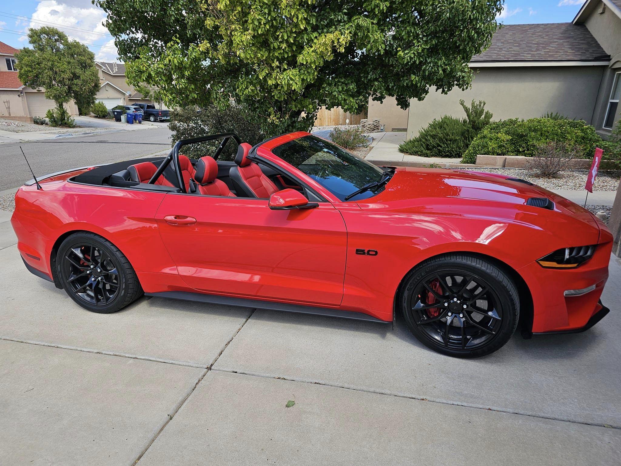

There are several options out there for convertible roll bars for S550's. Watson seems to be the most popular, but there are a few others. I don't know whether they will fit S650's the same way though. If the subframe and suspension are the same, I would think that they would fit S650's equally as well. I have both Mustang versions in convertible form and my 2018 S550 has a nice 4-point bolt-in roll bar. I had to have it to run at the local drag strip. 700rwhp in a ragtop is no joke anyway. Mine is an Autopower model 71265 for 2015 and up Mustang Convertibles. I got it for $585.95 and another $200 or so for shipping. They don't have them in stock. They build them to order, so it takes a couple of weeks or so to finally receive them. Another vendor like Autopower is Kirk Racing in Mount Olive, Alabama. Also very reasonably priced but nothing in stock. They build to order as well. Hope this helps...

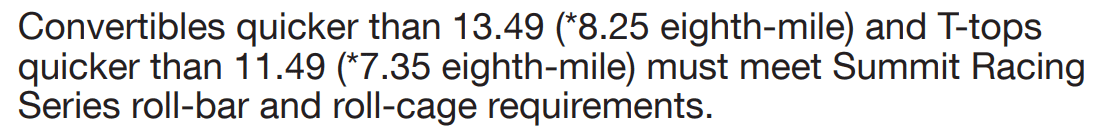

I build cages (among other things), the type of cage you need is dependent on how fast the car is. A roll bar does not satisfy this requirement typically.
On a 2024 coupe you don't need a cage at all until 8.99, sucks that convertible requirements are still so aggressive but I absolutely understand why.
