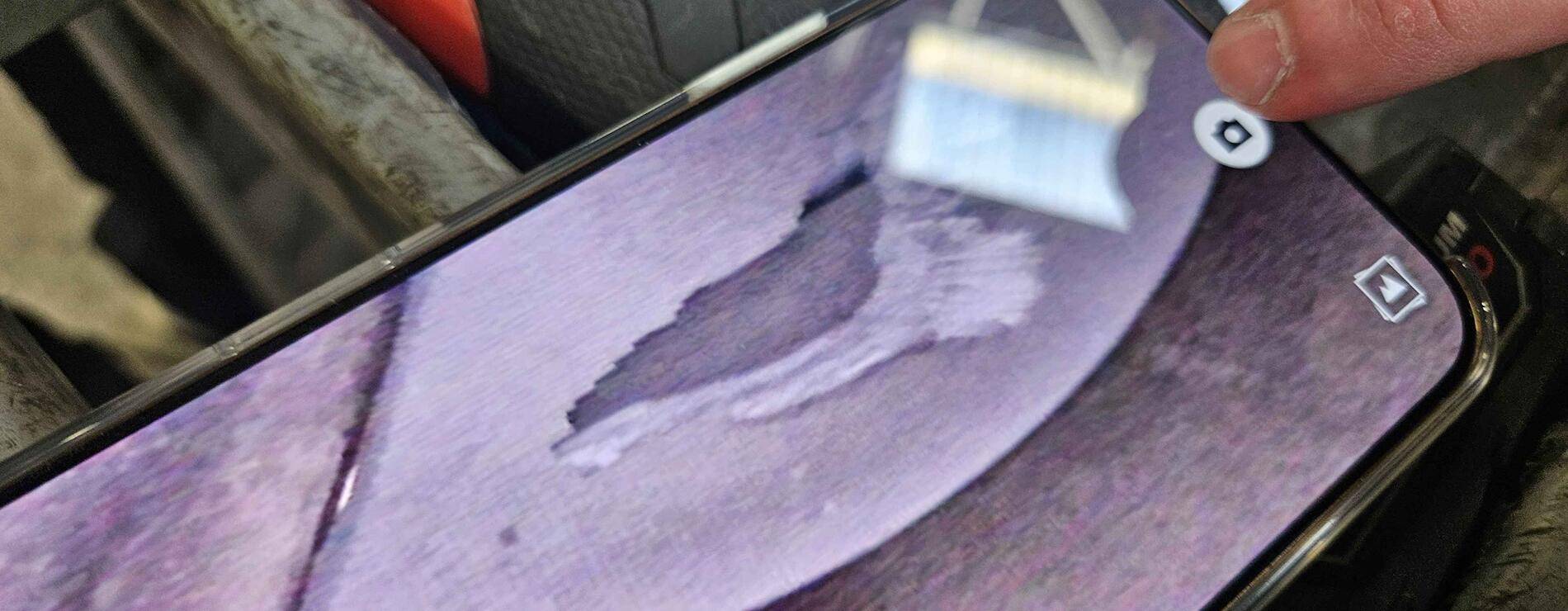

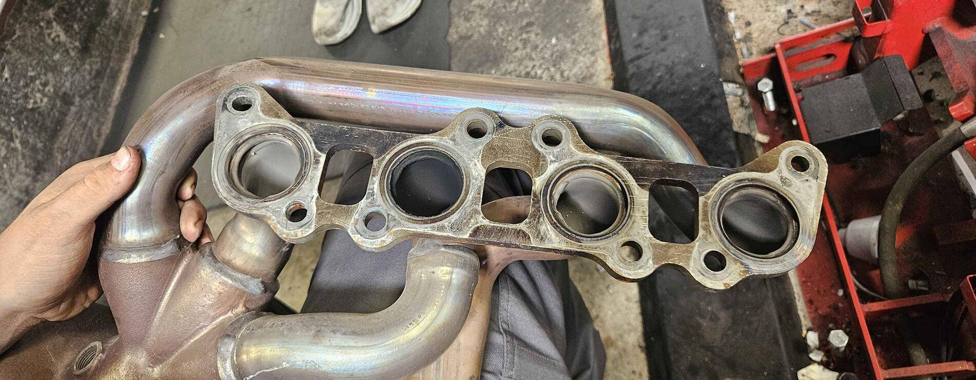

old cat was taken off and cylinder 7 was darker than the rest. turns out one of the exhaust valve stems is leaking oil. tech is saying new cylinder head. cat was also heat damaged. definitely not what i was expecting or hoping for

got pictures of the damage
here's the manifold

and here's the heat damaged cat (sorry its a picture of a phone)
S650 Mustang roket's Dark Horse - "Azureus" Project 1729972256343-lk
