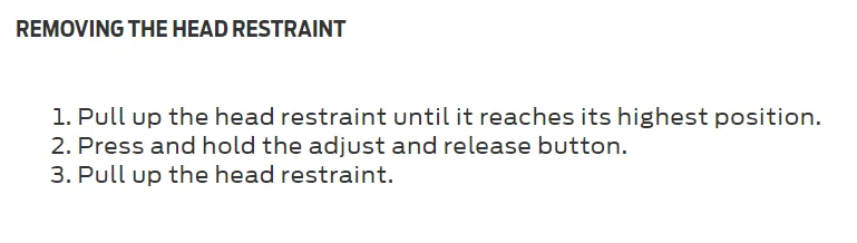

Is there a way to remove the head rests s650. I tried pushing the rails in towards each other,no luck.

On the door side steel prong on top of the chair the square plastic base has a thin rectangular button that you press from the outside in/to the left and may have to be held.

Did not make out. Both head tests are 3 cuts in the bars and will not move up or down. I thought you meant button was on the head rest. You said chair now I know seat. Boy I feel dumb. Give a try tomorrow and tell you. Thanks Again
