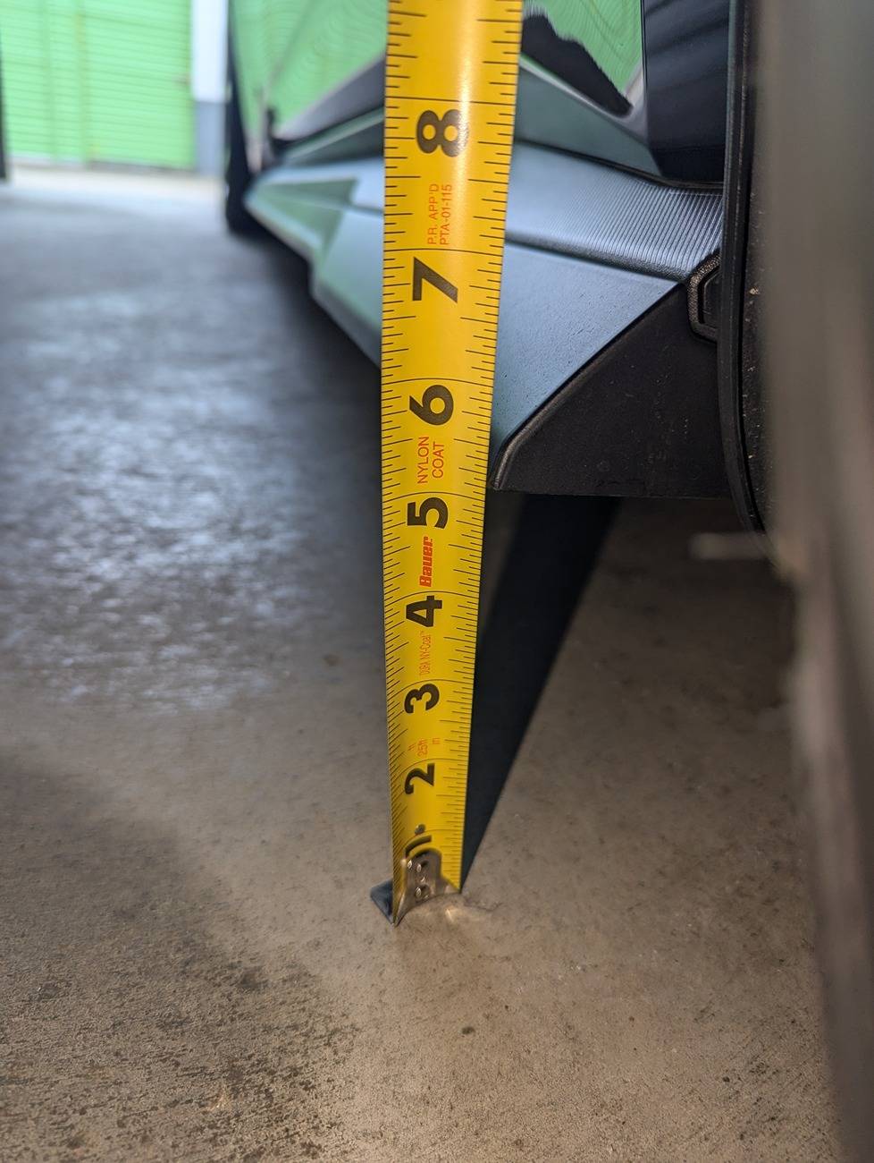

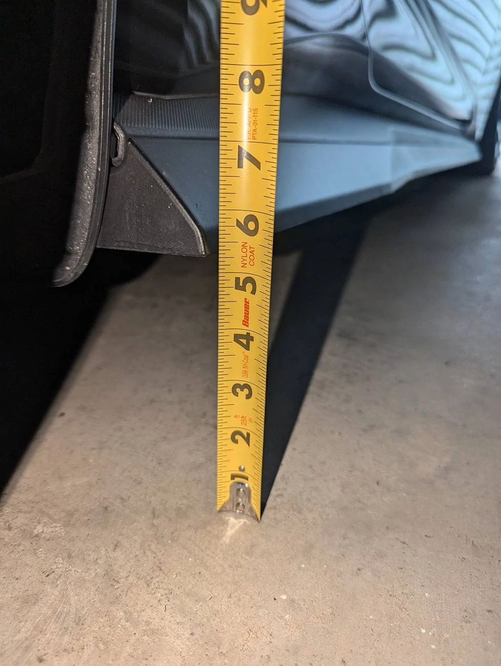

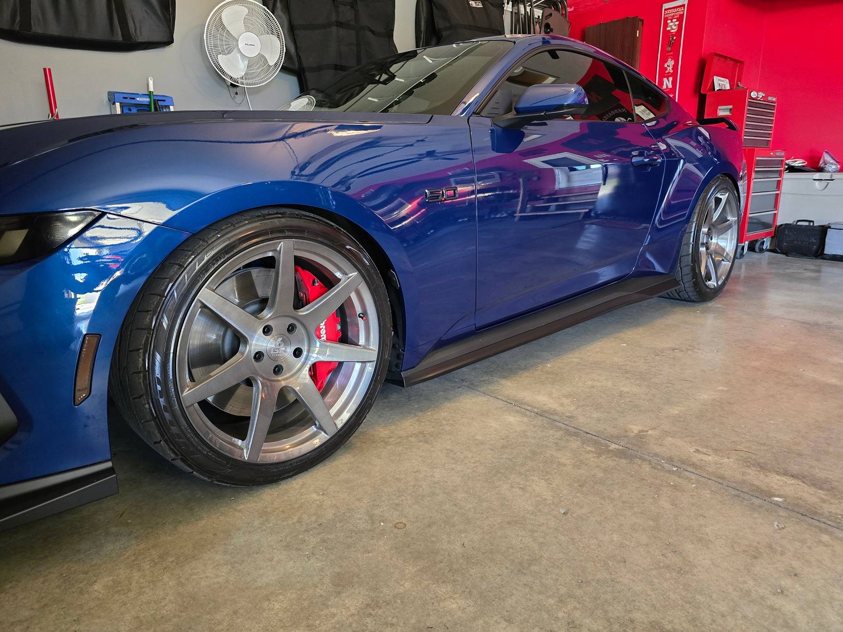

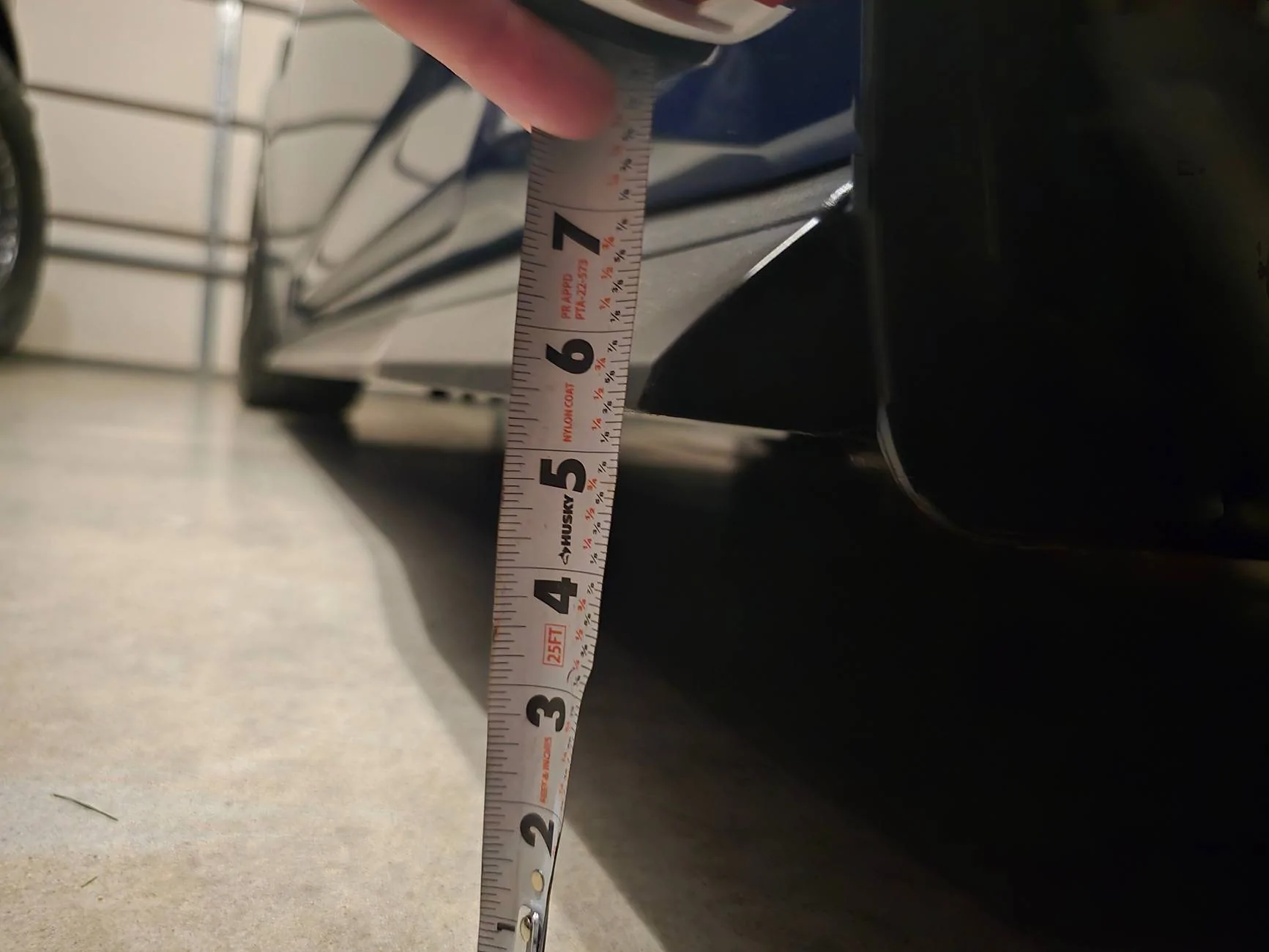

I see that you've got the RTR side splitters installed. What's your ground clearance right in front of your rear tire?
I have the same springs, and stop the hop kit. My clearance is 5 3/8"
Front tires are 275/35R20
Back tires are 305/35R20
I'm on 305/35r19 on the rear

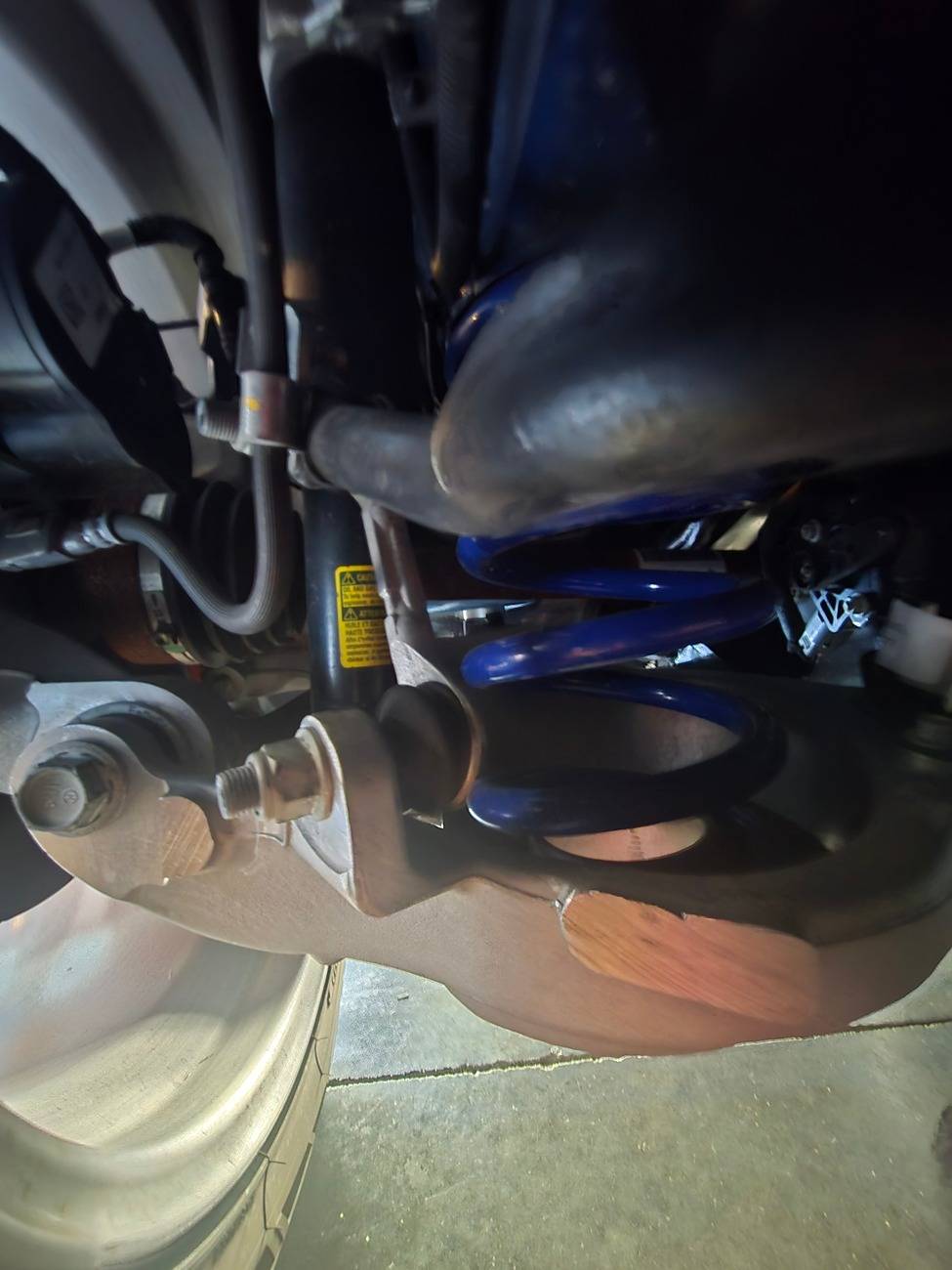

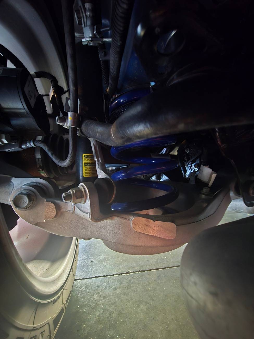

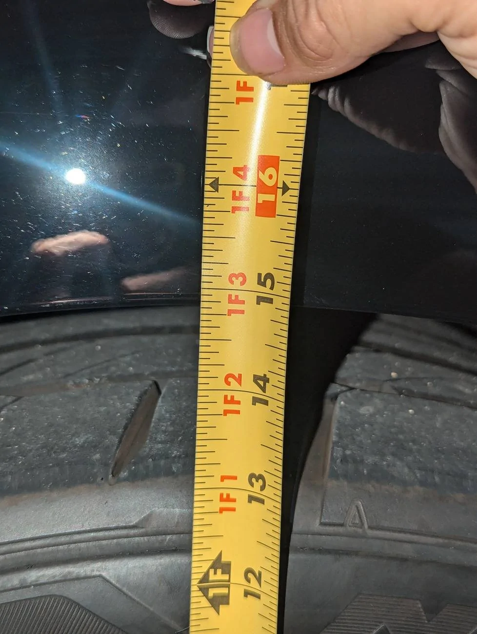

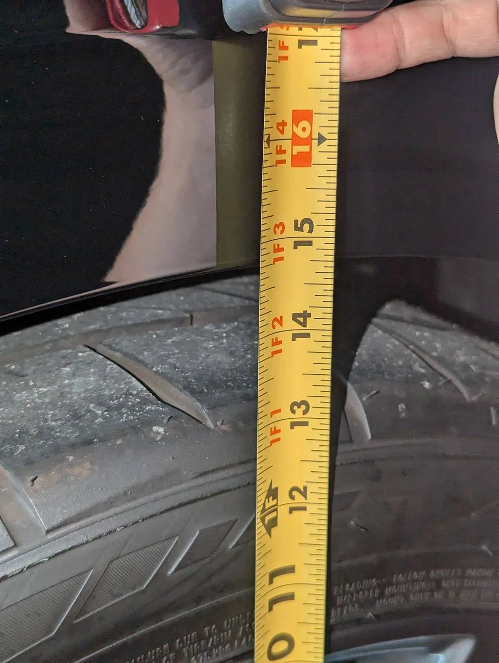

First is the right ride height then the left. I'm on 305/35r19s
S650 Mustang Rear ride height with lowering springs still too high PXL_20240926_203955659
S650 Mustang Rear ride height with lowering springs still too high PXL_20240926_204159344
So weird that we've got the same ground clearance, same tire size and you've got that much gap. I've got nothing for you. I agree, I'd contact steeda and see what they say
My wheels are .2 inches larger in diameter too. So strange

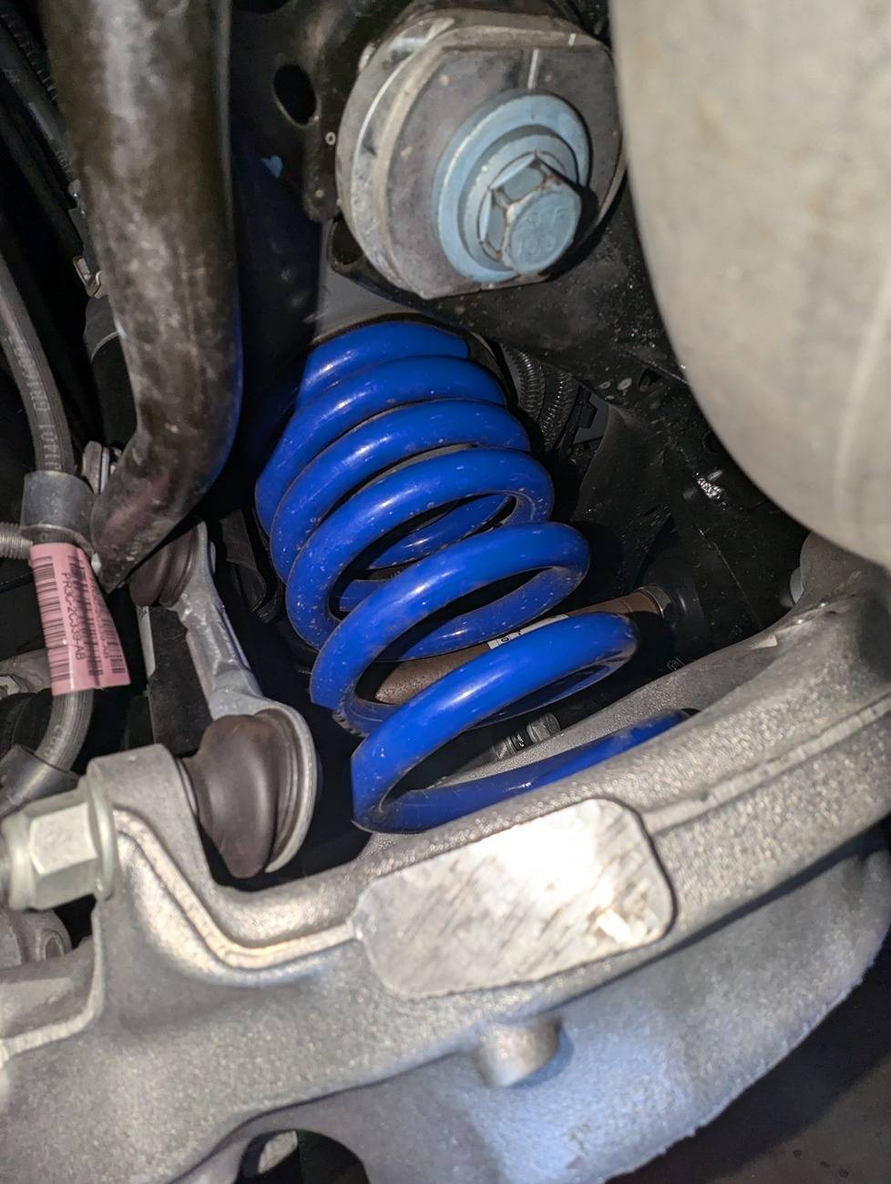

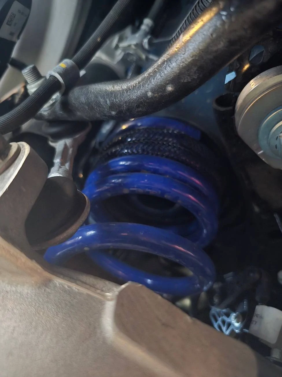

Not the best pics, best I could do.

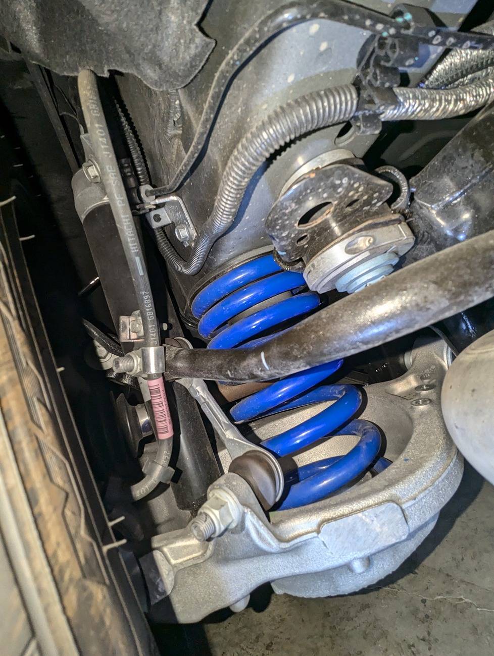

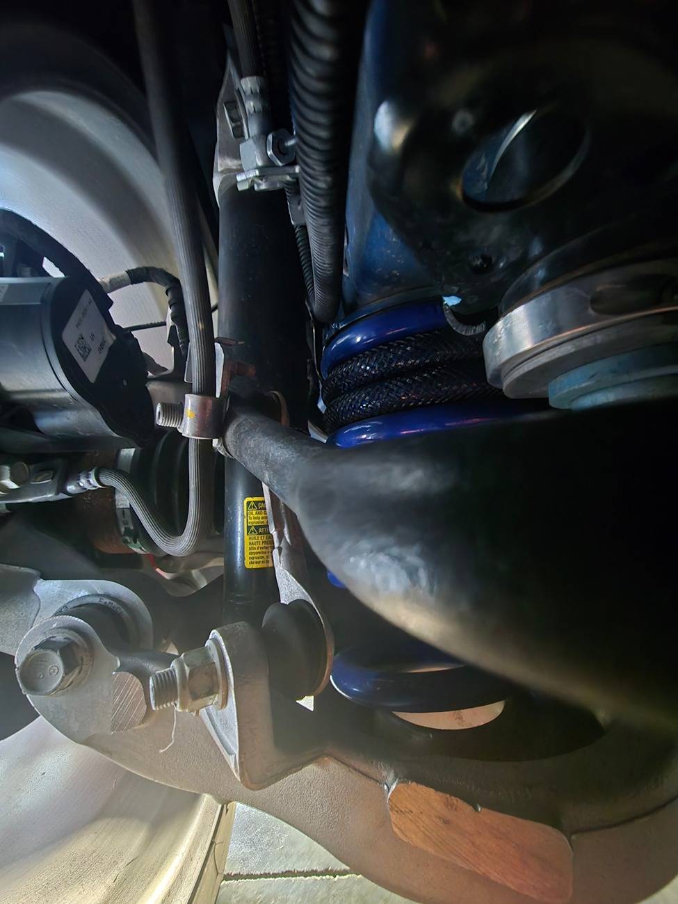

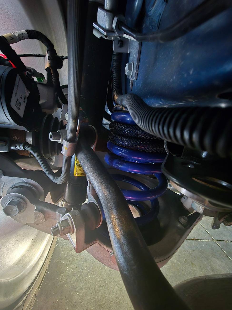

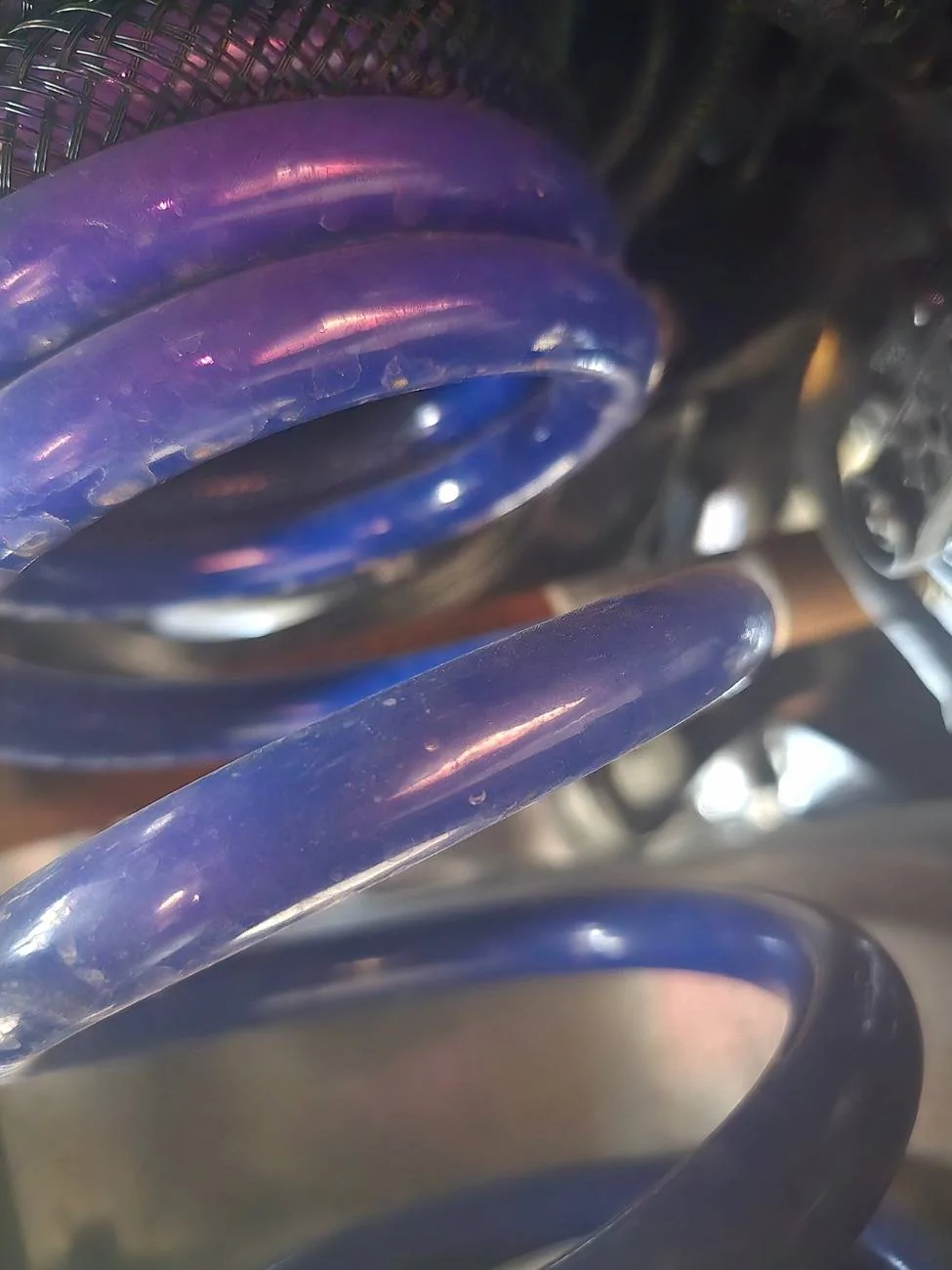

Really dumb question, is there a way they possibly have the springs reversed and the fronts are in back?
Can you try to take a picture from this view when possible. I want to compare mine
S650 Mustang Rear ride height with lowering springs still too high PXL_20240926_210256457
S650 Mustang Rear ride height with lowering springs still too high PXL_20240926_210248991
onaccountof
Mar 25, 2024
133
144
Did you get the correct springs for your car (magna-ride or non magna-ride springs?)
Trillbro
Sep 20, 2024
47
45
Kentucky
2024 mustang GT
I'm in contact with steeda engineers now. But I believe so. The part number they sent me is correct for my car. I have never seen the magnaride springs. Not sure if they look different or if there is a possibility they sent me rear magnaride springs on accident

Unless I missed an obvious typo, you two fella's have an inch difference between your rear wheel sizes. 305/35/19 VS 305/35/20 is an inch difference in overall height and would make a 0.5" difference in the fender gap.
Magic88
Nov 30, 2023
693
841
Bennington
I'm an idiot, my tire is taller because of the 20. My half wit brain was thinking my sidewall would be a half inch shorter because of the rim size difference but still being a 305/35... Duh, 🤣. I need to grab a measurement of floor to bottom of wheel arch for him
