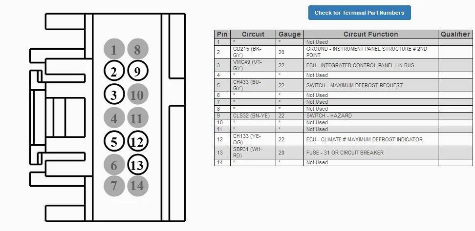

I have a manual GT. As such, there is no auto start/stop on my engine, and the button is blank. Is there a way to repurpose that button to do anything? Ejecto-seato, cuz?
rbeyer
Oct 9, 2024
2024 Mustang GT Base
I have a manual GT and it has auto start/stop with the button there...
2,681
4,068
i've been wondering the same thing, i hate that blank button. it seems like you would need to hack open the little panel there and go from there, because it looks like the only 2 direct buttons on it are the hazards and max defrost
