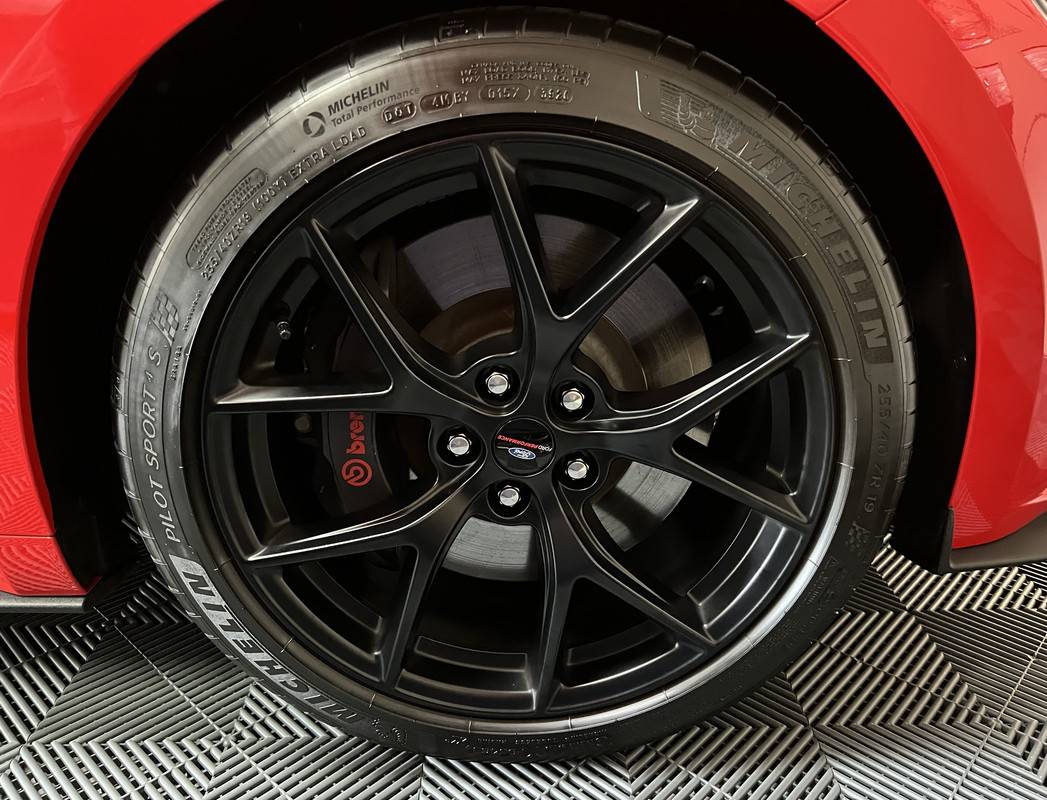

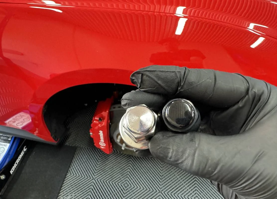

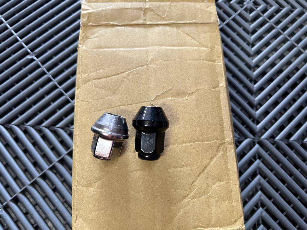

As others have stated, all Mustang's for Australia have the chrome jacket lug nuts.
S650 Mustang Question for owners of cars with the Nite Pony pack or the black pack? IMG_2473
S650 Mustang Question for owners of cars with the Nite Pony pack or the black pack? IMG_2514

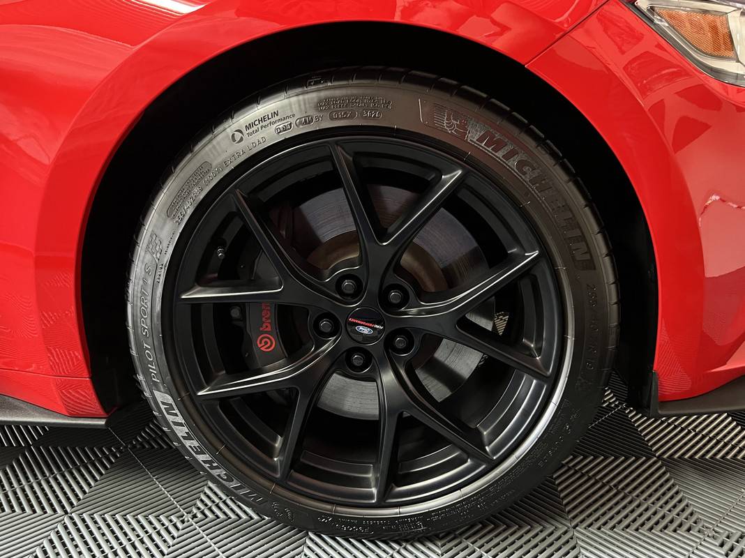

I swapped out the two-piece chrome jacket OE nuts for black solid metal lugs.
Just a word of caution when selecting replacement lug nuts for these cars. I'm usually an OEM parts type of guy, but this is one instance where you would be better served with aftermarket parts.
The OEM nuts are a two-piece design that consist of a nut with a pressed jacket over the top. This applies to the chrome factory-fit items, as well as the black Ford Performance items mentioned above.
M14 X 1.5 BLACK LUG NUT VEHICLE KIT OF 20| Part Details for M-1012K-MB | Ford Performance Parts
Ford Performance Black Wheel Lug Nuts Kit Of 20 - Autoware
M14 X 1.5 BLACK LUG NUT VEHICLE KIT - Herrod Performance
These jacketed nuts are know to rust from the inside and swell, which causes the jacket to spin on the nut and prevent the wheel from being removed. It's a stupid and unnecessary design.

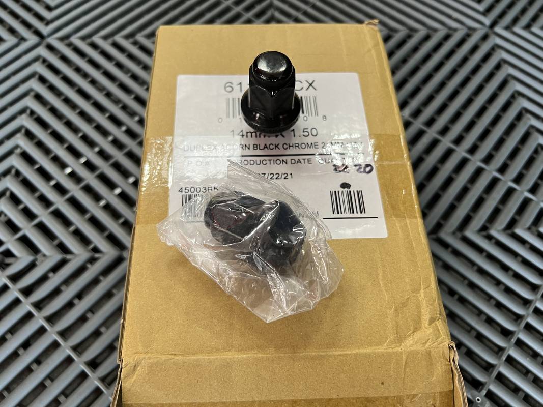

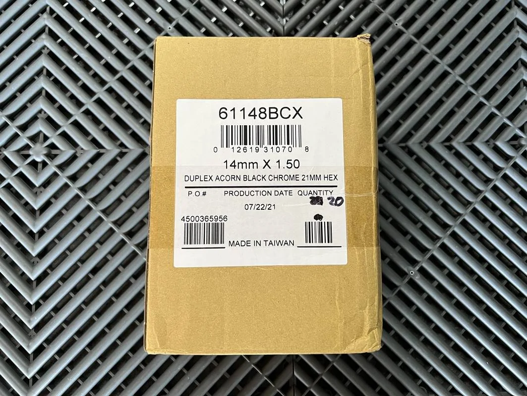

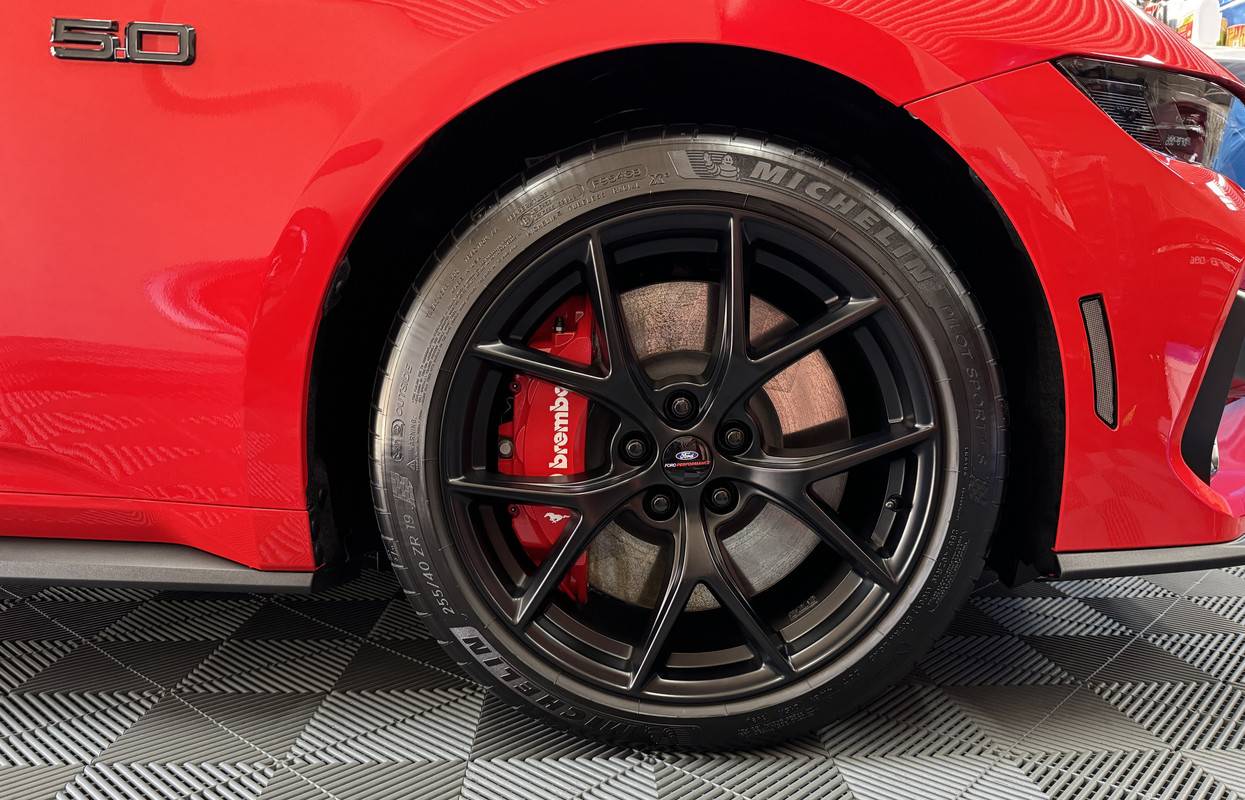

If you are sticking with OEM wheels, look into McGard or Gorilla lugs. The ones below are what I have. S550 and S650 use the same lugs.

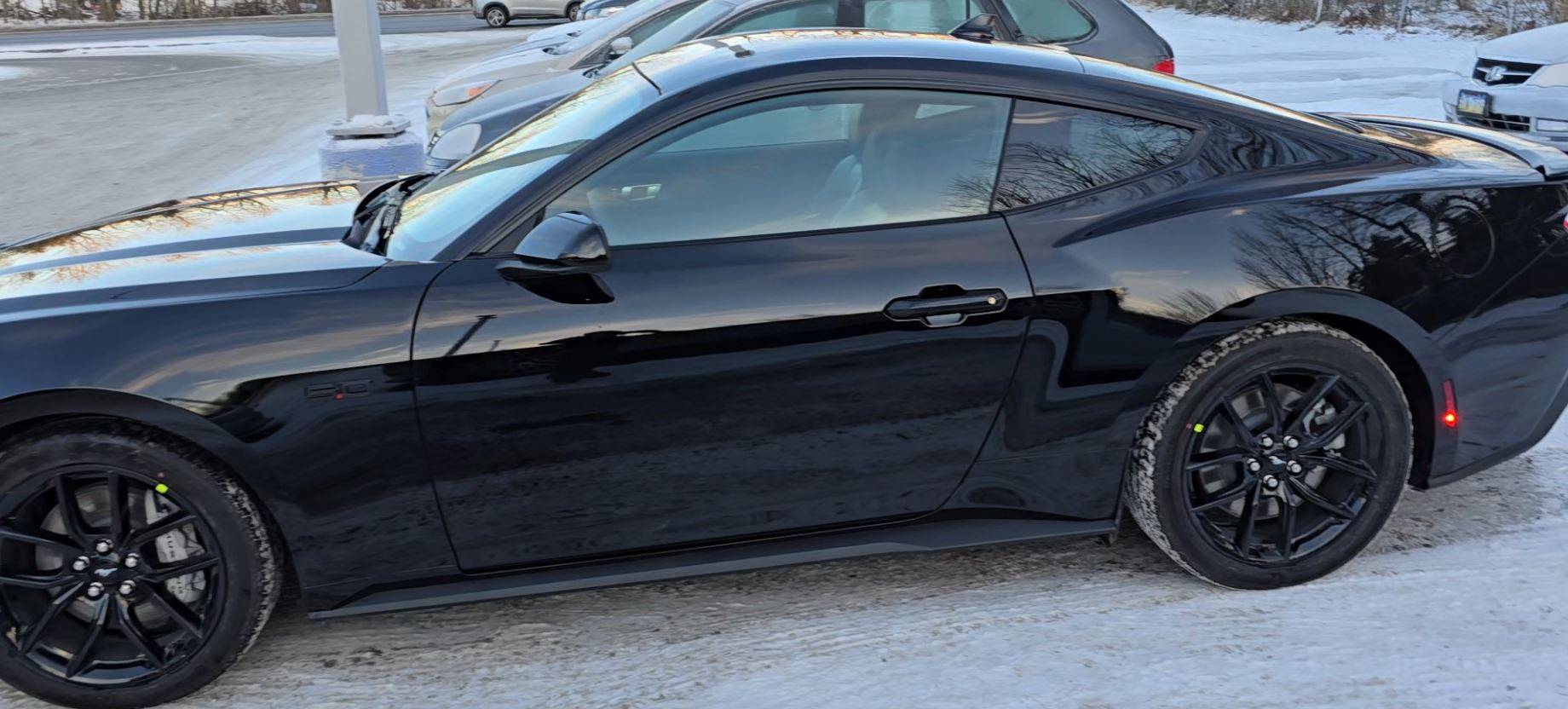

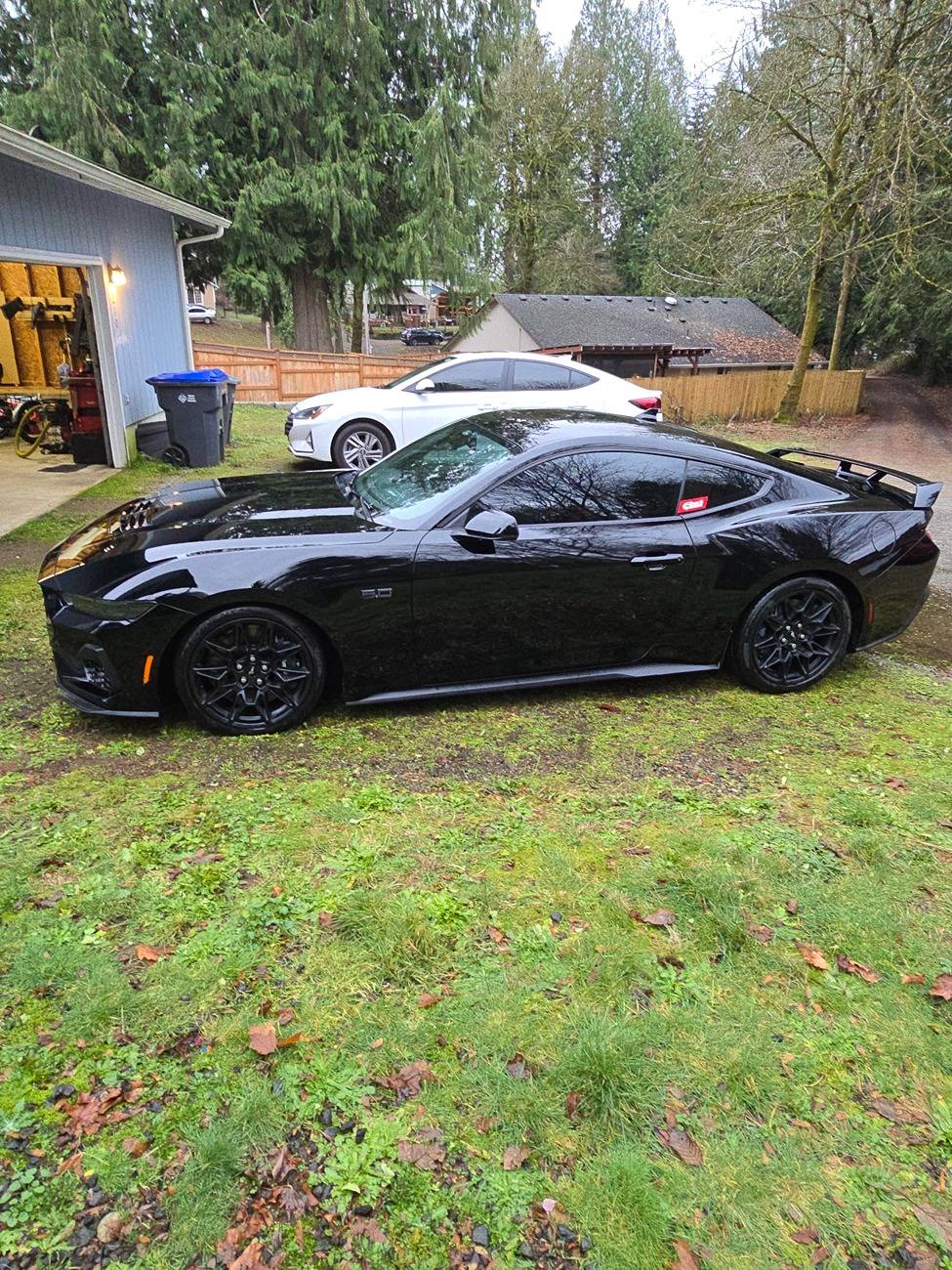

IDK, I don't mind the OEM lug nuts. I have the black gorillas and I like them, too. Matter of if you want to brake up the black a bit and with the OEM wheels...
