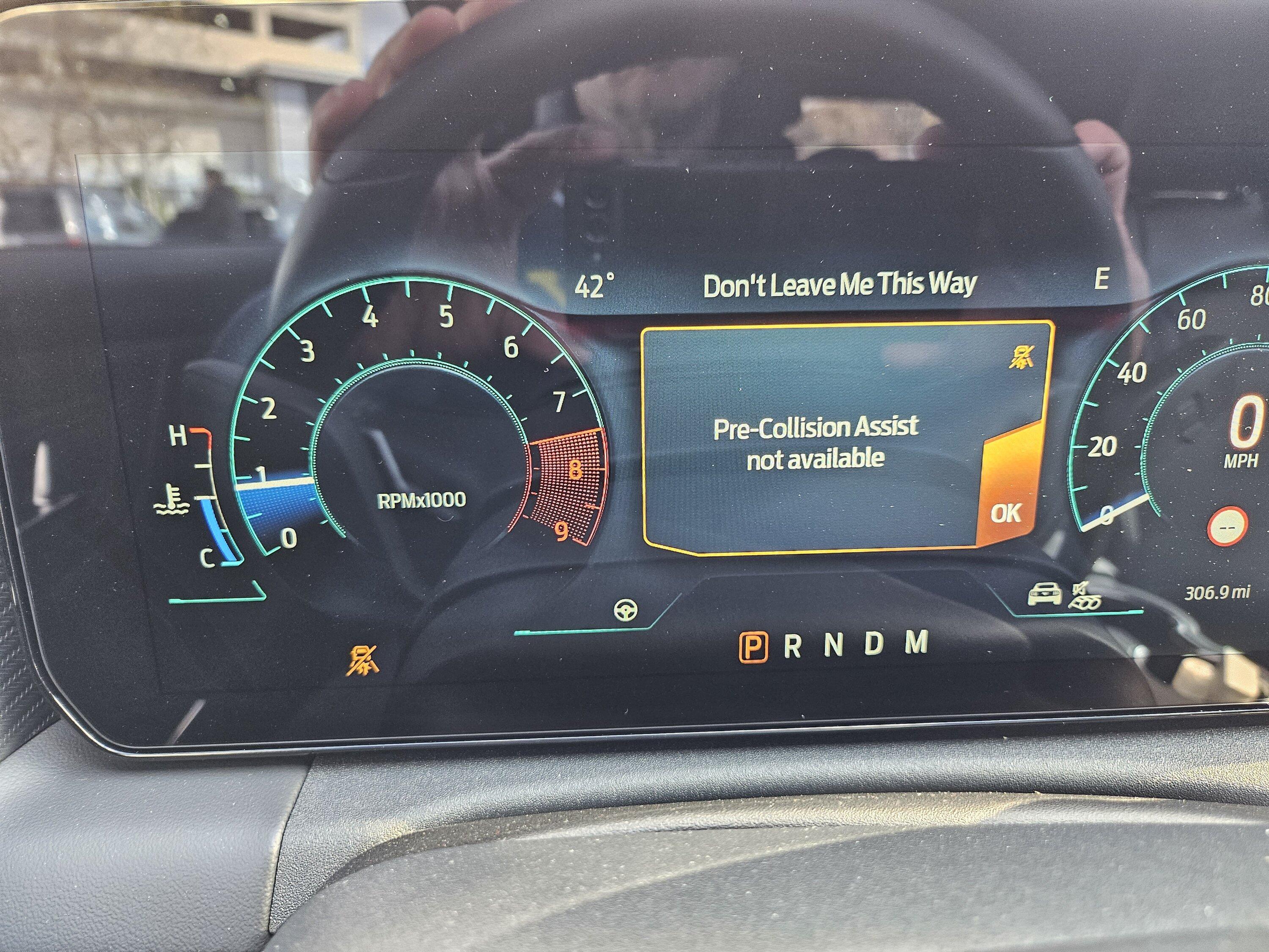

Hi all,
It happened to me a few days ago. Was parked at a shopping parking lot, (the car in front was very close), started the car from inside as always, and a string of messages started appearing on the dashboard, repeating when i clicked ok.
I drove for a few meters, stopped, turn off and started again. No sign of the issues, the car started correctly...
I've had the car for only 2 weeks, hoping it was just the proximity to the car in front that was blocking something and the sensors went crazy....
Adding @Ford Motor Company, any comments?

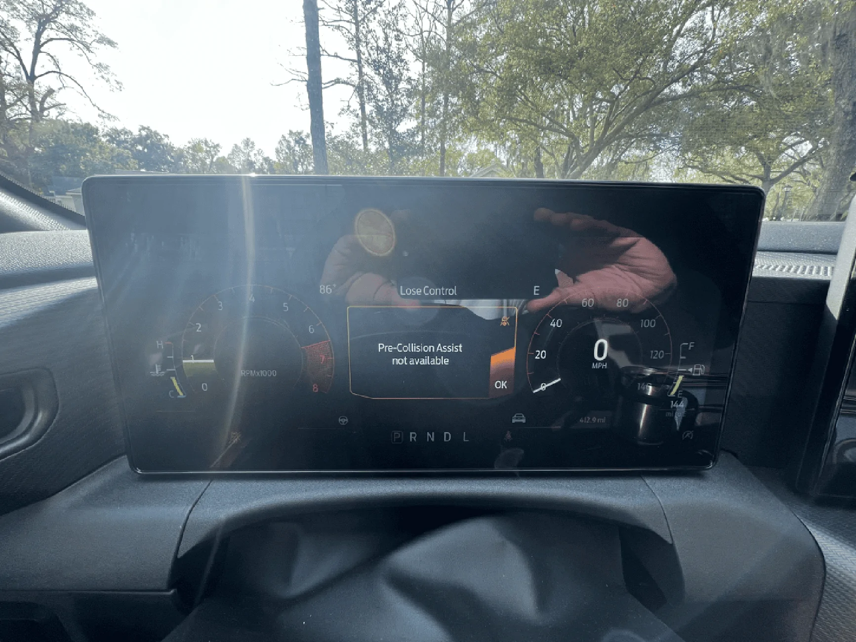

I just read this thread and, curiously, something similar happened this morning. I remote started, yes, but my car was pointed towards the street, not the garage. The pre-collision alert light flashed, then a message popped up saying the camera view was distorted. I had just used the windshield washer/wiper, so I figured it may have been a drop of water on the lens. It eventually went away, but I did check prior and there was nothing on the windshield.
It also comes on when someone rudely cuts in front of me. This is a glaring flaw in the sysm, an update is needed so the little light will go annoy the offender, not me.

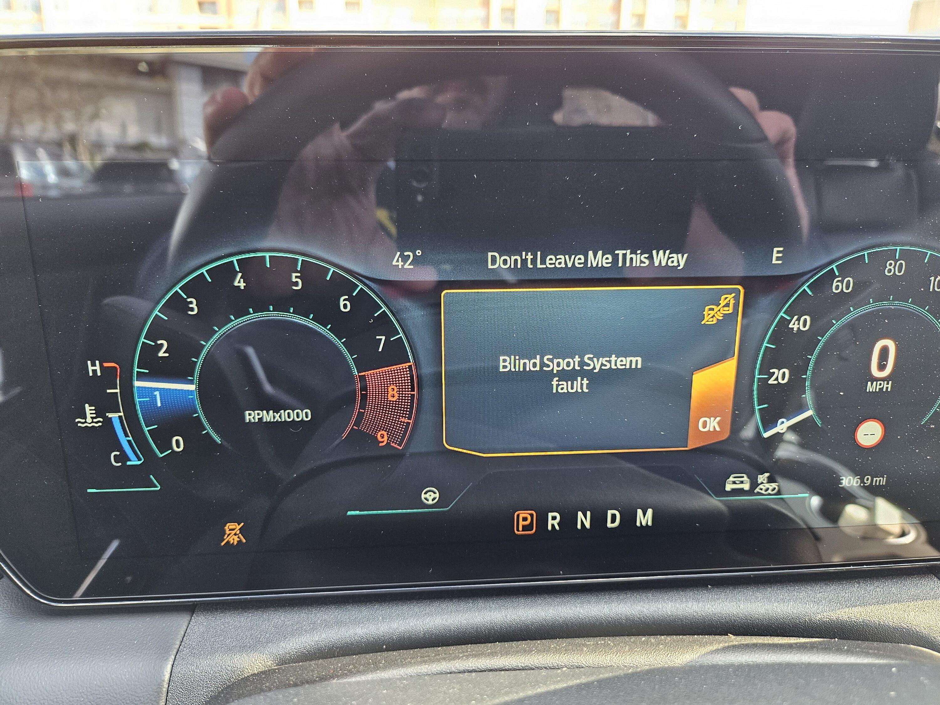

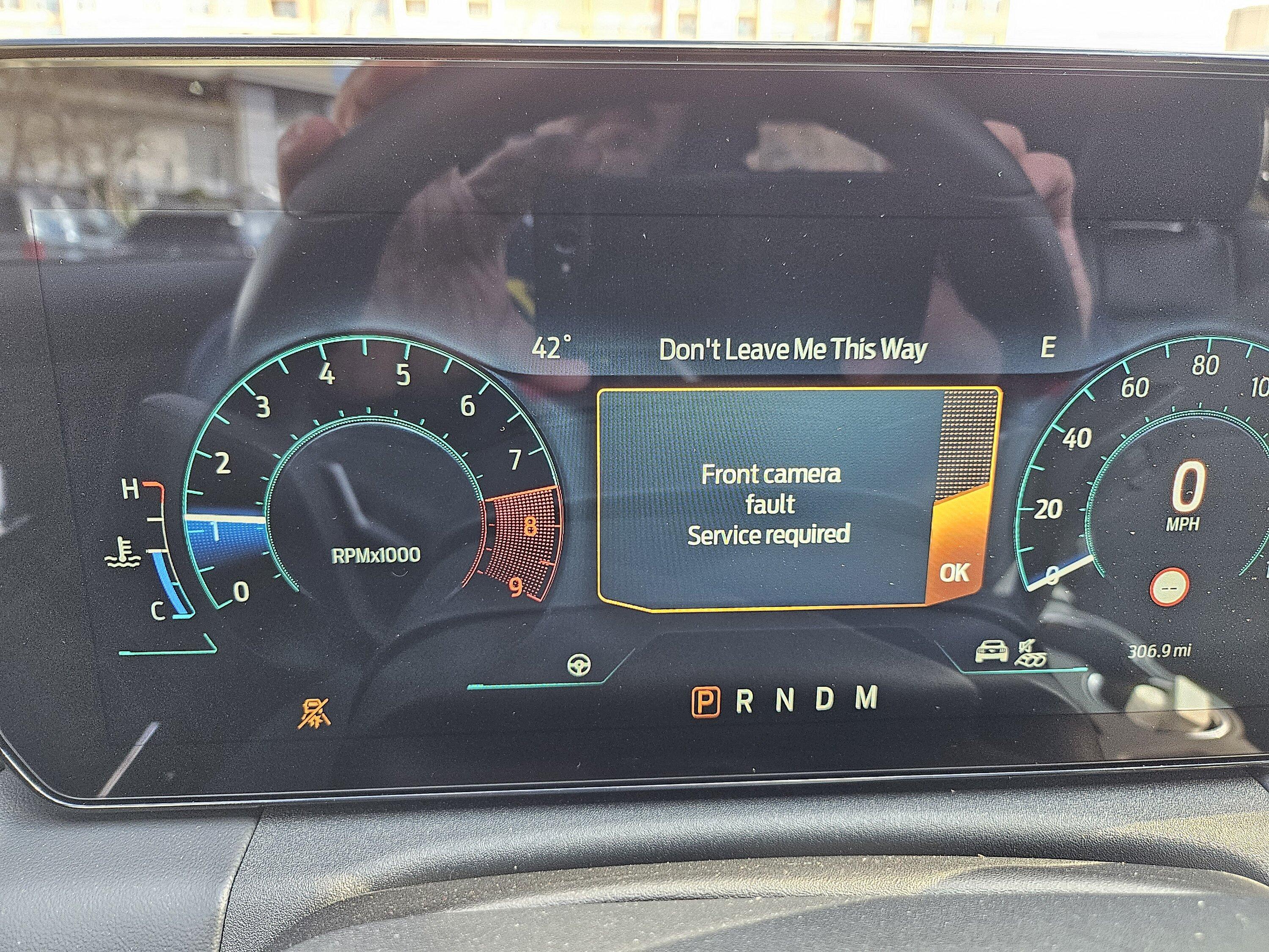

Today, I got the same Errors again. A car stopped close in front, and the RED Pre-collision blinking warning light up...right after that, the errors in orange started to pop up, one after the other , while I was driving:
"Front Camera Fault Service required"
"Pre-Collision Assist not available"
"Blind Spot system fault"
I cleared them, and everything was working again, like nothing happened.
Visibility was fine, there was no reason for the sensors being blocked....
I'm already at 1200miles, I'm going to leave the car at the dealer for an Oil Change and to check the Pre Collision system , as something is not right...
