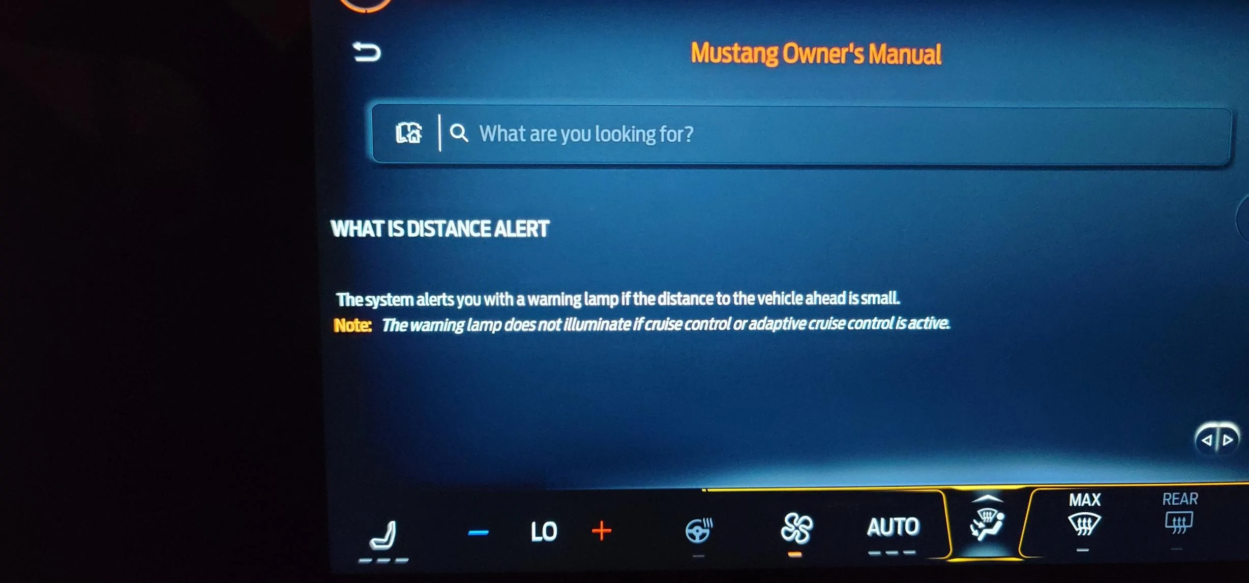

is the light in the lower left of the IP in yellow?
Mine randomly came on today while on the interstate. No noise or alert, just a steady light.
i read the manual and found out that is a feature called "distance alert"
S650 Mustang Pre-Collision Assist Not Available Warning 1694577281297
until i read that, i thought it was an issue of some kind
