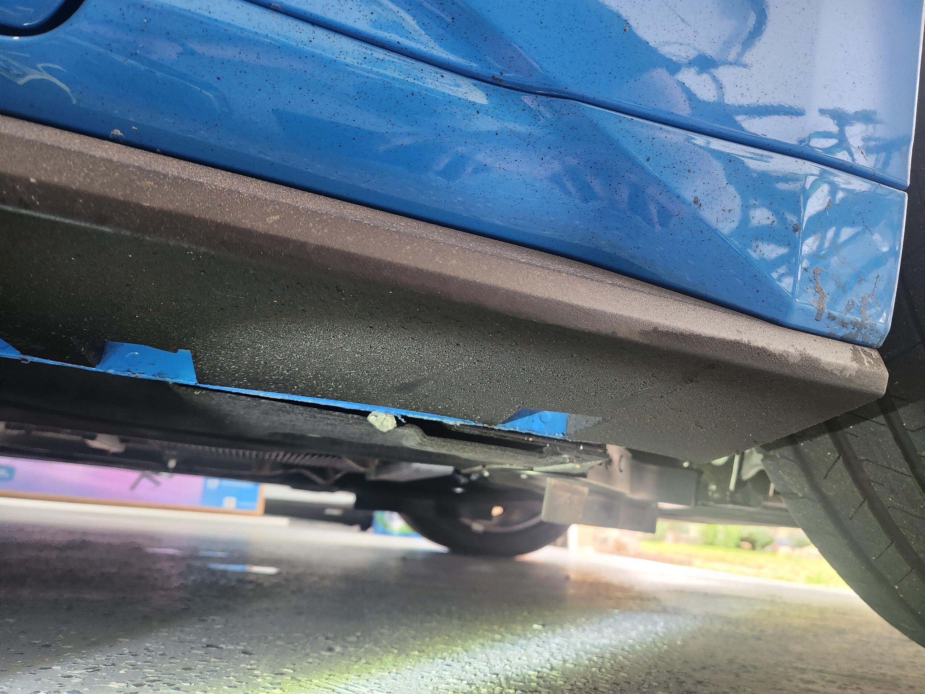

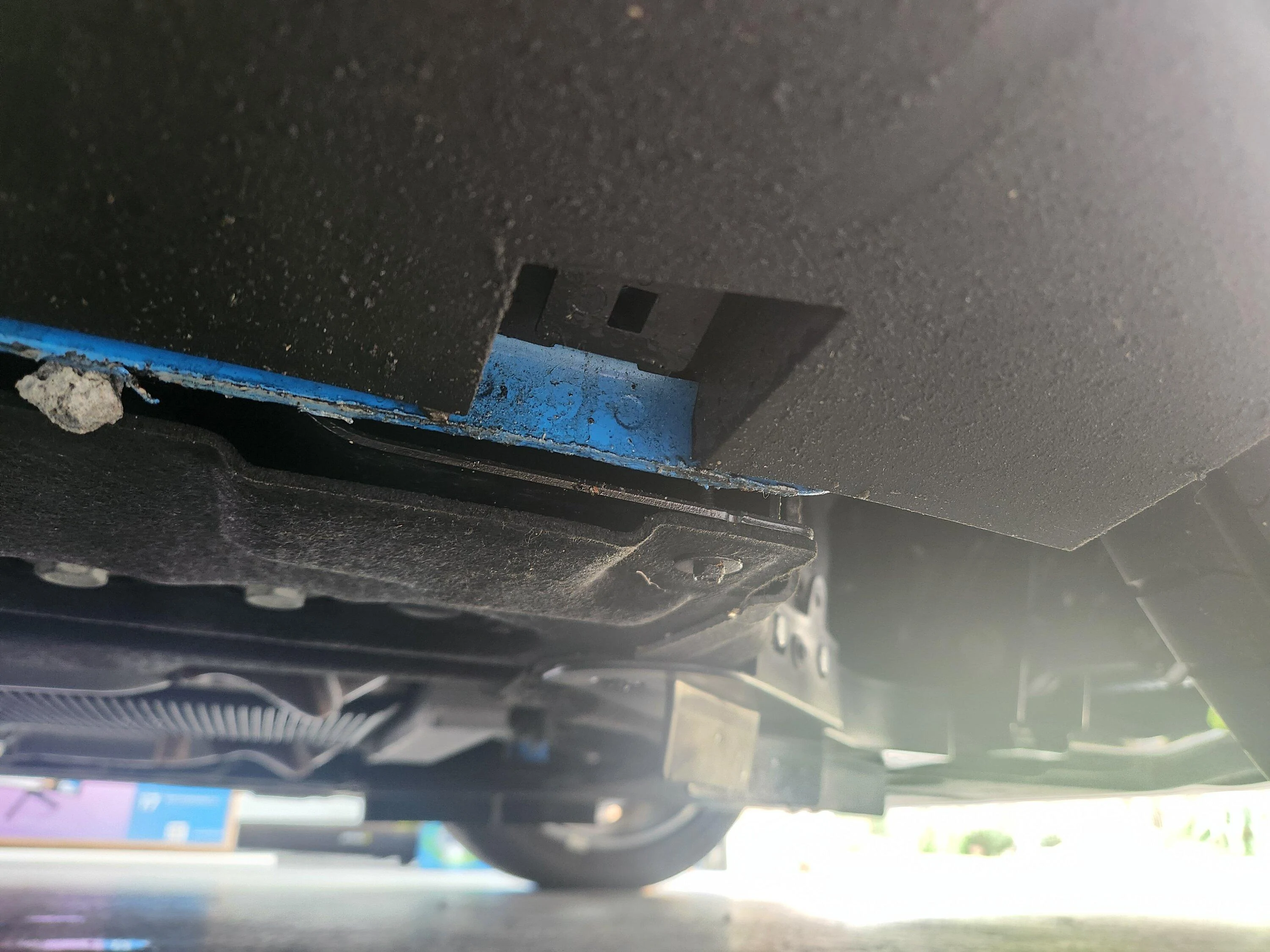

After passing 1k miles i saw oil at the bottom passenger side skirt. Some was splashed quarter panel.
Anyone else have this problem?
After cool down i will check oil level. Its a GT prem. conv. with GT package.

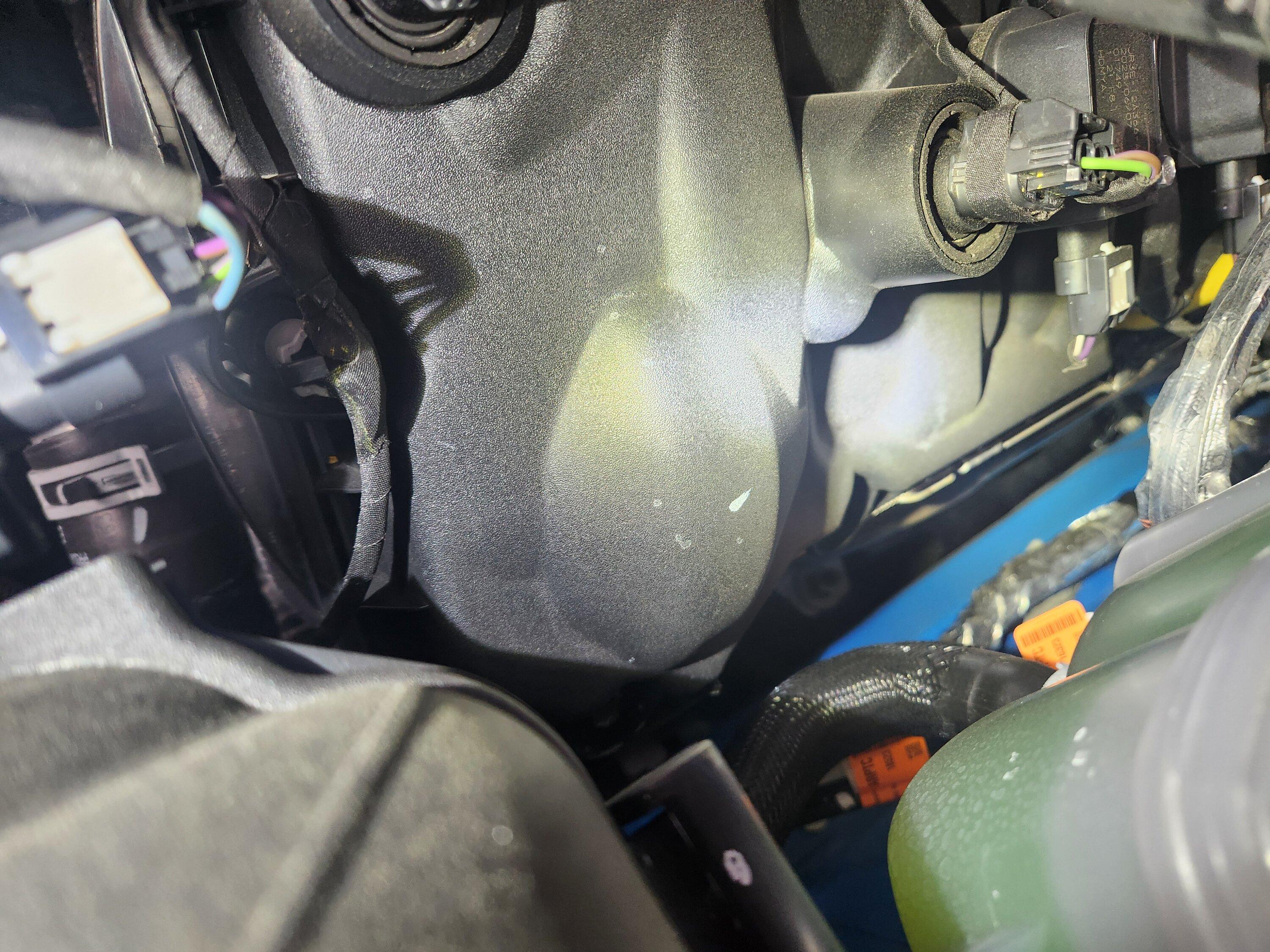

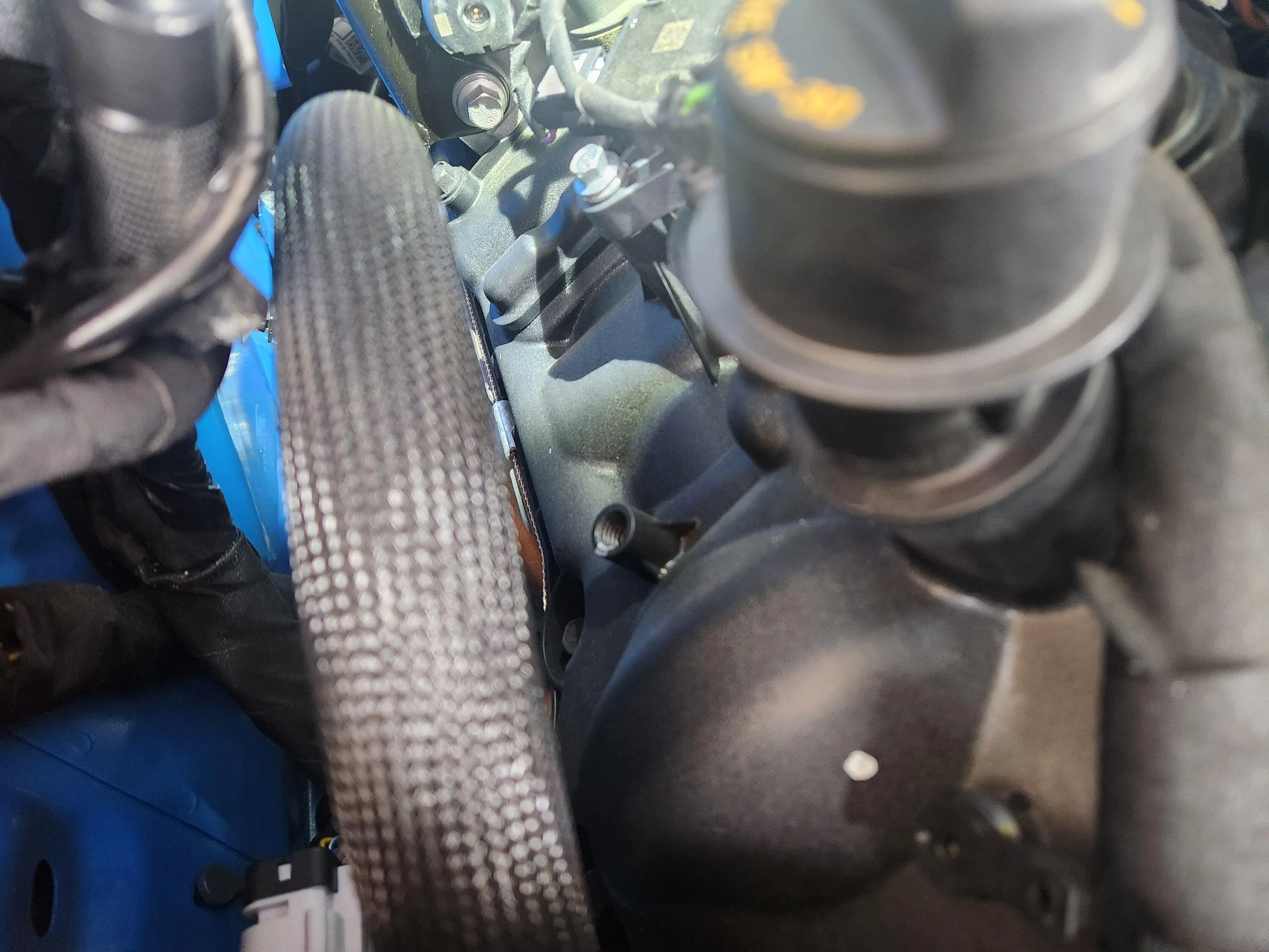

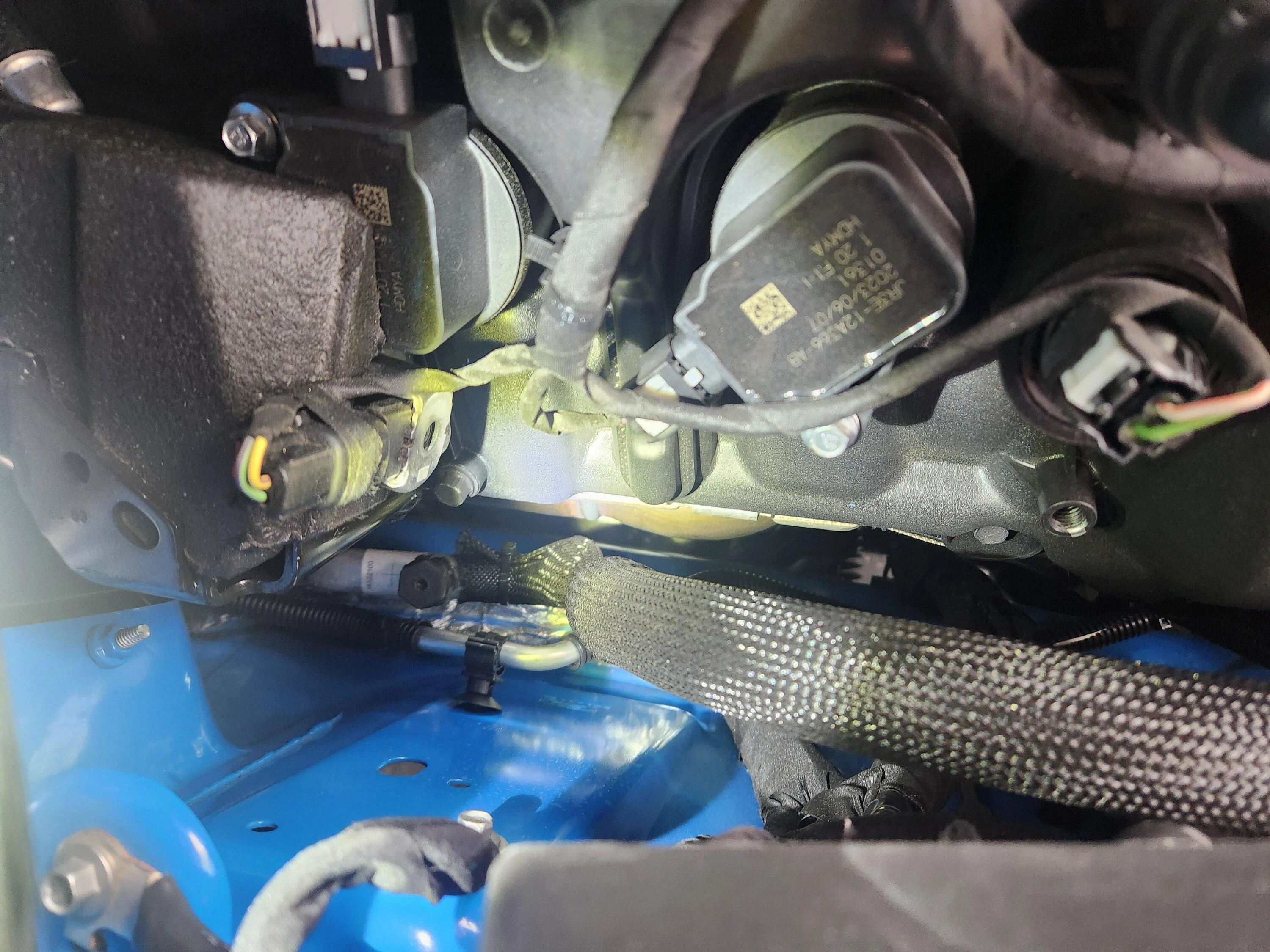

Can you post a picture or two?
wanted00
Mar 3, 2024
Houston
Mutang GT Prem
Engine seems clean. But i can only check from top.

Yea, things are a tight fit all-around.
The oil filter is on the opposite side of the engine; that gives us confidence it is not loose.
A leak from the oil pan or drain plug would be more in-line with the center of the car.
If at all possible jack the car up, support with jack stand and peer in further. The belly pan might not allow for much more visibility. An initial check could give some more insight. Otherwise, leave as-is and return to dealer for warranty action.

Today I got a call and they said everything is okay. No oil leak. I hope they check every fluid leak :)
Their guess is it come from road. But it's hard to not feel or slide when passing trough oil and nothing inner wheel well
