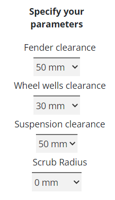

Agreed, and the solutions that have been tried/posted seem to be very much trial and error, even from the sponsors. When you are possibly looking at doing something custom or semi-custom, trial and error comes with a lot of risks, risks that I am trying to minimize or avoid.
The third link you provided is the closest that I have seen to addressing fitment clearances, so thank you for providing that. Looking at the some of the parameters do we know what these are for a stock S650 suspension?...
S650 Mustang Official Wheel Clearances? 1707782939221
If we can figure this out or get very close to it I think we'll have what I am looking for.
I haven't seen anything that gets into such detail. Several companies are offering recommendations for their products, but they do not list related measurements.
Many have their car at home now. This thread is being seen. Maybe someone in a like situation could take a few readings and post.
