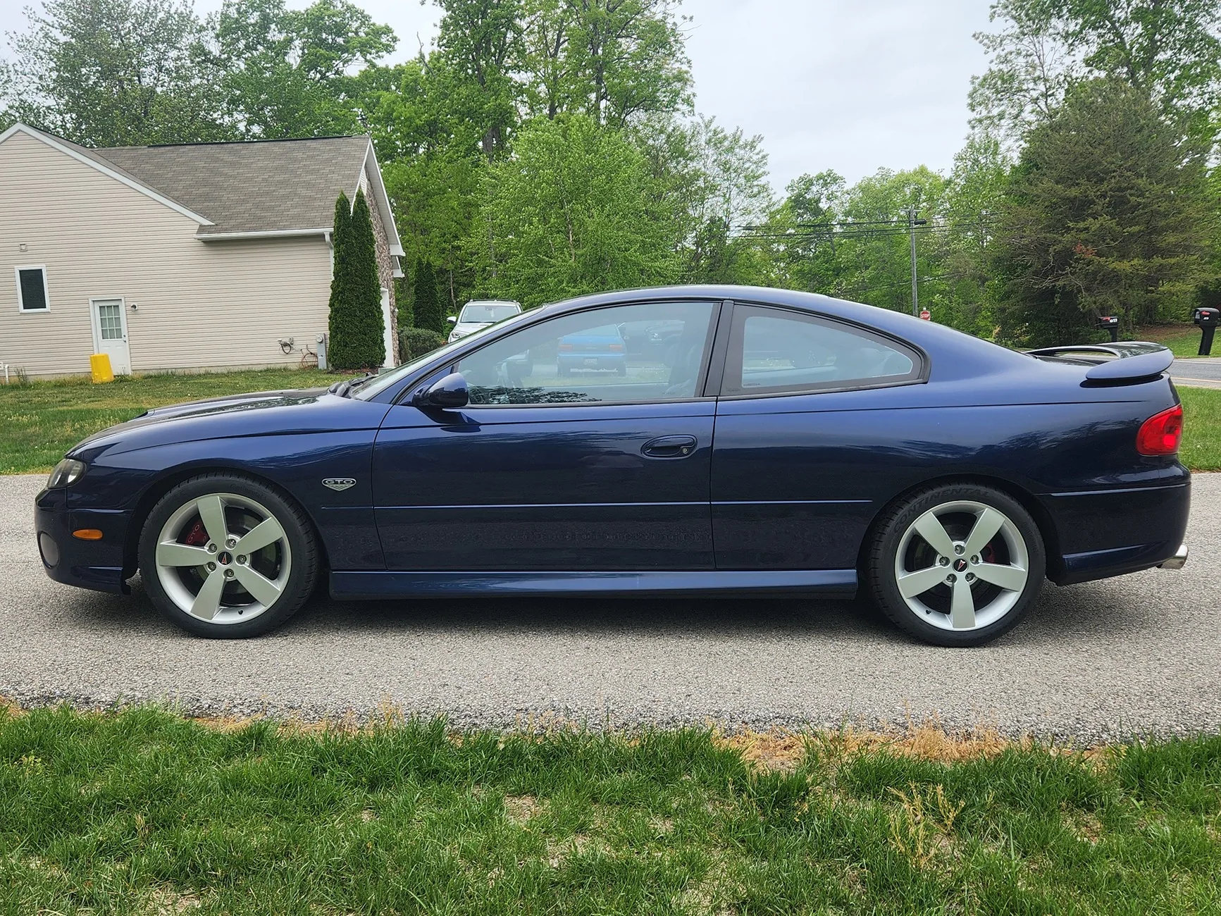

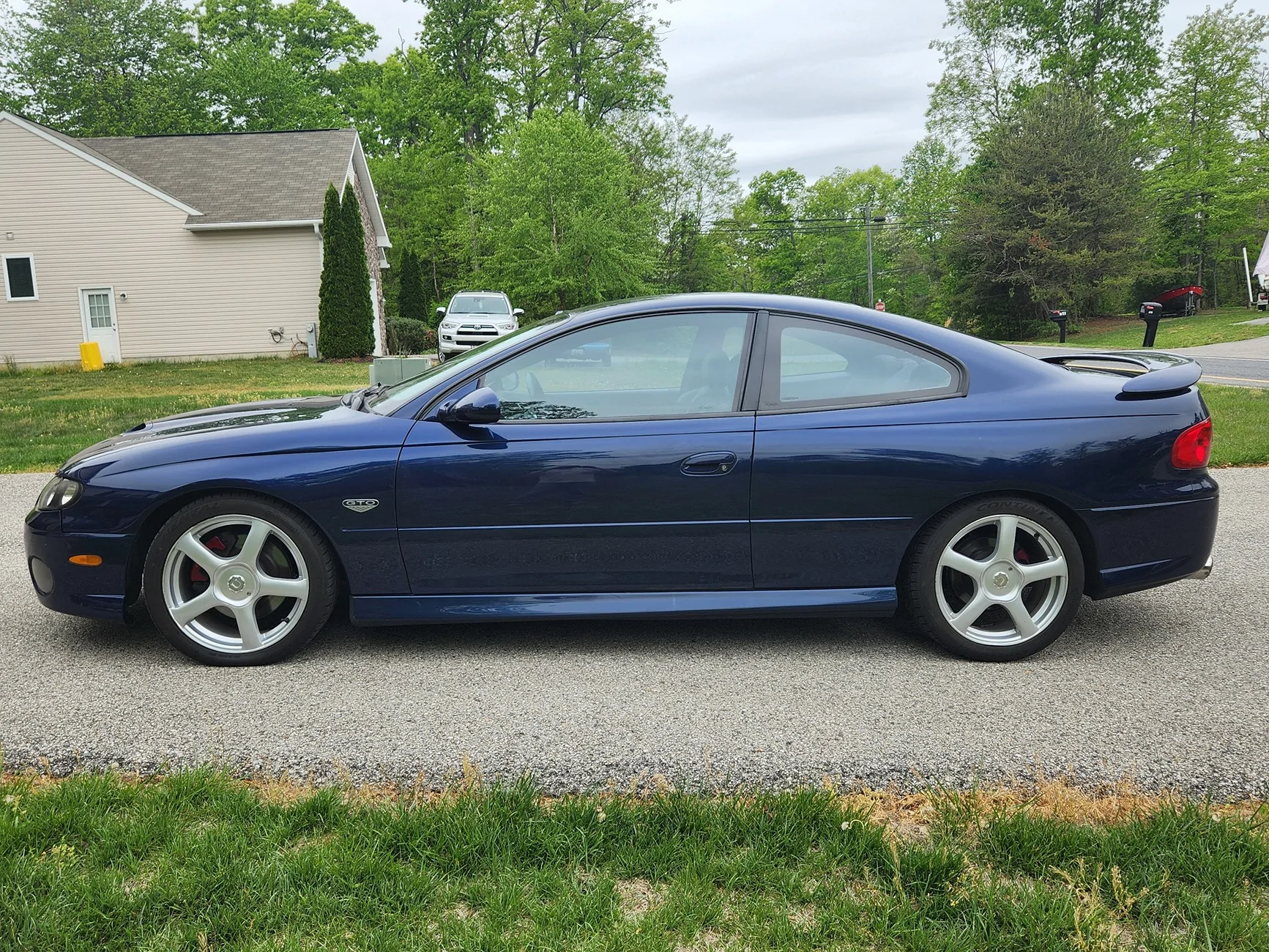

So, I've gone from aftermarket 18X8" wheels with 245/40 tires to 18X9" GTO wheels with 275/35 tires. I've checked tire clearance with the steering full lock left to right and it's good.
Old wheels that were on the car when I bought it.

New wider wheels/tires

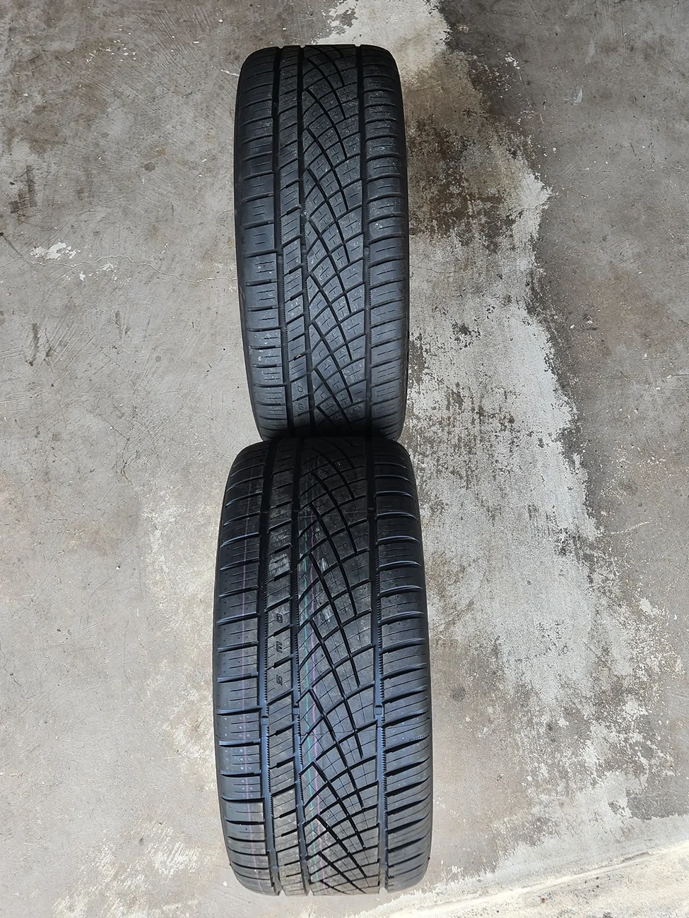

Old tires top, new tires bottom
