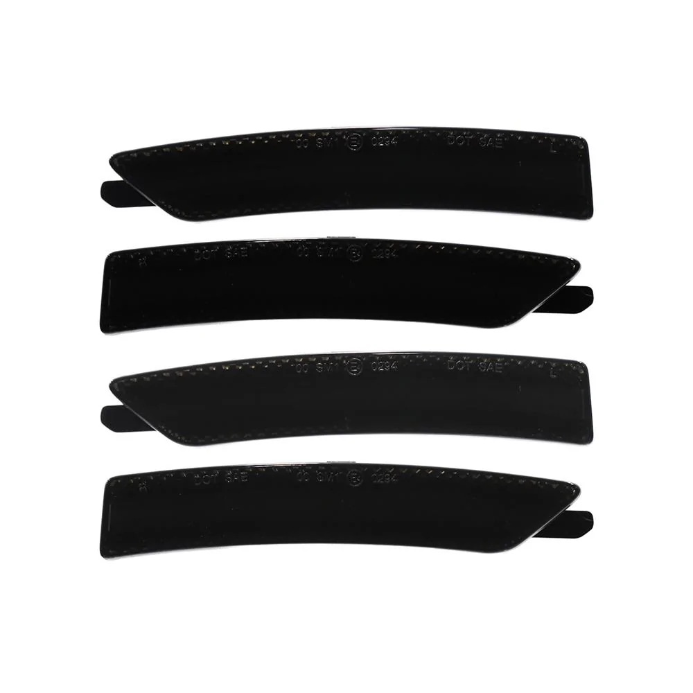

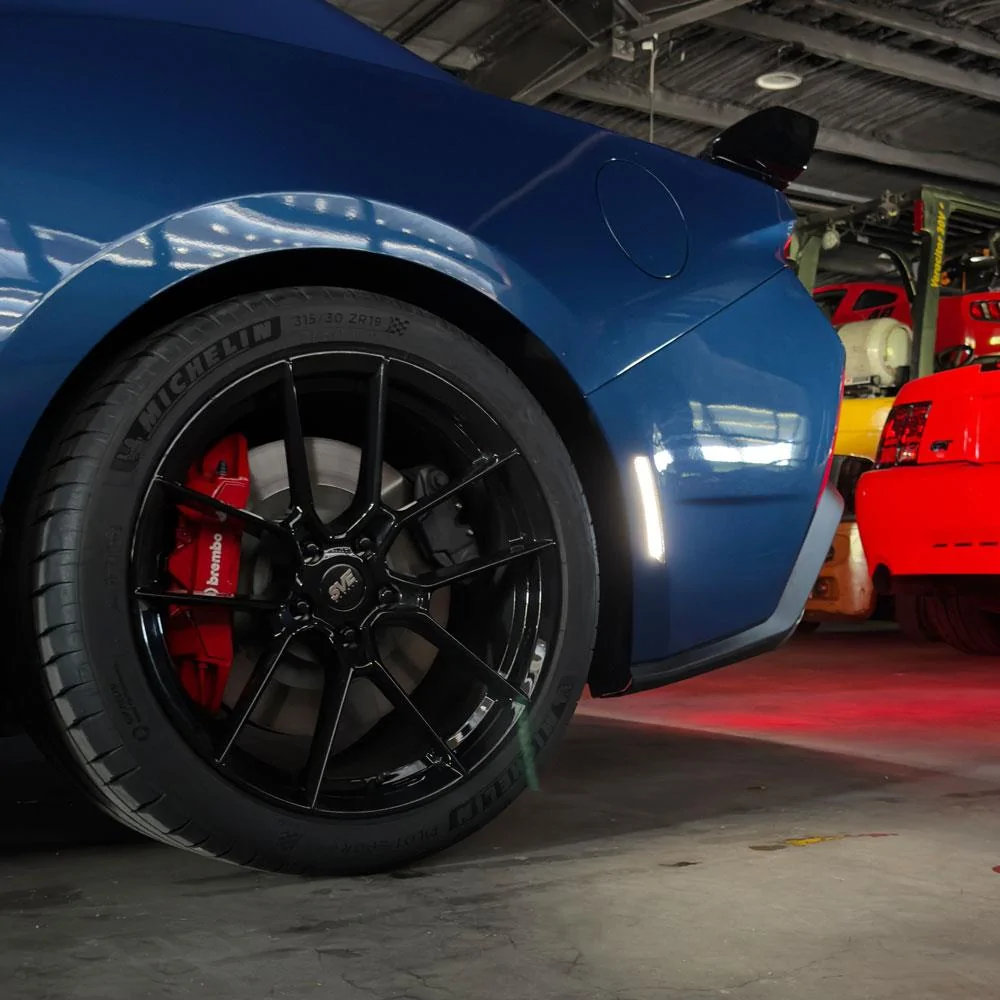

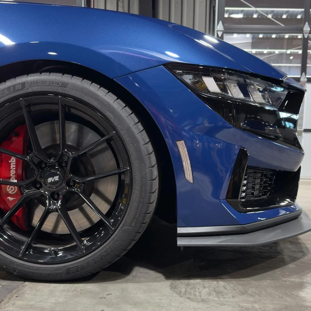

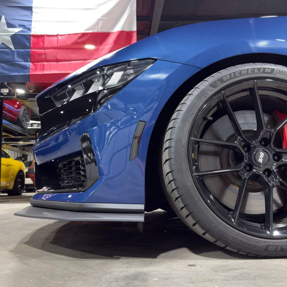

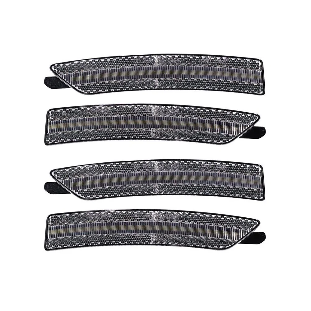

We just added new LED side market kits to upgrade and customize your S650 Mustang
Given the conversation generated by the different approaches to the install (apparently based on year and model of the S650), what is your experience with the 26 DH? Are you just popping out the rears w/a pry tool? Did you have to contend with a mounting screw for the front markers?
